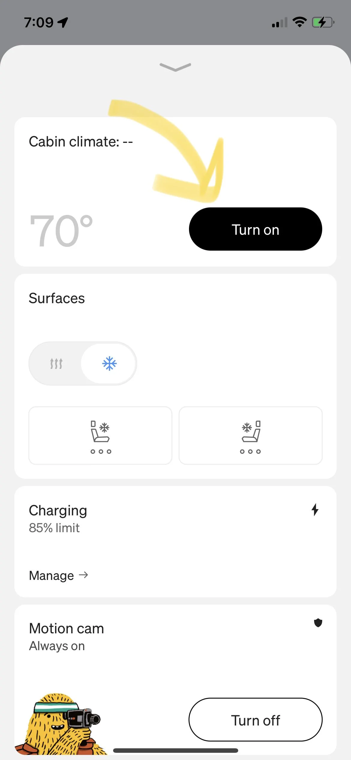

Climate control in Rivian App is grayed out?

I was experiencing the same issue, grayed out “turn on” button. Here is what I did to solve the issue. Note: on iPhone
1. soft reset Rivian (holding far left and far right steering wheel buttons)
2. Logout of phone app
3. Delete app (including app data)
4. Turn phone off and back on
5. Download Rivian app
6. Login to Rivian app
7. Reset up phone as a key
After those steps I can now control climate from the app.
