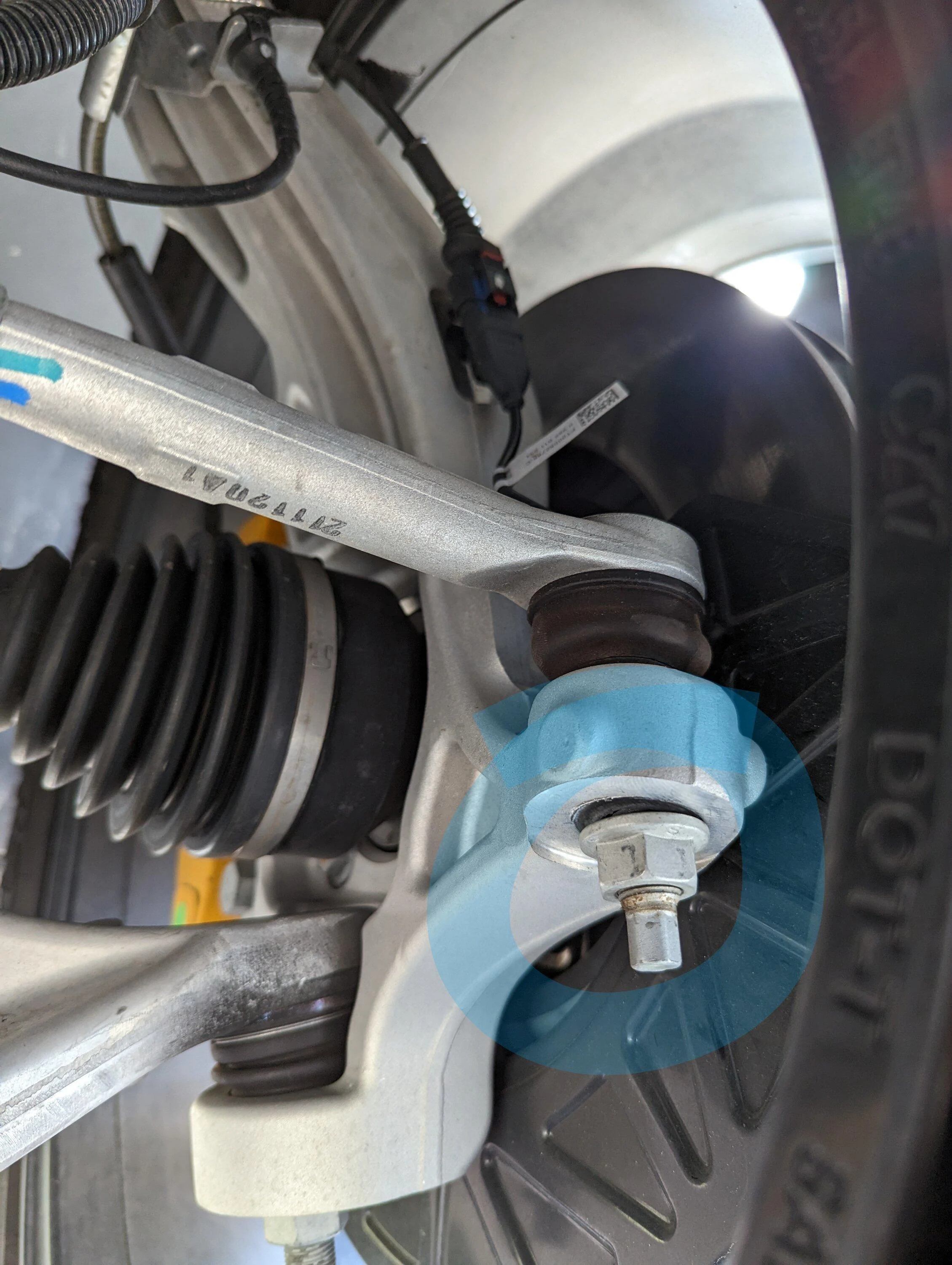

My truck is going to get tow for Service tomorrow because the nut come loose where I can unscrew with my finger. The loose nut cause my front wheel to wobble and shake the whole truck. I screw it back tight but don't know what the amount of torque. I requested them to check all the nuts to make sure all tightly torque.
