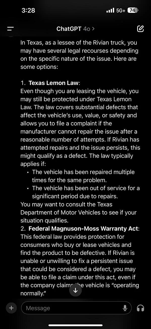

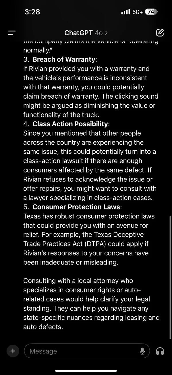

Here’s what I’m seeing from ChatGPT. If Rivian refuses to fix my truck this next time again, I’ll give them one more time (3 times total) at which point I’ve opened up the lemon law here in Texas or some federal laws. We can also all join up and file a class action lawsuit. Hate to do that to Rivian but we didn’t pay $35k for our trucks.
