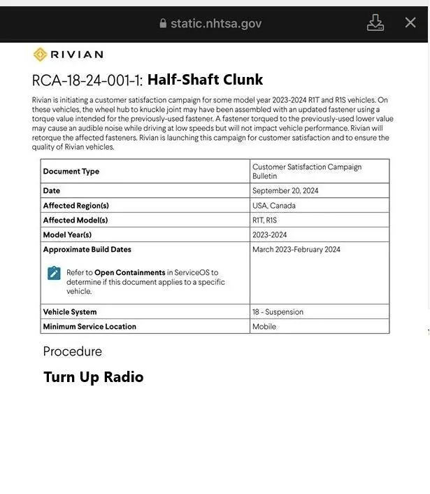

So there is no half-shaft clunk fix other that turning the radio up.
I can still feel it in the pedal, unfortunately...the radio drowns out my loud Pirelli's though. ;)
