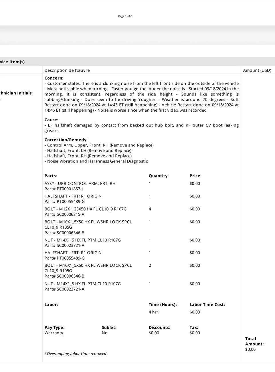

I am going to share my story that happened this week here, since there is a discussion on half shafts, clunking etc.
On Thursday my R1S (G1 Quad) started to make an awful clunking noise from the front left (see video).
I tried driving at different ride heights but that didn’t help and it just kept getting worse. Called Rivian service and went through the usual reset process. Very wonderful service agent (Taylor) quickly set me up with a tow to El Segundo and a rental car.
I was resigned to being without my car for a while so I was surprised to get a call the very next day saying my car was fixed and ready to be picked up. A true miracle.
I have attached the invoice that says what Rivian found. According to the front desk person this is a very common problem and was a result of incorrect sized hub bolts installed at the factory, which subsequently loosened and damaged the half shaft. They replaced both front half shafts and also the right front CV boot which was leaking grease.
I share this just to point others who might have this issue. For me, it came on very suddenly and I had not noticed clunking or or other noises before this week.
Also huge shout outs to Taylor on the phone and Ray in El Segundo service, who were amazing. I couldn’t have asked for a better experience.

Update:
Rivian say they packed too much grease in joint between half-shaft and motor, which caused over-pressure and the drivetrain computer to freak out.
New half-shaft installed with correct amount of grease and so far so good.
