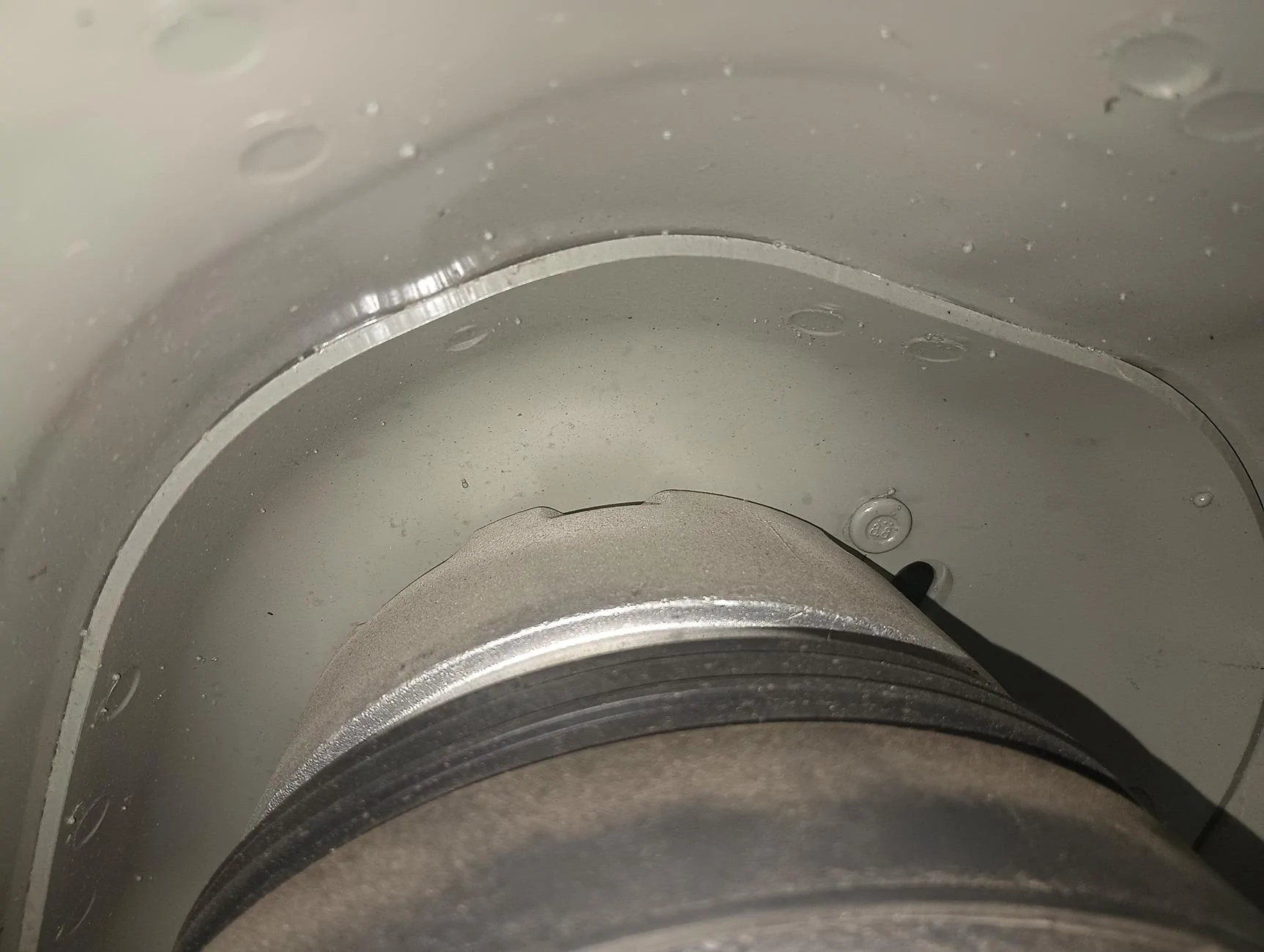

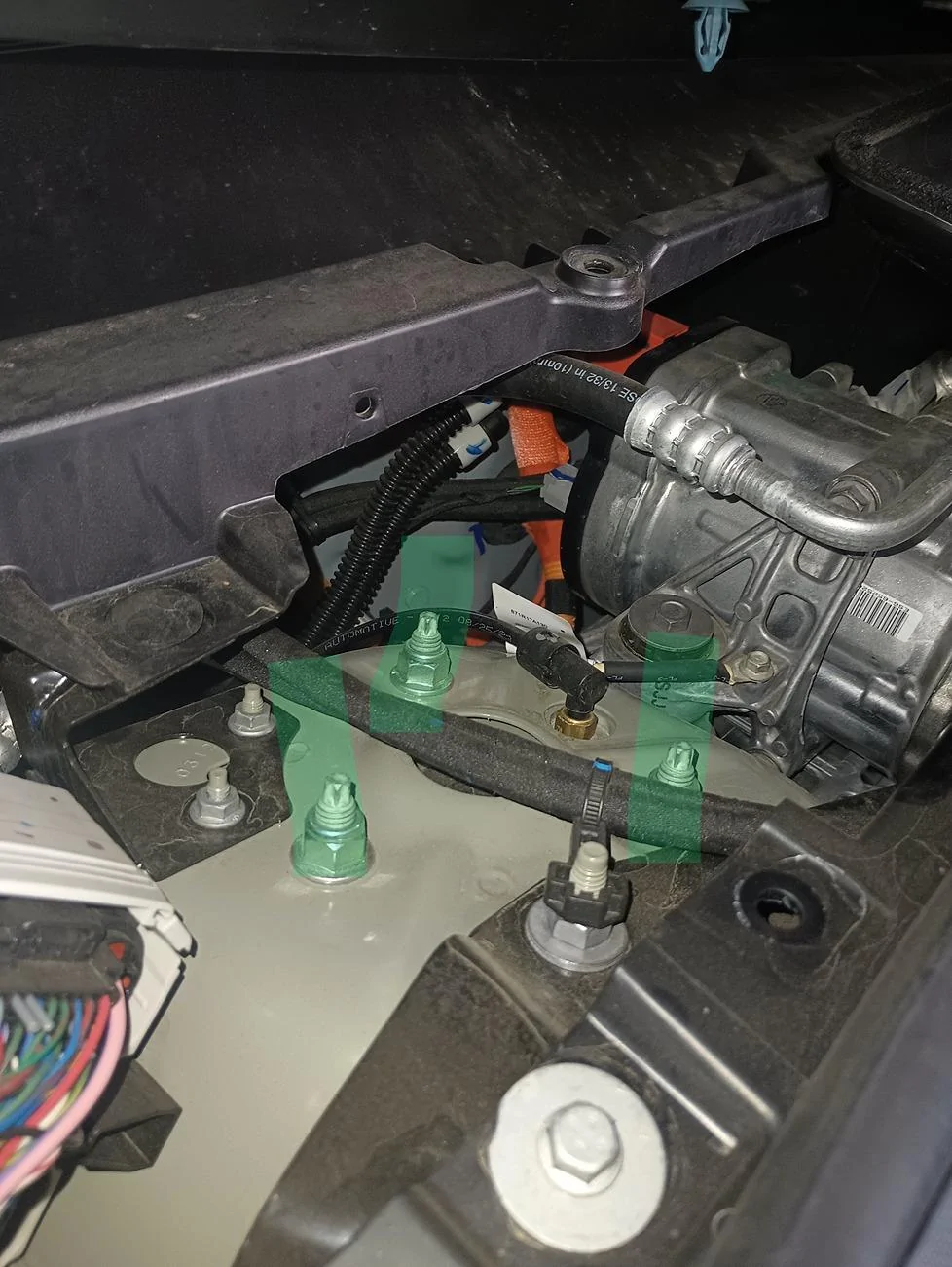

Apparently some trucks were built without a suspension reinforcing plate on top of the damper, between the suspension chassis mount. The affected vehicles apparently were only from Sept to Oct of 2021, but I have had suppliers at my job repeat the same mistakes later when they do not properly administer corrective actions. I thought it might be possible they forgot this plate again.
I checked this area on my truck. It's very difficult to get to see, I had to shove my cell phone up there and take a photo.
Rivian R1T R1S Clunking sound from front end. IMG_20241114_205453912
I have nothing like what is shown in the image. I can't feel anything in between the two parts either. In fact, I think my damper looks much different than the image, so it's possible the damper has been redesigned since then.
However, I'm going to try to chat with Rivian to confirm whether or not there should be a part in there. On every other vehicle I've owned, there is some type of noise isolation piece in there. Whether it's a steel/alum piece with a rubber insert/bushing built in or just a compressed rubber insert. I can't say that I've seen a damper mounted straight to the metal body area like this before. This would seem to transmit tons of noise/impact to the body, but why that would only happen at low speeds like this doesn't seem to jive.
Have any of you had your trucks checked for this reinforcing plate or had this fix performed?
I will let everyone know what Rivian says about this. Either way, I think I'm going to push for the knuckle/hub and CV axle torque fix next.
