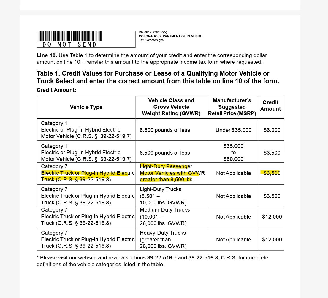

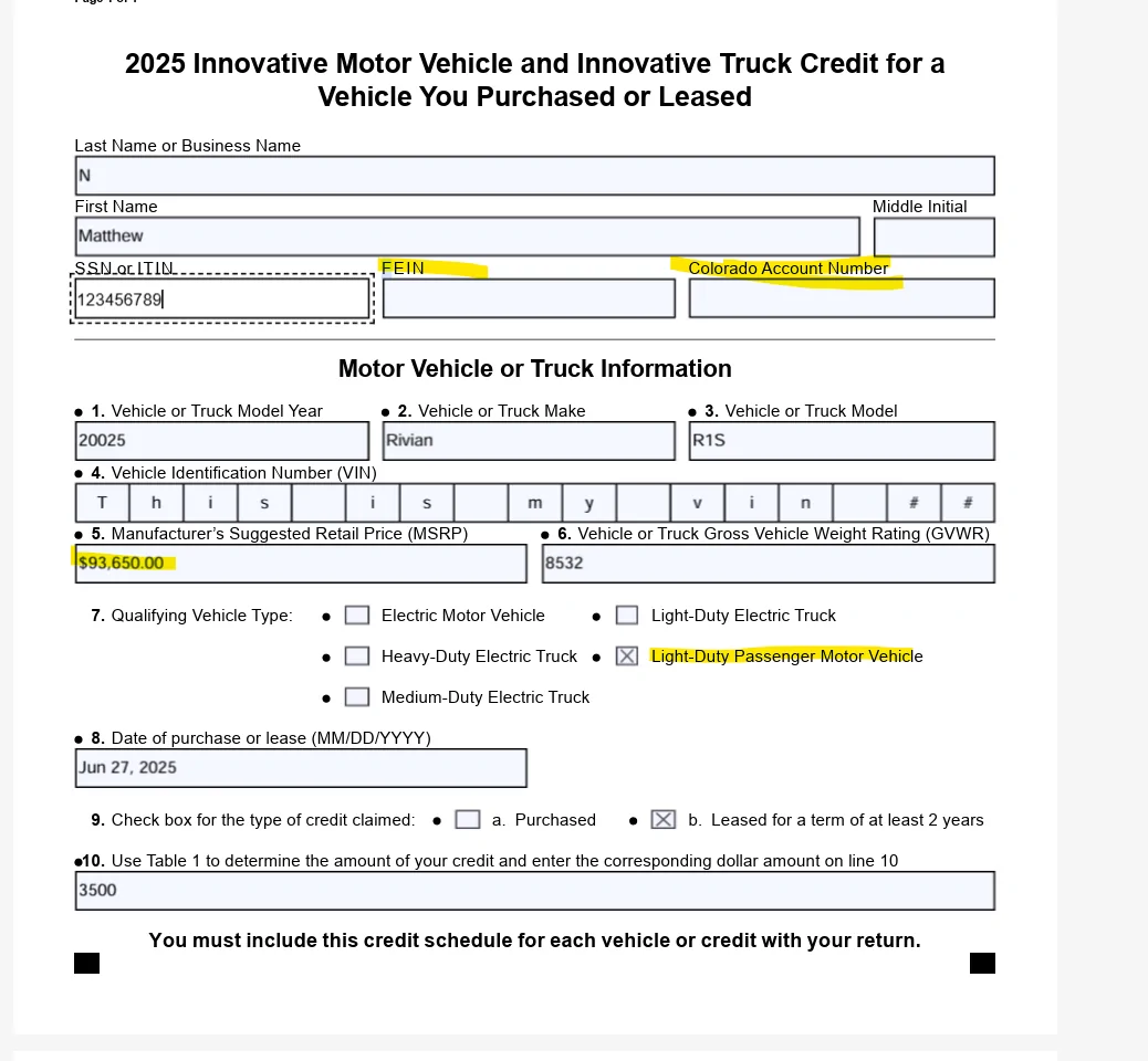

It's tax season and for us new owners I'm hoping to get some guidance from existing owners who've had to fill out the DR0617 form. I've got the 2025 form filled out as best as I can understand it, but given the 13 pages of comments and frustrations in this thread, I'm hoping to get it right out of the gate. The highlighted area's are what I'm asking about.
1 - Do I need to fill out FEIN or Colorado Account Number?
2 - Does the MSRP truly need to match something? That's the total on my order after the goodwill discounts.
3 - Vehicle type, seems to match based on the second screenshot below.
4 - There doesn't seem to be an option to include supporting documentation when filling out this for the first time and filing my actual taxes. It seems the vehicle type & GVWR are what most people had issues with when filing with CO in the past, so I want to get the numbers to match whatever future documentation I'll have to submit to CO if I need to appeal. TIA!

There was nothing wrong with my submission last year, but they auto rejected it anyway requiring me to follow up.
I don't imagine most have a FEIN ( federal employer identification number) or Colorado account unless you are filing for a business, estate etc. GWVR shouldn't matter for the Light-Duty Passenger Motor Vehicle type, which is the correct answer or the R1S/R1T. IIRC, they let me attach arbitrary documents to my tax return through revenue online, and I was thorough.

Form looks good. FEIN/CAN is going to be N/A for an individual. MSRP should be the amount on the window sticker, but doesn't really matter since the R1S is no where close to 35,000. You've selected the right category - not as crucial since the credit amount is the same for both electric MV and light duty passenger MV now. In prior years the credit amounts differed.
You should attach the sales invoice and registration to the return. Details for how to send these attachments if your tax filing software doesn't support it. https://tax.colorado.gov/training/e-filer-attachments
You could still do all this, as I did for my 2023 return, and it get rejected for no reason. In that case just follow the protest procedures and resubmit bill of sale and registration online. Hopefully they've fixed their system, but CDOR seems to be getting more difficult to deal with each year.
