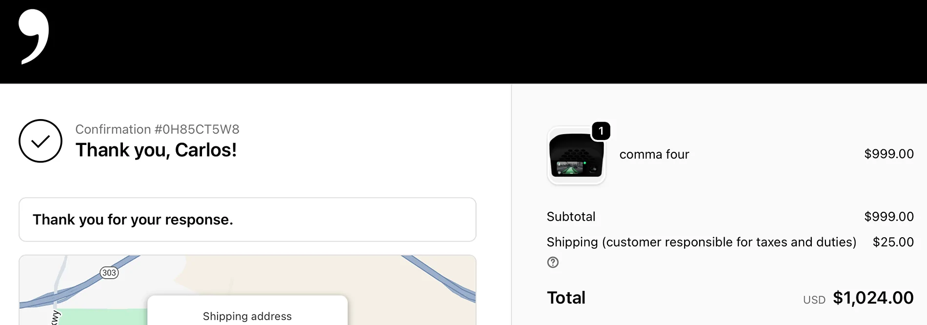

Rivian R1T R1S Comma 4 Four released 1762795535724-fo
