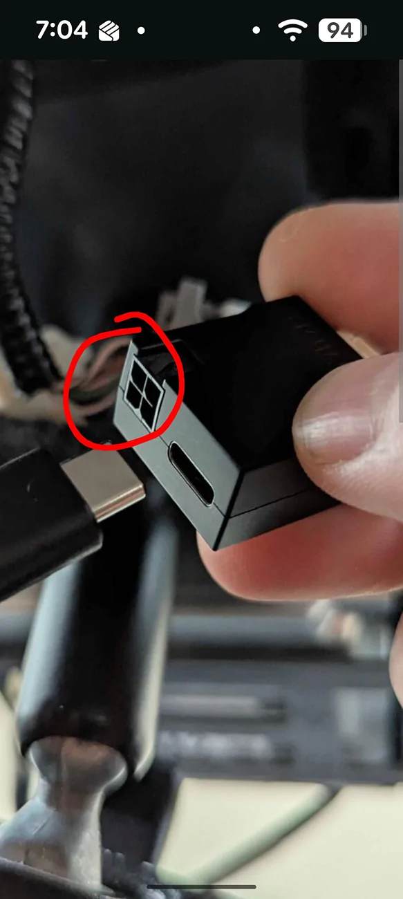

After spending way too much time learning all I can about the Comma 4 and the installation process, I’m still a little in unclear on the fuse tap. I get what the fuse tap is and the need to get one with the proper pin configuration and fuse size. My question is - how does the fuse tap connect to the Comma harness? I have seen all the installation videos and read all the online instructions. What I haven’t seen is a photograph of the proper fuse tap and exactly how it connects to the harness. A picture is worth a 1000 words, as they say. Do fuse taps have some sort of universal connective pin or what? I doubt they are all the same. Does the fuse tap plug directly into a port on the harness, or is some sort of adaptor needed? Thanks.

Yes, it plugs directly into the harness connector next to where the USB-c obd cable plugs in as shown here-

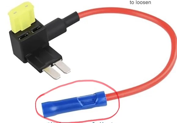

All the fuse taps I have seen look something like this. How does that connect directly into that harness connector. It sure doesn‘t look like it would. Seems like there is a missing link. Is there another cable with the appropriate harness plug that connects to female end of the tap cable? Unfortunately, I‘m trying to imagine this whole installation without the benefit of actually having it all in my hands. It’s probably all very simple and straightforward.

The Comma is supplied with what is called Comma Power. It plugs into the obd port in the driver's foot well and into that port on the harness with the molex connector. If you do not plan to utilize that, you can use the molex connector end along with one of those fuse taps if you are comfortable making the modification. If you are purchasing the longitudinal adapter from Lukas, he sells a fuse tap that has the molex connector on it. Otherwise, @gerrylum or I can probably send you one with the proper molex connector.

Aha! It’s starting to make some sense. The molex connector was the missing piece. As I understand it, it would be removed from the Comma Power and the fuse tap would be spliced onto it, then plugged into the harness. Thank you for the info and the offer!
