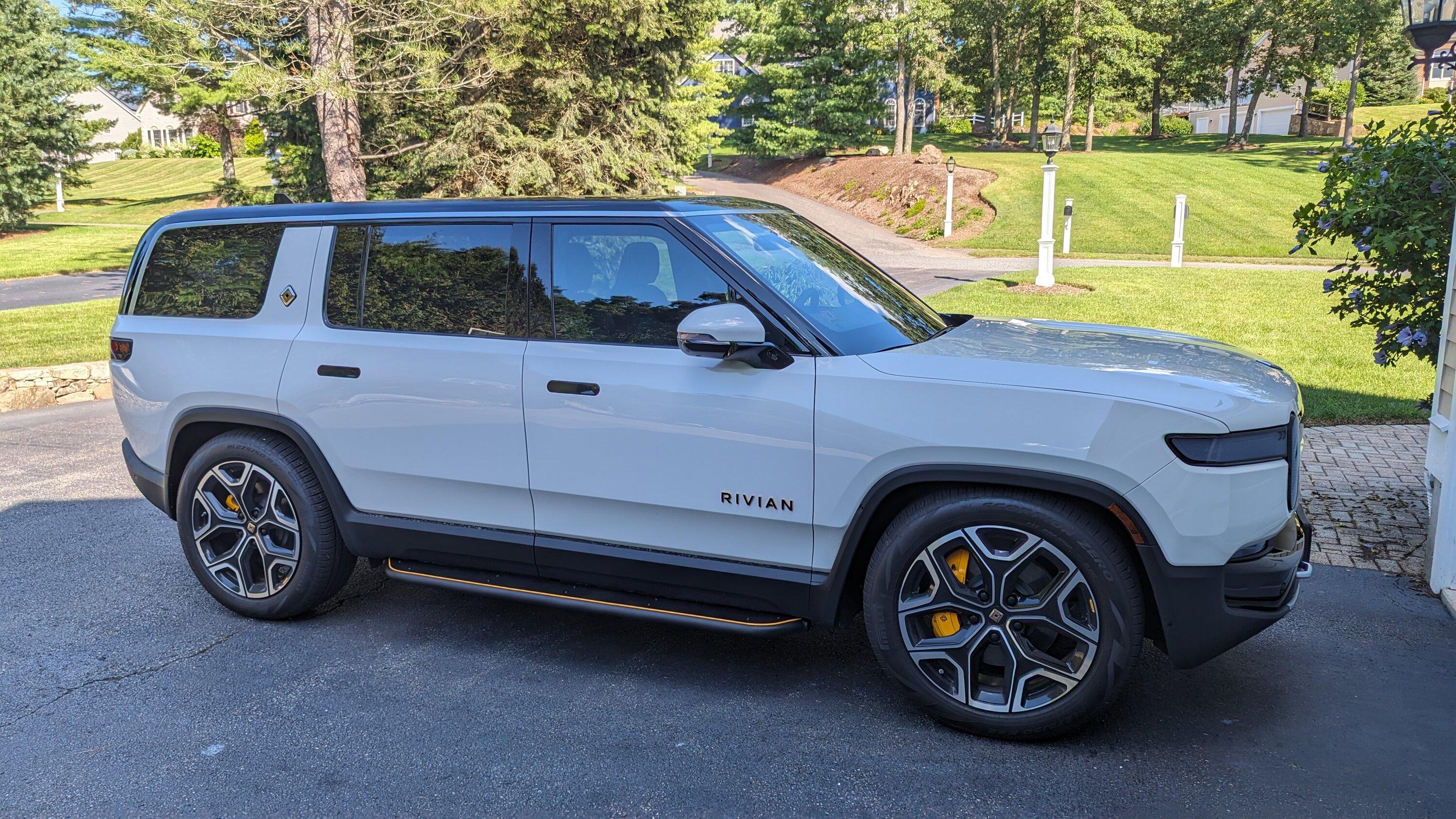

I installed these this past weekend...took 4 hours total and it went smoothly. Used the 4" hole technique.
Some additional tips:
1. Assemble the boards inside on a carpeted surface. Install the welting before final tightening of the bolts.
2. I put on a layer of ceramic coat to help with dirt and dust
3. Make sure you get a whole drill kit which has an adjustable center bit
4. Make sure you wear glasses and a baseball hat when drilling out the bottom panels – I had a bunch of small plastic pieces in my hair (what little amount is left)
5. Screw all the installation bolts loosely so that everything is aligned properly and then tighten with torque wrench.
6. Enjoy the new boards!
Ooo I like that yellow accent on running board, do you mind sharing where you got that?
