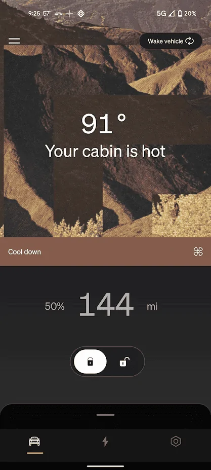

I think the key is that you have to see the vehicle going to sleep. If it's not doing that, then you're going to have excessive drain. I've only lost 2 miles since I took this screen shot almost 11 hours ago. If I check the app now it still has the "Wake vehicle" button. When I was having the excessive loss, this was never displayed.
I don't know if doing the hard reboot of the vehicle was the "proper" solution, but it seemed to work for me. (This is still a lot more drain than I consider acceptable, but 2% per day is way better than 10%.)
