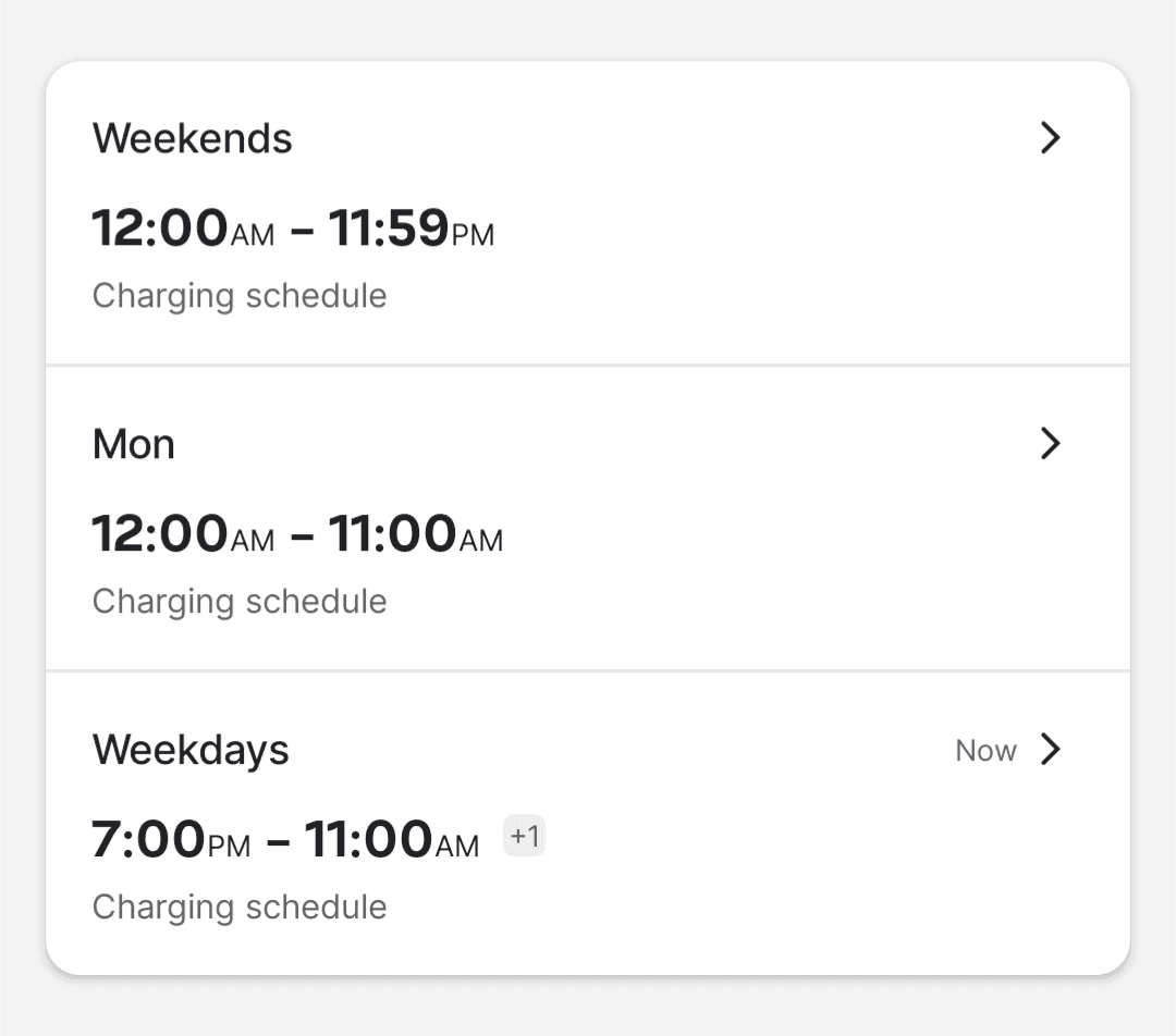

Used to have the issue of the vehicle not picking up the change with my wallbox, but Rivian fixed it for me several software versions ago. I'd also double check your schedule. I had to explicitly add Monday morning in.
