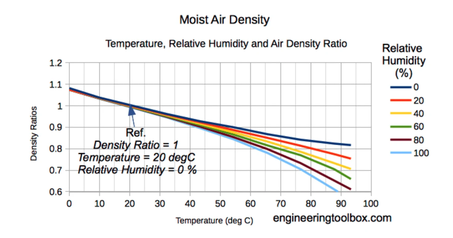

I'm willing to bet some percentage of the 'rain loss' is actually just humidity loss. Humid air is denser than dry air, so it offers more resistance. I really don't think the water on the pavement has a whole lot to do with it, but I'm not an expert. Just trying to apply some reasonable logic.
You're reading the chart wrong. The higher the humidity, the less dense the air. Also, the higher the temperature, the lower the density, fwiw.
"Rain loss" is mostly caused by higher rolling resistance from a wet road surface and a small contribution from running wipers and headlights. I honestly don't know what a typical effect will be, but I'm guessing it varies based on tire tread and design.
Yep, caught me having stepped away without finishing my second edit update to note that I'd discovered that via some googling. Appreciate the correction.
