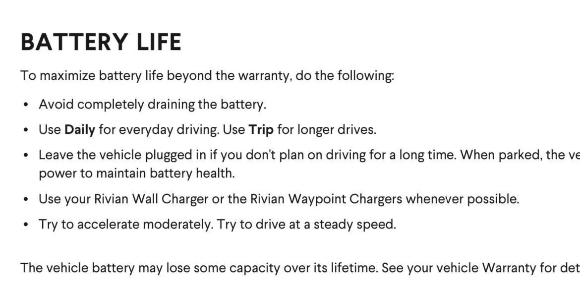

On what are you basing this statement? It seems to me the issues are interrelated. I’m no electrical engineer, but The manual clearly states: “Leave the vehicle plugged in IF you don’t plan on driving it for a long time.” Not every day.
I think your strongest endorsement for your theory is "I'm no electrical engineer".
Rivian will tell you to plug it in every night and you'll be ready to go in the morning. Just like all other EV manufacturers.

Well that sounds great - I stand corrected. And you’re probably not an electrical engineer either. But you found the right piece of guidance, from the proverbial horse’s mouth. That’s good enough for me.
