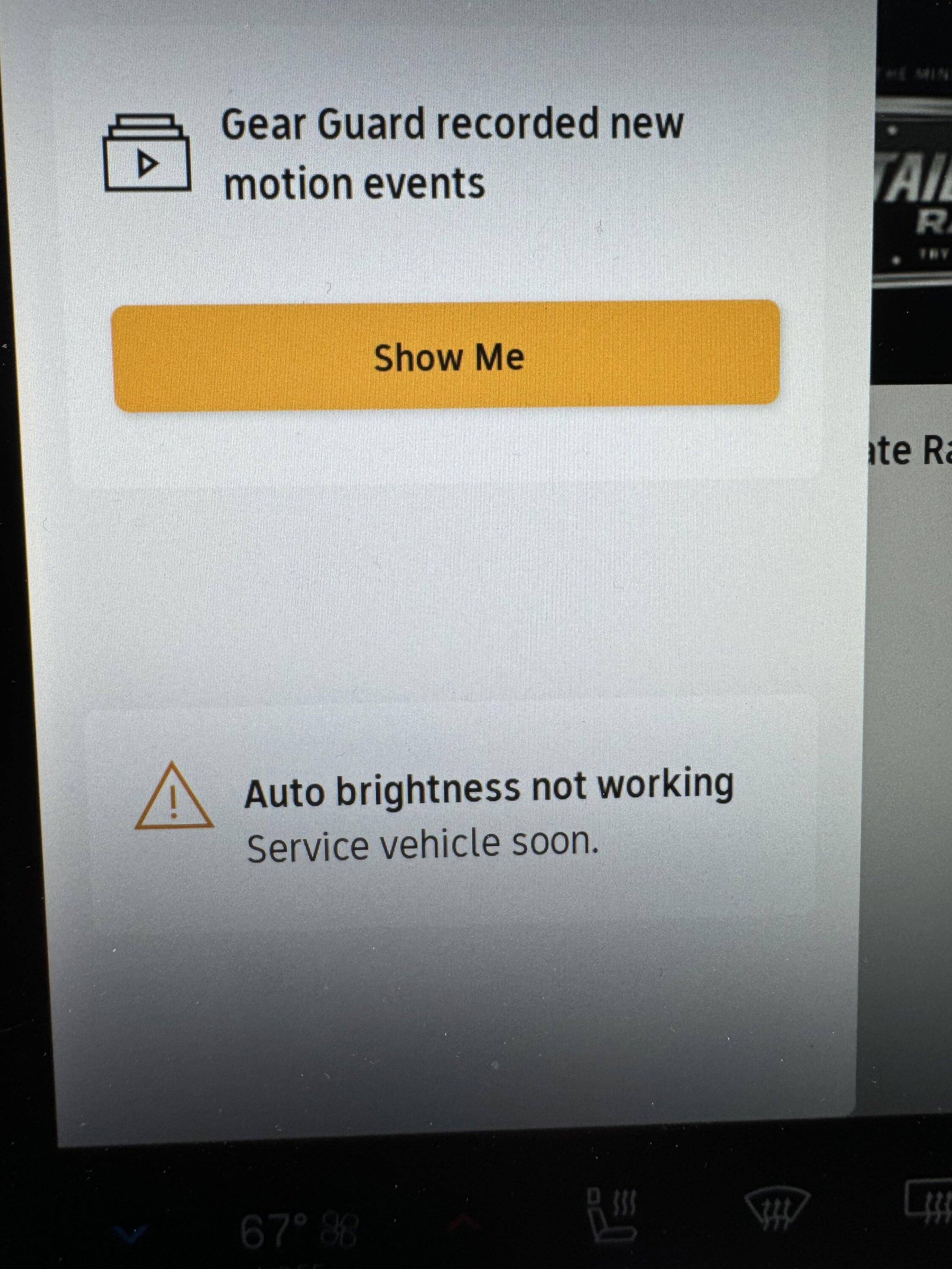

Rivian R1T R1S Does anyone else have a problem withInfo Screens turning off while driving? IMG_2229
My screen that’s behind the steering wheel flickers. Sometimes it’s bad sometimes it’s not. Did many resets and hard resets and still
Comes back. Get this message twice:
“Auto brightness not working service vehicle soon”
I’ve had my R1S only a couple months so I’m just waiting to see if any other issues pop up before I schedule my service appt.
