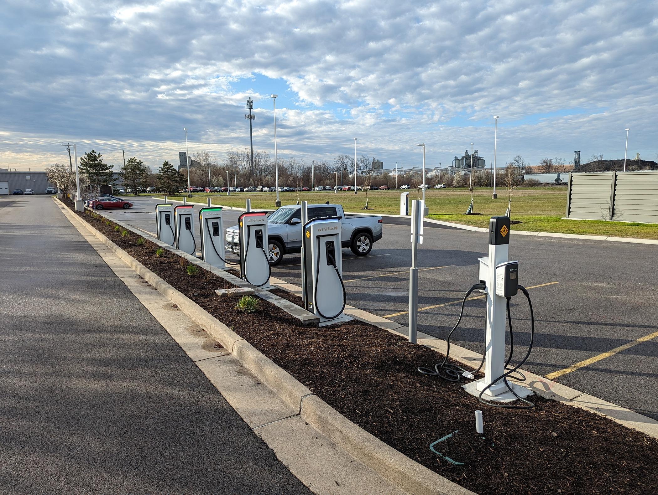

I had an eclipse trip where I charged up with magic docks night before and about noon when I was 200 miles south at a Rivian supercharger station I had not seen before in Bowling green, OH. Both worked flawlessly but I went late evening to Tesla one and noon to the Rivian to avoid rush times.
Eclipse was wonderful and traffic not too bad on way back North.
Bowling Green, OH???Are you sure the Rivian charging station is not the one in Maumee, OH on Conant St in the Meijer parking lot?

Had the same question. Juiced up in Maumee there and back Monday (roughly 12 hrs apart) with no issues.
Passed Bowling Green on my way to Wapakoneta OH.
