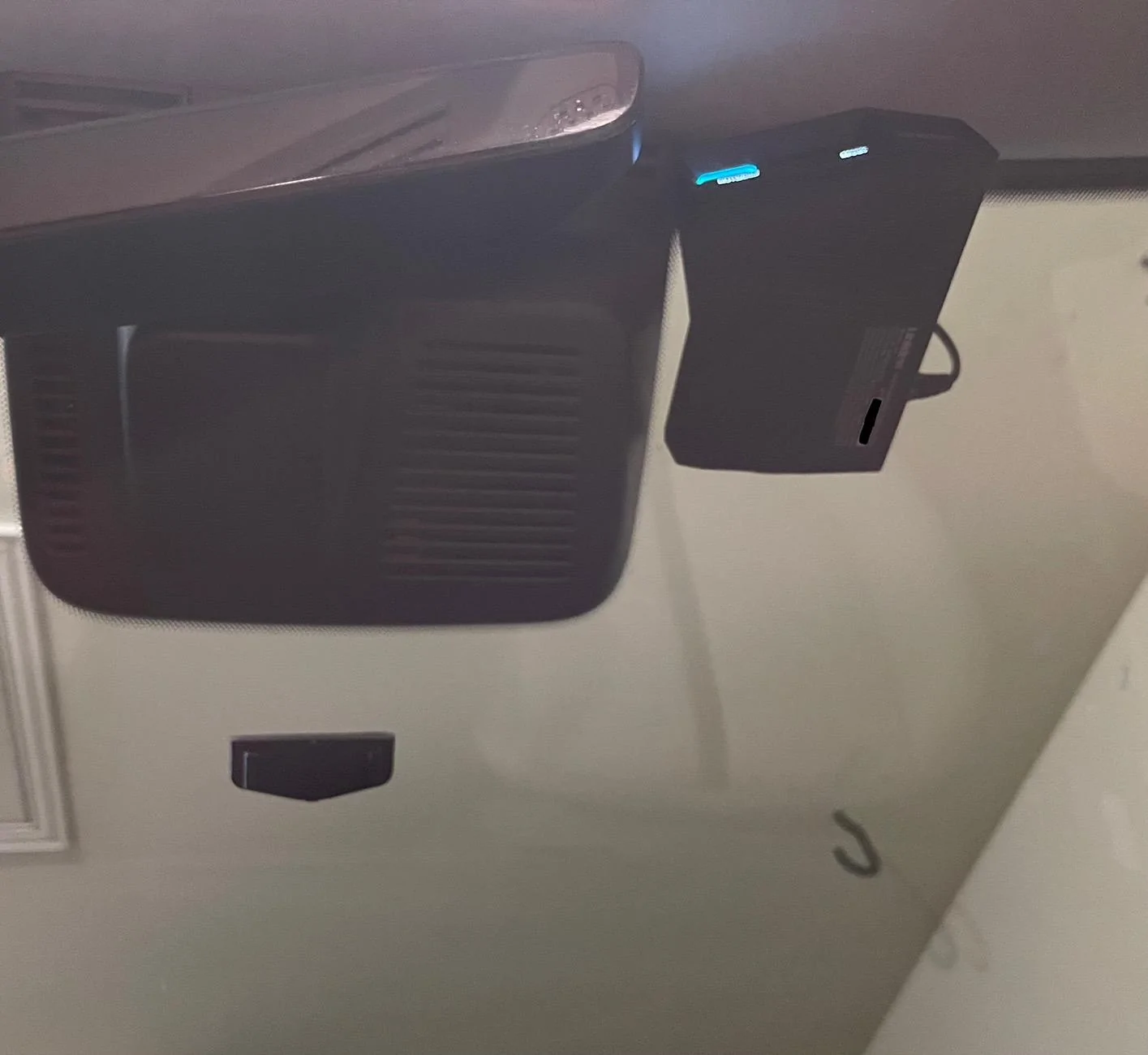

Looks good. How much space is it between the mount and the base of the cover? Did you run the wire for the comma yet thru the side panel ?
To clean the tint on the windshield, I used chemical guys cleaner first, then invisible glass which is safe for tint and finally 50/50 isopropyl solution to clean and then attached the Comma 3x mount.
edit: One good point made by @gerrylum is that If you want the Comma in the center of the windshield, you need to align it with the mirror stump which is in the actual center of the windshield. I will do that for sure on my magnetic mount.
I mounted the beartech. I positioned it directly under the mirror stalk and about half an inch toward the driver side by mistake. I tried to renposition it but it stuck pretty good. I bought two sets of beartech magnet and 8 degree wedge since I was planning to put in both of my Rivians but now I'm only gonna use one. So I have extra set if u want it

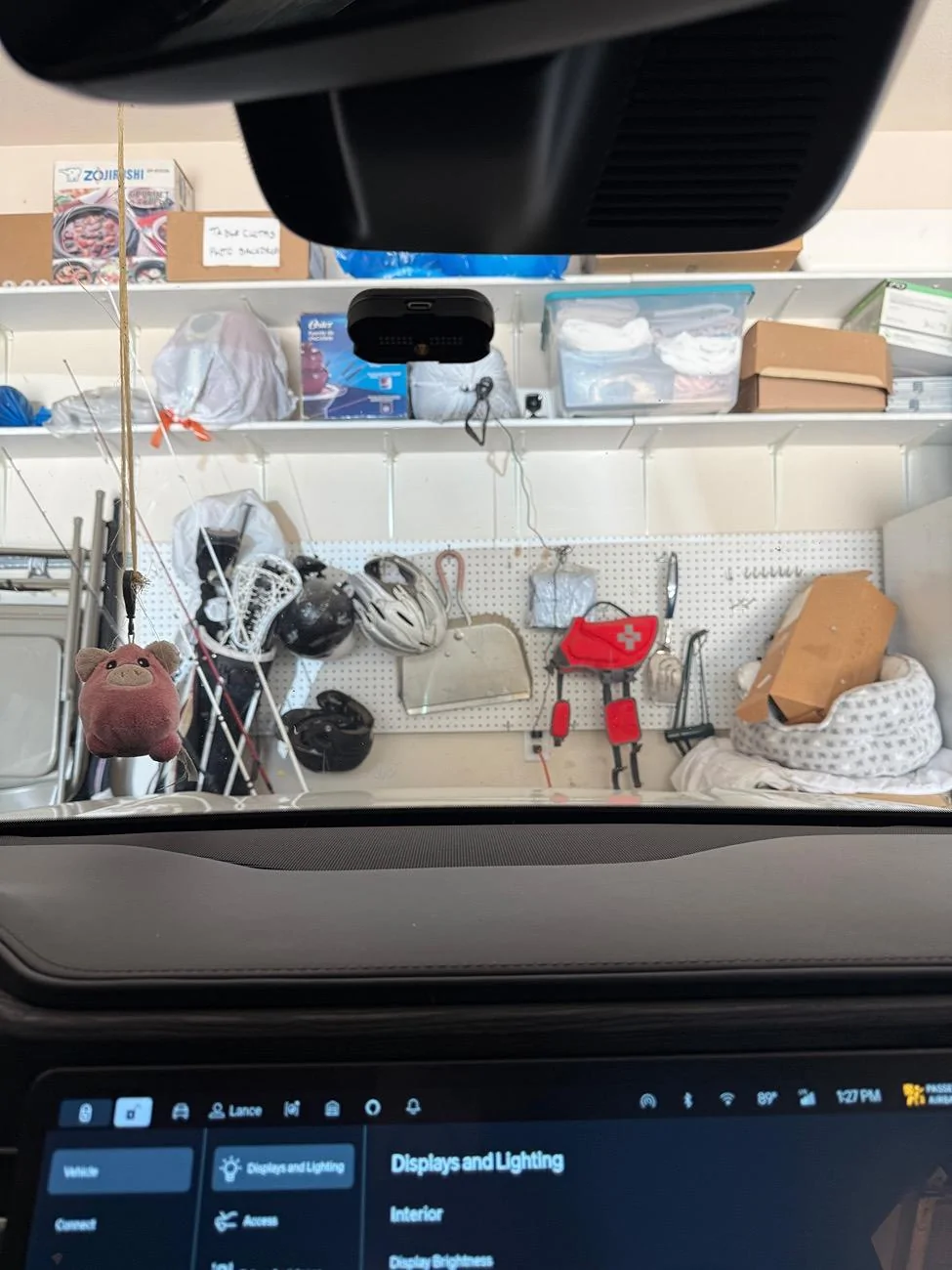

So, the 3M tape came with beartech mount didn't stay on long enough. I do have tint on my windshield. I thought it stuck pretty good, but it came off yesterday. I did cure it for 3 days before putting the comma on. Any tips of tricks to get it to stay on?
Try using 3m adhesive promoter

When you ready to install the mount, make sure you use 3m adhesive promotor . It is working so far and not coming off the tinted windshield
