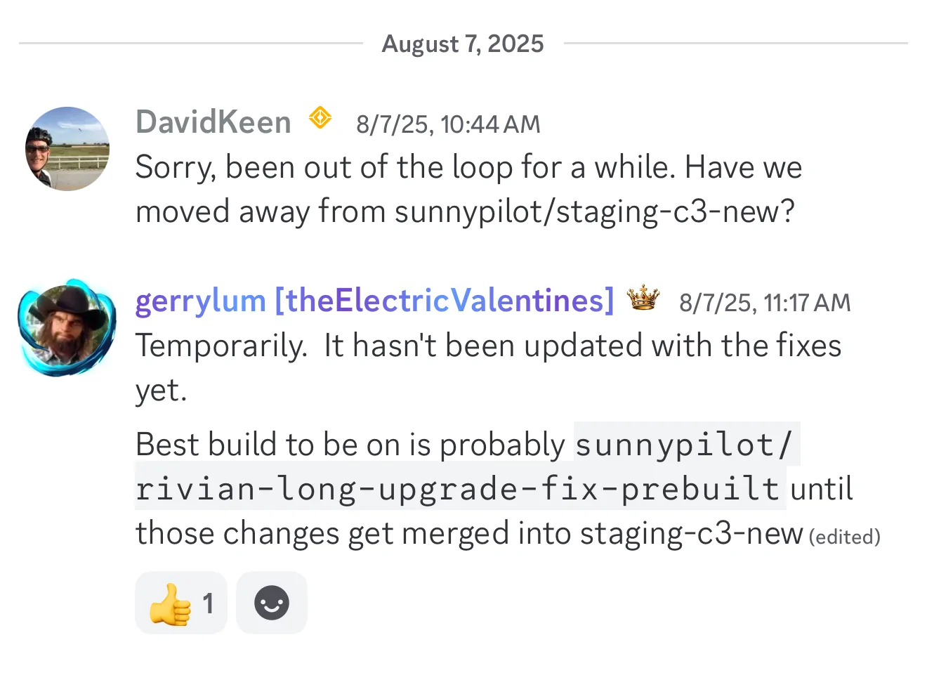

@gerrylum or any other experts out there, would you be able to help guide me on which software you’d recommend for someone with Lukas upgrade? Supposed to be getting harness and comma in the next week and would like to be ready to go but I’m still confused which software I should run. I’m on the comma and xnor discord chats and it seems like different versions are being recommended between those two chats. Excited to join the fun. Great videos and tutorials btw Gerry.

Use sunnypilot/staging-c3-new for software and Space Lab 3 for the driving model.

Thank you for the info but It sounded there was a fix needed for sunnypilot but I might be mistaken.
It looks like a new build of staging-c3-new was completed about 30 minutes ago so it should be good to go.

Thanks Gerry. You guys weren’t kidding about things changing rapidly with Comma.
gerrylum
Gerald
Apr 25, 2023
567
799
Providence Village
Director of Marketing
So I just tried installing staging-c3-new and it looks like it still doesn't work with the long upgrade. Best to stick with sunnypilot/rivian-long-upgrade-fix-prebuiit for now.

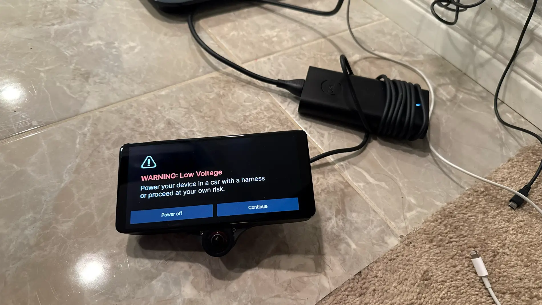

Thanks for checking Gerry. Just to confirm. Installing with the low voltage message is okay?
Rivian R1T R1S (Ended) Comma 3x Sale for $899 1754779647116-qn
gerrylum
Gerald
Apr 25, 2023
567
799
Providence Village
Absolutely! It just says that because it expects to see 12v from the car. But it will work fine.
