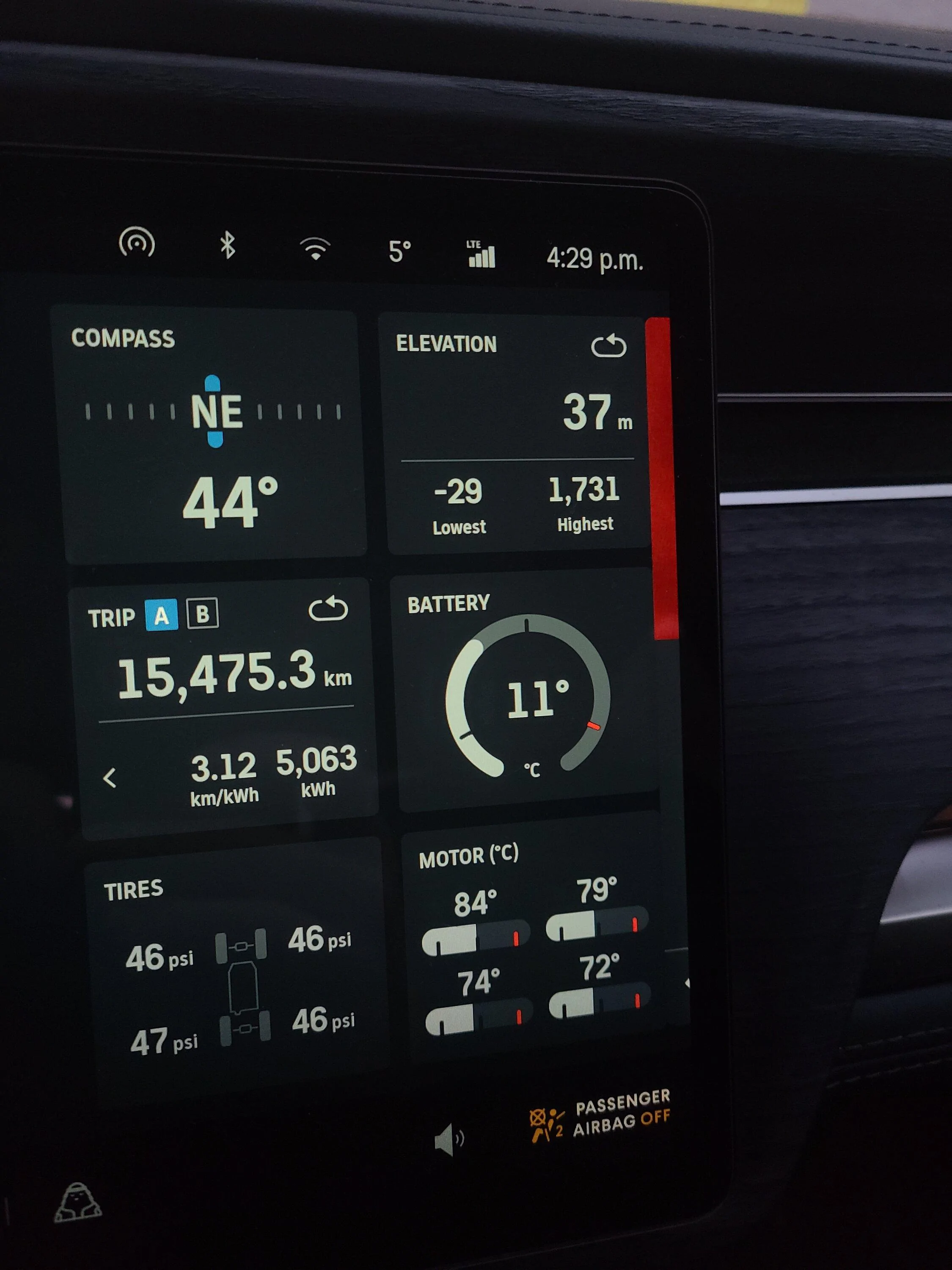

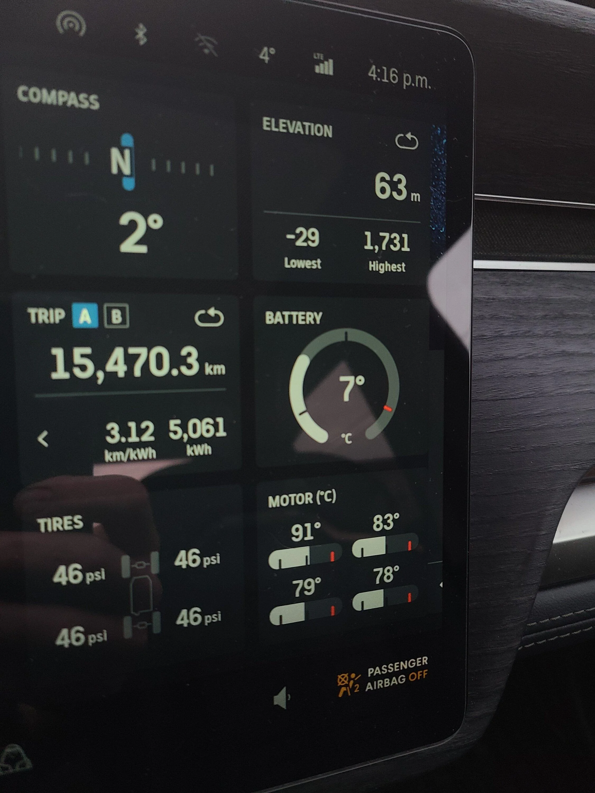

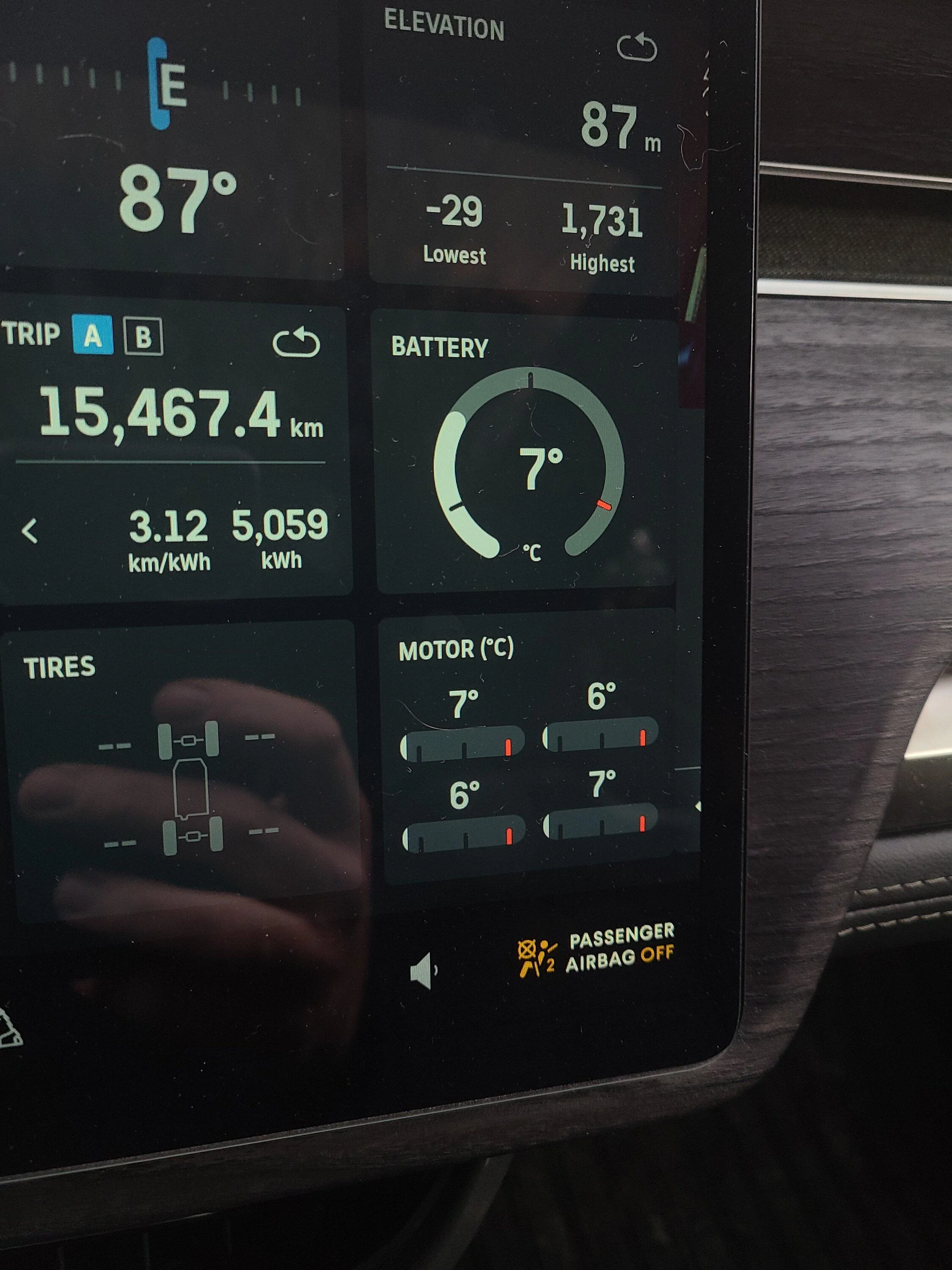

As a further data point for the QM variant, I took three photos, one at 4:11pm once in the vehicle and drove home. No destinations or chargers set in the navigation. The remaining photos were at 4:16pm, and 4:29pm, once home.
Rivian R1T R1S Enduro Battery Heating 20231129_161032
Rivian R1T R1S Enduro Battery Heating 20231129_161630
Rivian R1T R1S Enduro Battery Heating 20231129_162911
Yeah, even when the battery is conditioning, I never see temperatures near that high in the Enduro.

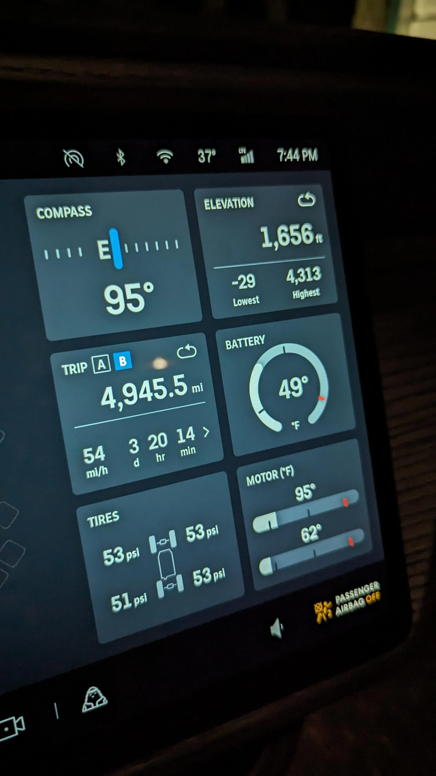

Us Enduro guys don't have any of the excitement the QM fellas are having. No wild heat spikes, everything pretty much running temperatures I would expect. I have driven from the hot deserts of Mexico into the Oregon Sierras in the last week, and not seeing any readings of any real interest lol.
Rivian R1T R1S Enduro Battery Heating 1000001348

Some anecdotal data for my Dual Performance Enduro
Started driving today morning:
Outside Temp - 32F
Battery Temp - 36F
Motor Temps - 40F
On the ten mile drive, at arrival time, the data was:
Outside Temp 36F
Battery Temp 49F
Front Motor Temp Hovering between 128F - 135F, never above
Rear Motor Temp Hovering between 95F and 108F, never above

Very in line with what I have seen. Leads me to believe that the oil bath cooling is also a better heat scavenger. Which of course makes total sense.
