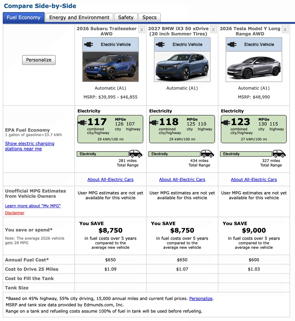

Interesting how tightly everything is clustered on efficiency
Rivian R1T R1S EPA Range Finalized / Published (R2 Performance) Screenshot 2026-05-28 at 13.22.23
I think this is likely bc they're all efficient under 55 mph just cruising around town. The Model Y is the most efficient on the highway due to its shape and lack of drag compared to others. It's highway number reflects that.

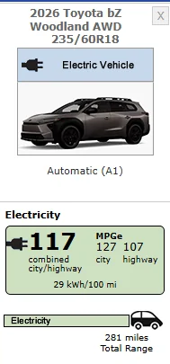

I was surprised to see how efficient the Woodland is given its size and design.
Everyone knows how to do this now. It is just a question of which incremental trade you make. More jellybean gives you and extra 8% or so, stiffer tires buys you ~7% (BMW), less frontal area always wins in real world highway where the derate is very real!
IMO incremental efficiency is no longer all that valuable. With batteries costing under $100kwh fully packaged, tossing and extra 10kwh into the belly is under $1k. If you have 800V charging, it does not matter much there either (+/- 1 minute to get the same number of miles). The days where efficiency dictated design are passing quickly. Lots more flexibility will yield better designs. R2 is a good example (though I wish RJ had not skimped on the 800V or offering the 46120s as a max pack).
Simply having 800V isn't really much of a game changer either. It's 800V AND ability to charge in 5 minutes or so (including infrastructure that requires), like what the Chinese are already doing. If refueling time and cost of purchase has parity with ICE cars, EV adoption rate would be way higher.
The Woodland is 500lb lighter than R2 and has a low front end to facilitate aero.
