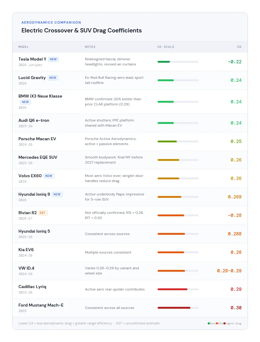

Not sure it is "absolutely phenomenal." It is middle of the pack.
My point has more to do with comparing to what was the norm. Of note, all of the vehicles in your sheet are EVs and obviously the efficiency of them is highly taken into account when designing. Packaging can be done differently compared to ICE cars to help the cd. Rivian chose to do something different in design than most EVs manufactured with the 2 box setup. Given that, I stand by my previous comment.
As a reference, here are the cds on 2 of my other cars.
2013 Audi SQ5 - 0.33
2021 Porsche GT4 - 0.34
I argue that both of these cars were pretty good for their time (Porsche started the current body style in 2017) and in comparison, the R2 is WAY better.
If you want a fun 2 box comparison, our 2001 Suburban is 0.45!
I'm just going to say I have a hard time believe the CD of the R2 is the same as the efficiency as the R1. when it's lower to the ground. It is an estimate they used, but still don't think it'll be equal to the R1S.
CD is just a function of shape. It doesn't measure total air resistance. There's other factors, a big one is size: if you shrink an object down, it has the same CD but less air resistance.
