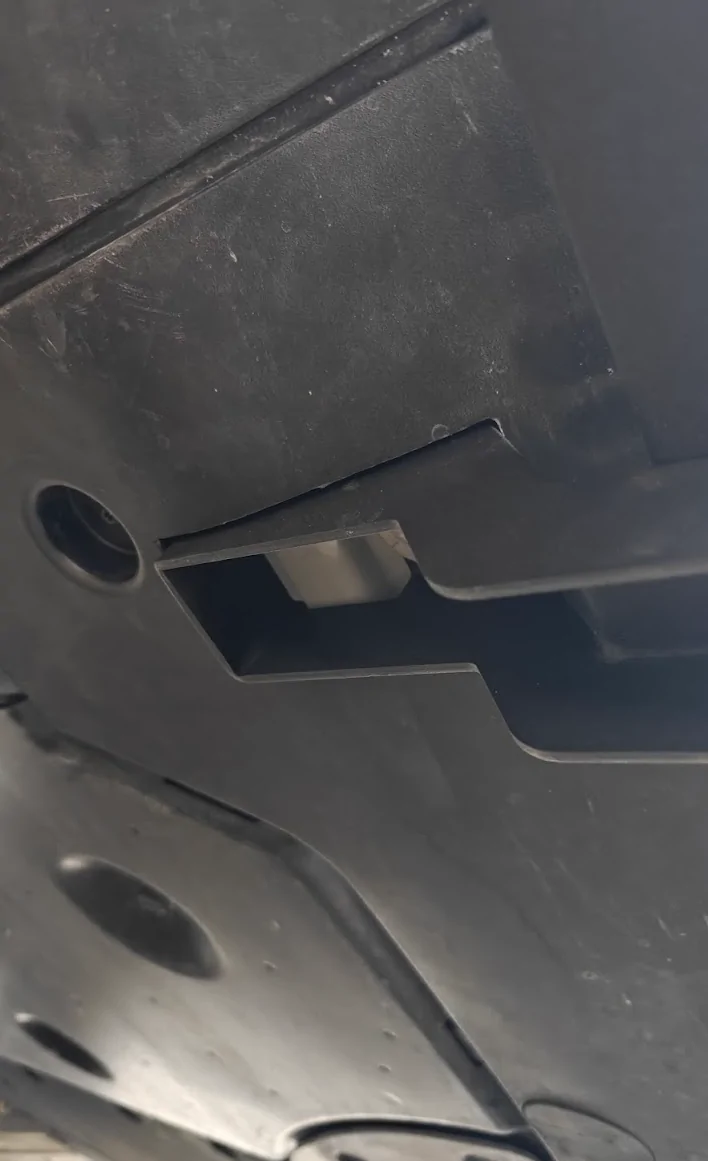

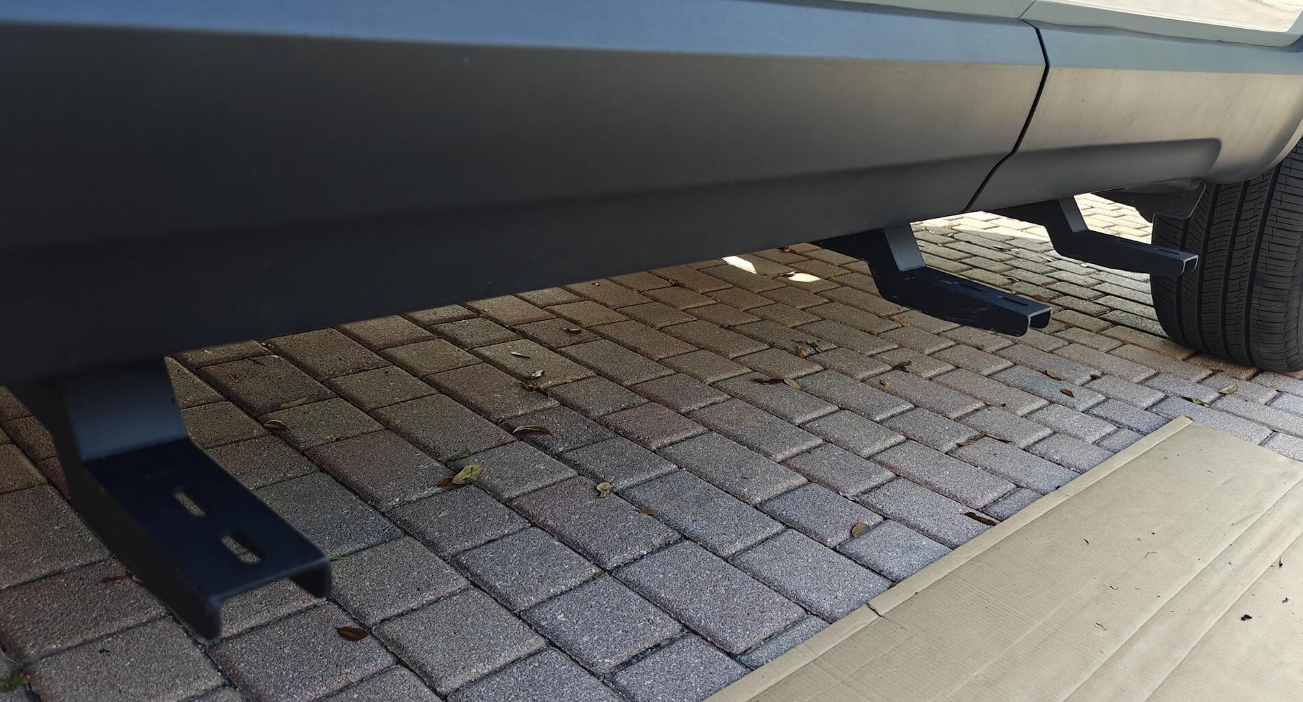

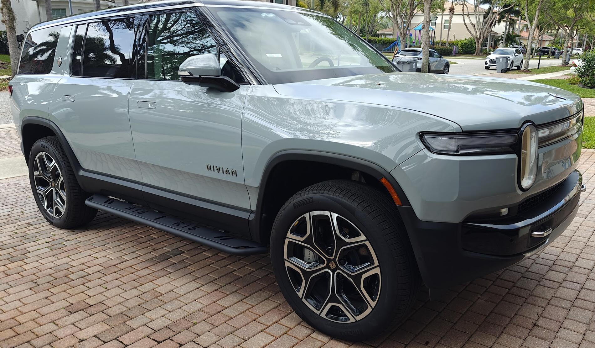

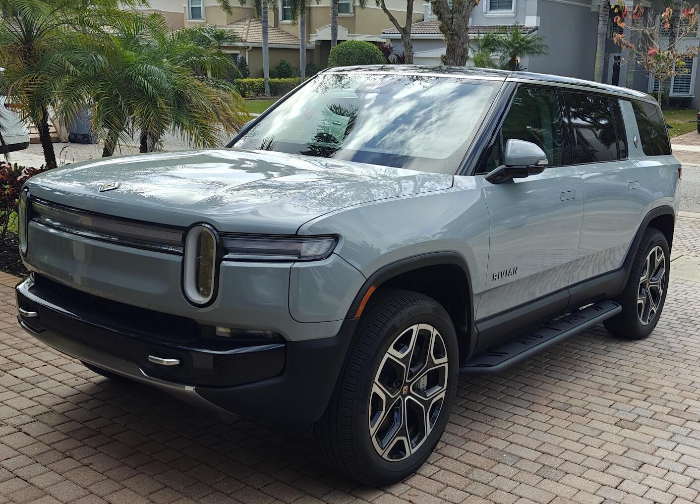

Did the install last week. Solid product. Poor instructions.
The video posted in this thread is close to being perfect.
  • I used an oscillating tool (instead of a circular saw) to do the cutouts on the panels.
  • I wouldn't torque the last nuts to hold down the running board past 20 ft-lb.

Nice clean cuts on the plastic panels! I got lazy and sloppy with those cuts. Mine are no where near as neat as yours.
how did you decide on 20ft-lb?
Anto26
Anto
Dec 13, 2024
Boynton Beach, FL
2025 R1S Max, 2020 Tesla Model 3
Based off of size and type of nut; 3/8 galvanized.
Felt like I would ruine the nut itself if I pushed more. Plus I've seen some comments online where people used a giant torque wrench and tightened 50+ ft-lb - which, in some cases, broke the inset bolt.
Spring washer + 20 ft-lb nut is good enough.

Appreciate the feedback. Glad mine didn't break at 35 ft-lb. I'll add a note to the video suggesting 20 ft-lb may be better.

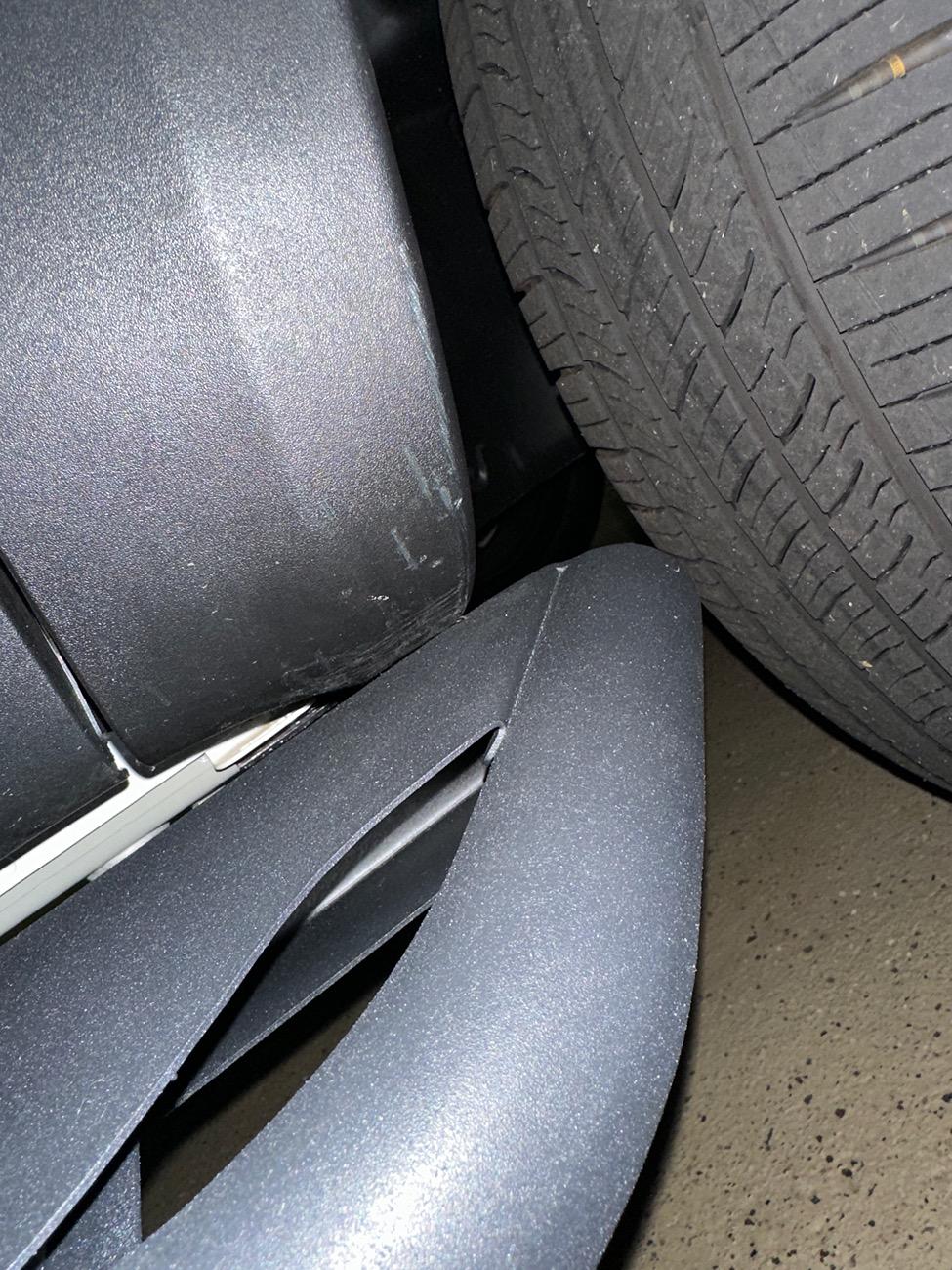

Thank you for the video. It helped. However last week when I got the product it had the same numbered brackets (no 2) and the same was listed in the instructions. When I installed it I am unable to fit the board. It either hits the rear door or the front frame that’s there for aerodynamics. Were all your frames of same size? length and height.

If the board was too far back the rear door would hit it when opening. I had no issues with clearance in the front. I'm not sure which part of the car the running board is hitting up front for you.
I positioned my running boards as far out and back as possible.

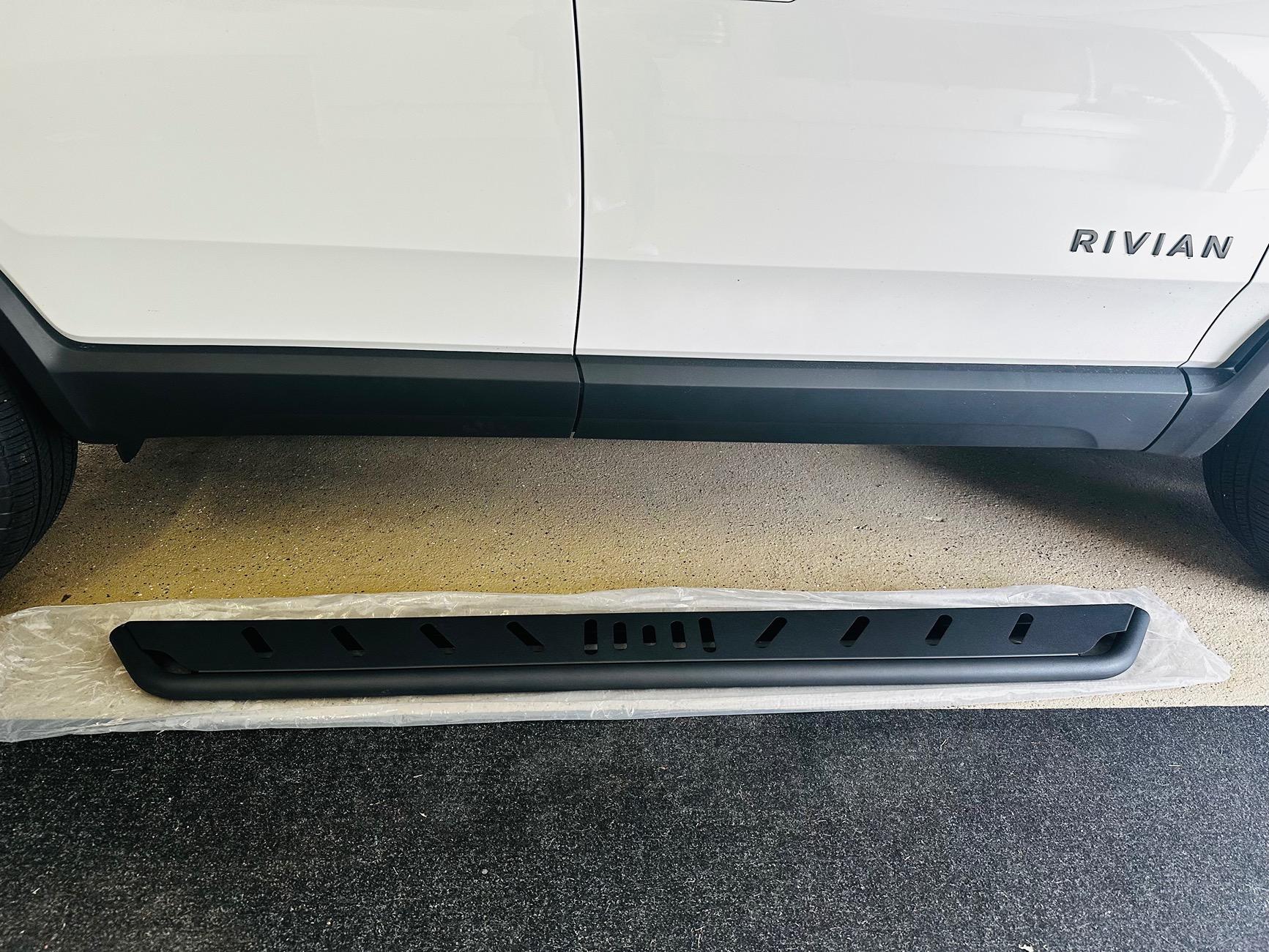

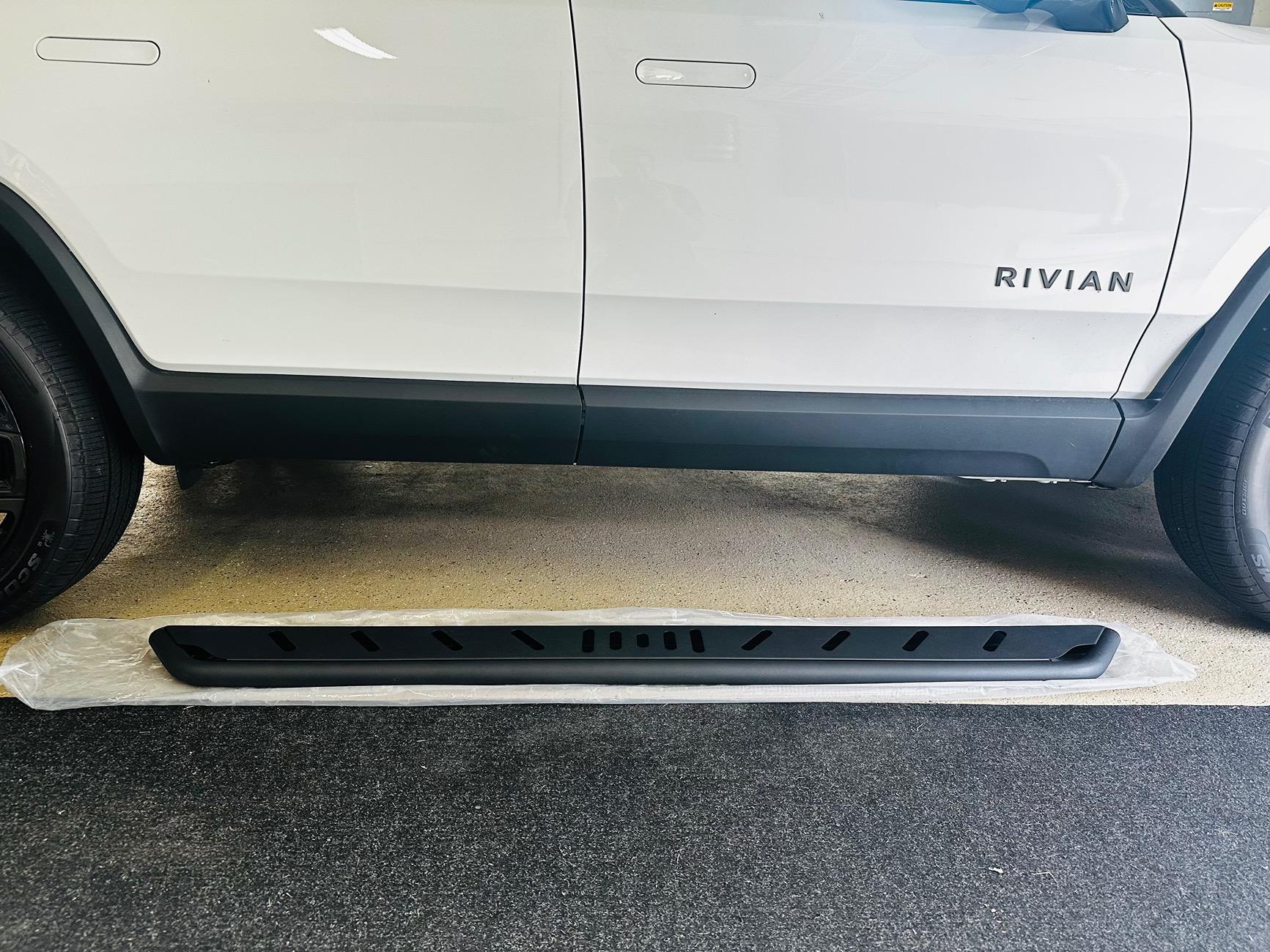

Remove the board and set it next to the vehicle and take a picture and share. Just want to confirm you have the R1S set and not the R1T as the T is much longer.
vikki1107
Vivek
Jul 12, 2025
New Jersey
Here it it’s. Also the straight part of board measures around 77inch.
