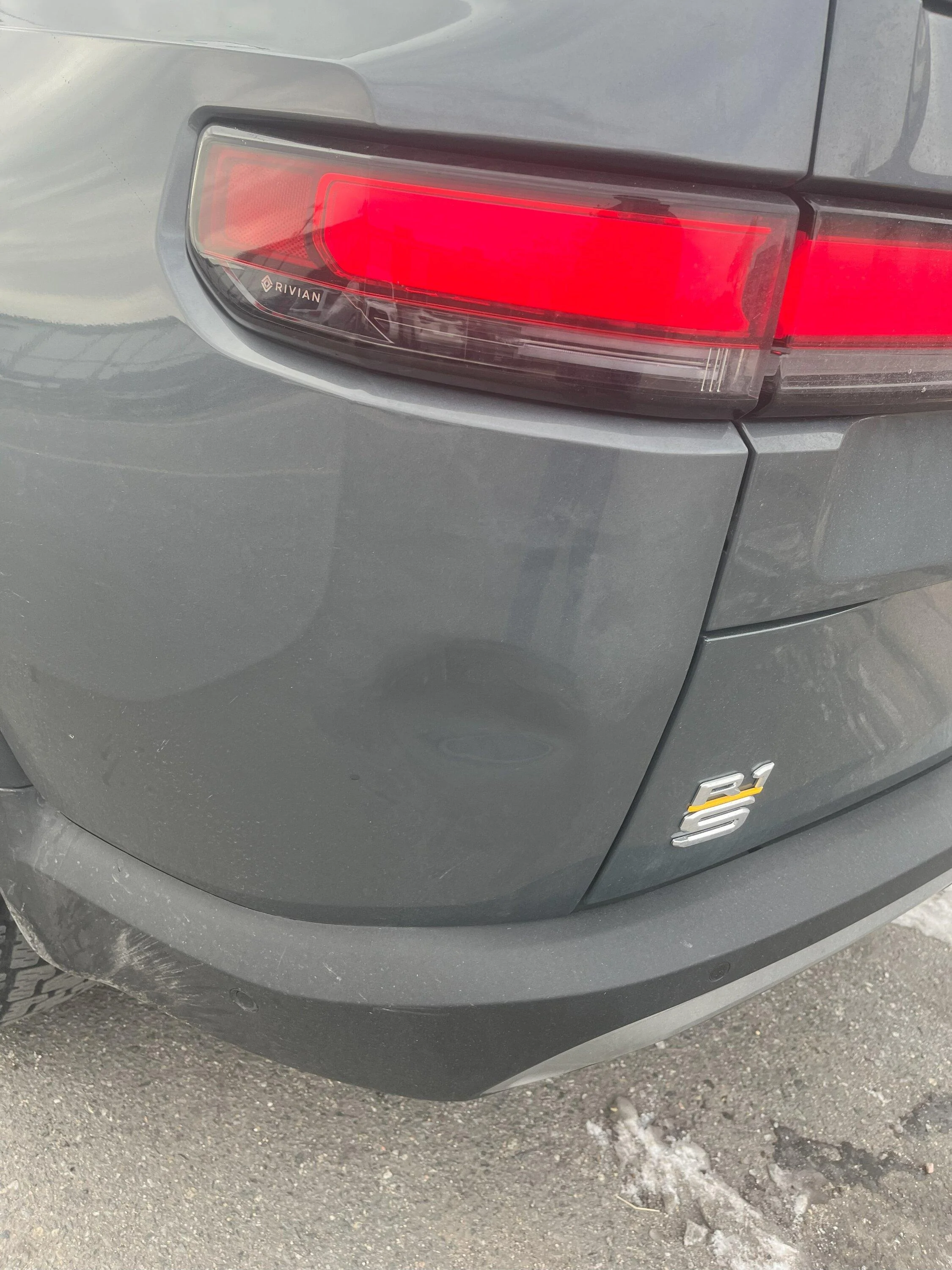

First dent - any trouble accessing behind the quarter panel? :(

Oh. Nope, he thinks he can go from the inside panel. No mention of anything below, thankfully.

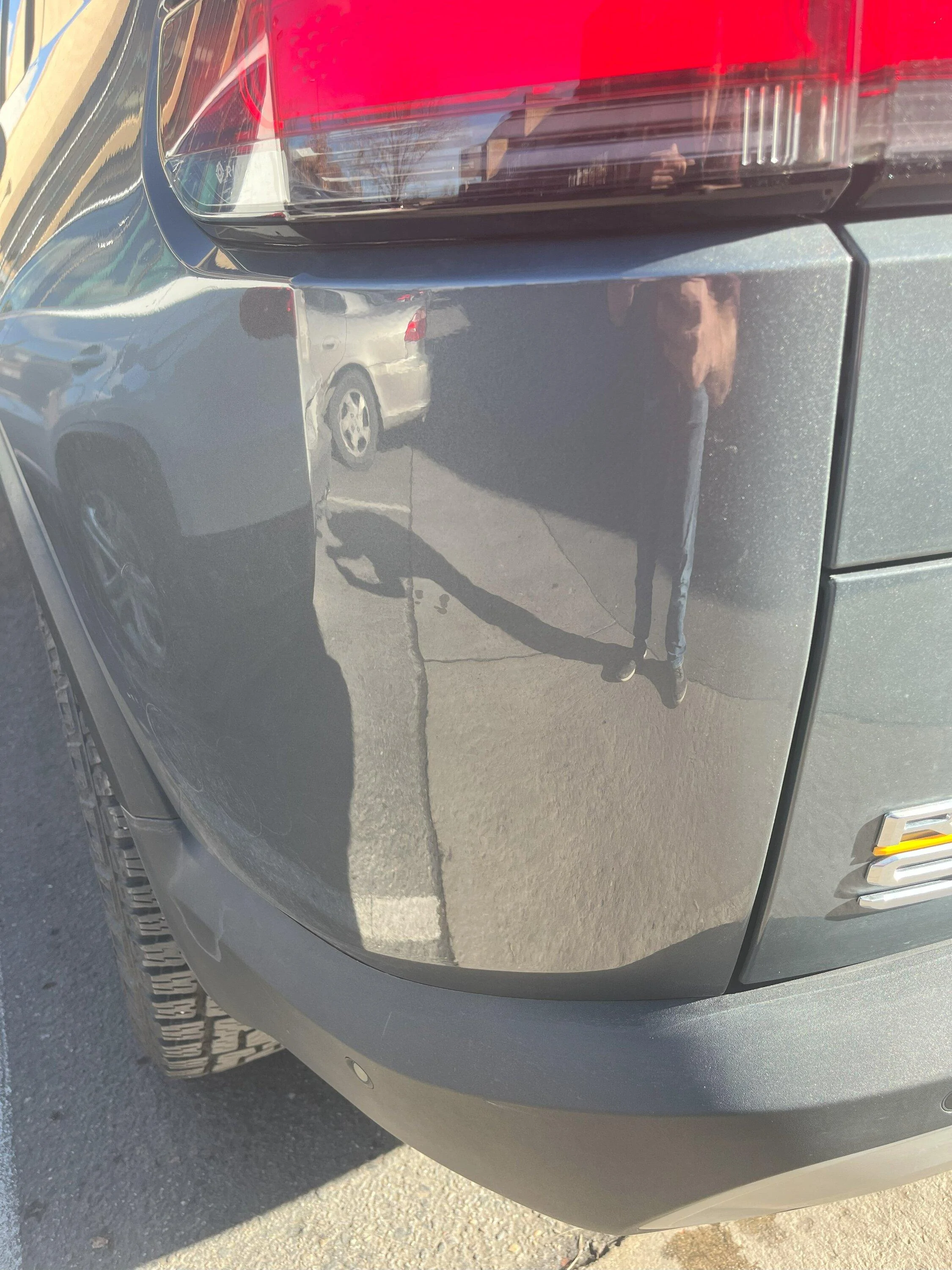

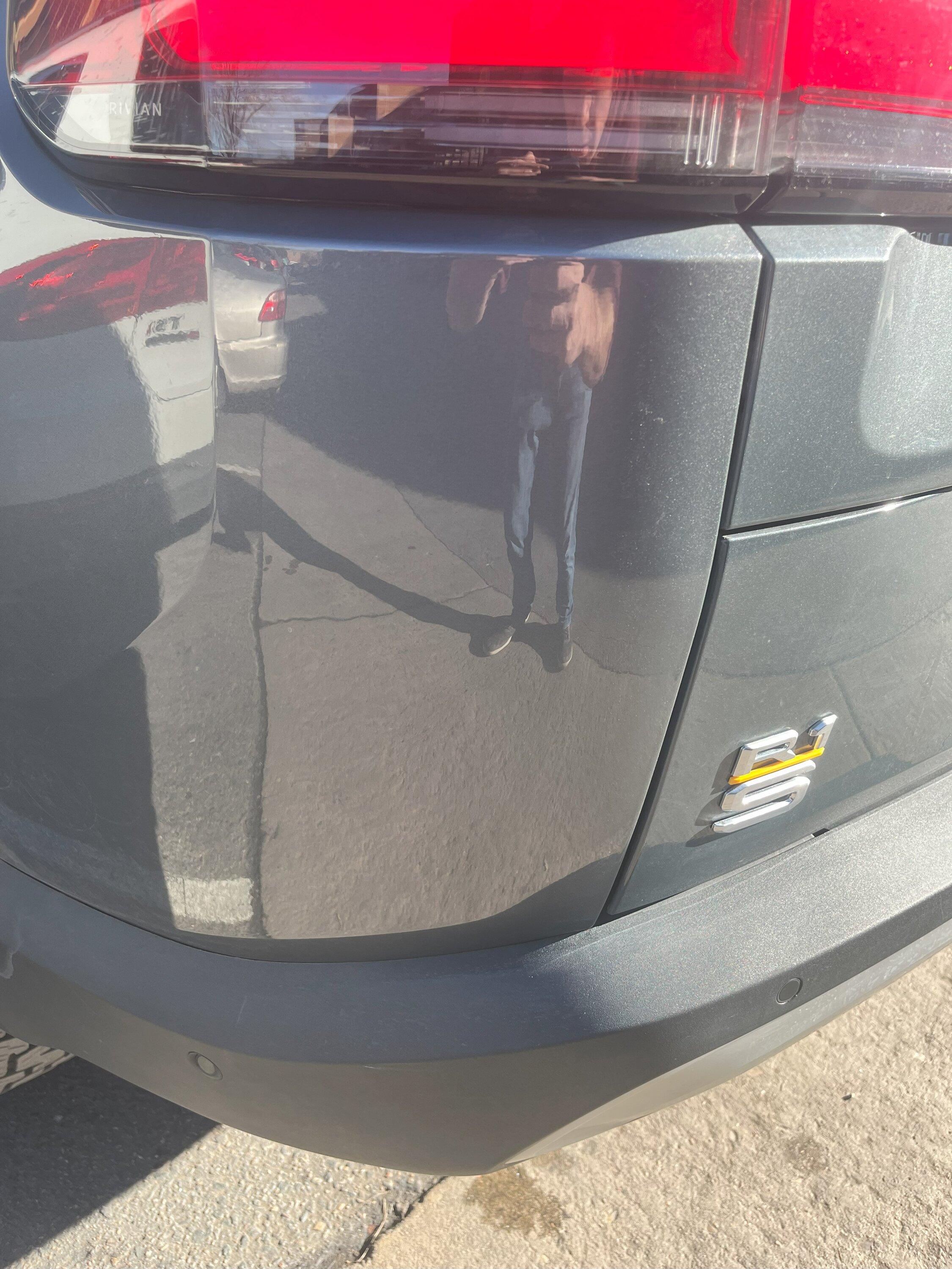

She's all fixed up now - good as new! René at Epic Dent Pros in Denver did a great job. He was able to pull it without needing to access from inside. Just needed a little sanding and buffing to remove a crease that was left behind.
Before:

After:
Rivian R1T R1S First dent - any trouble accessing behind the quarter panel?  :( IMG_0495
Rivian R1T R1S First dent - any trouble accessing behind the quarter panel?  :( IMG_0494
