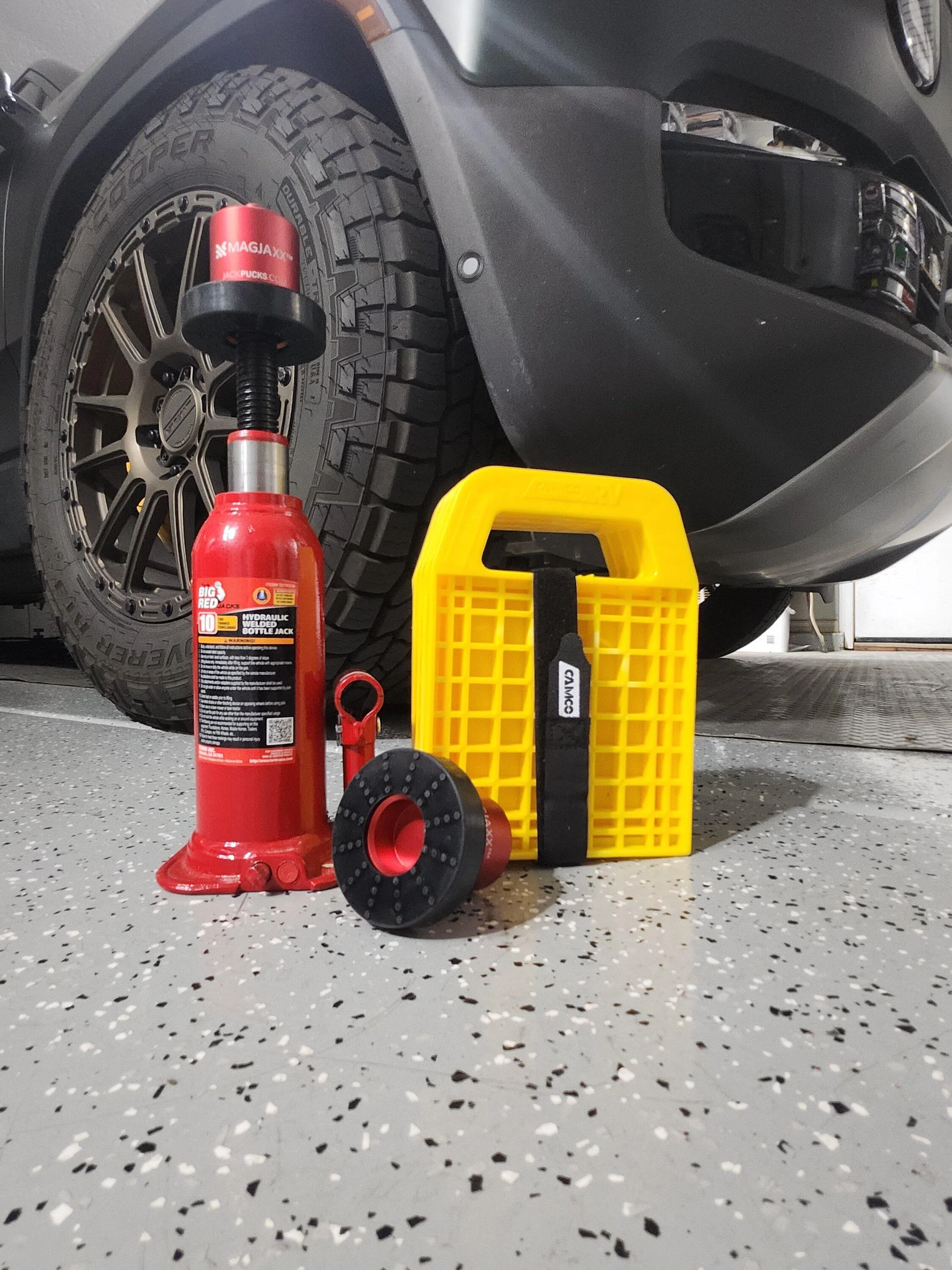

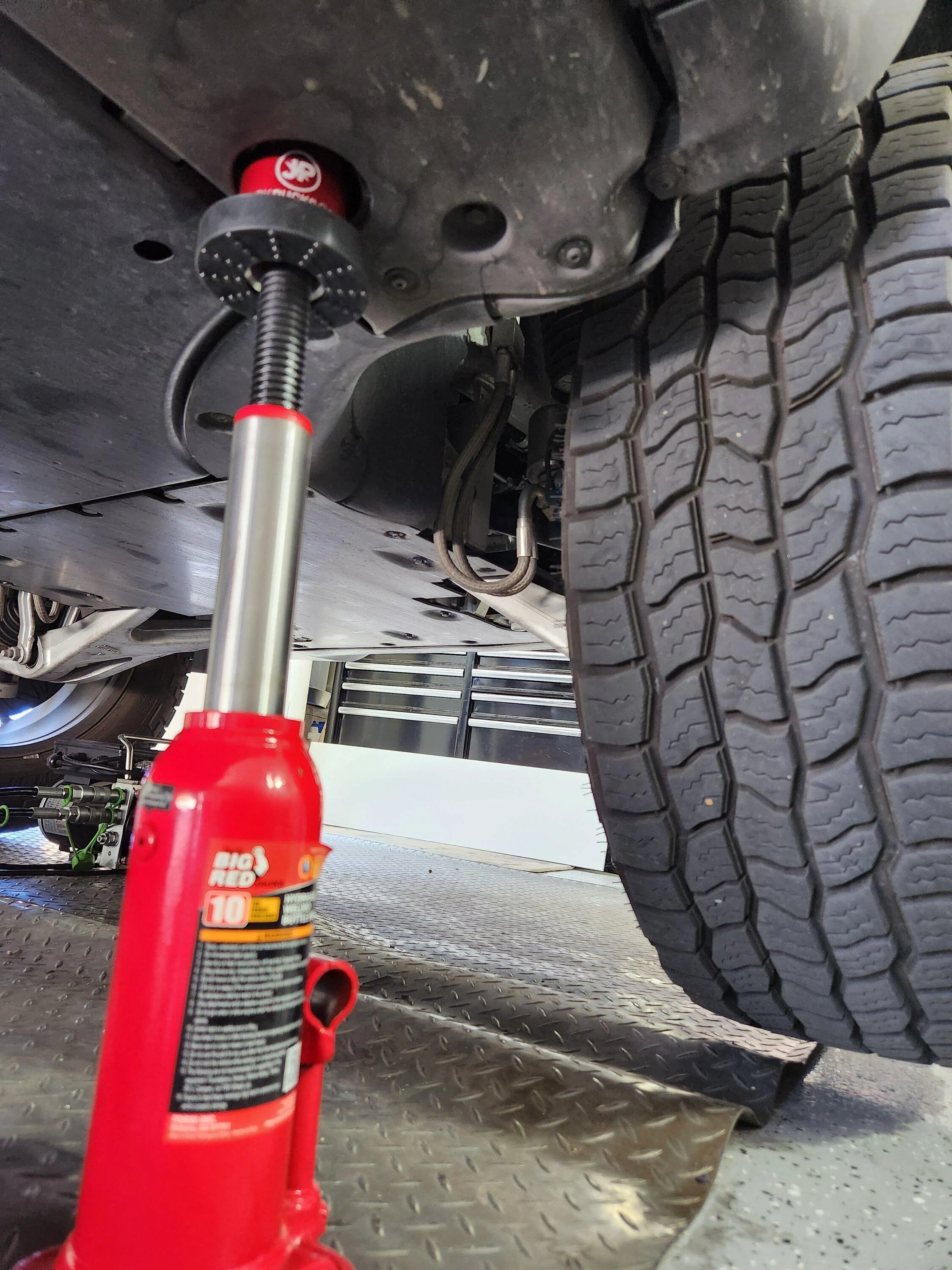

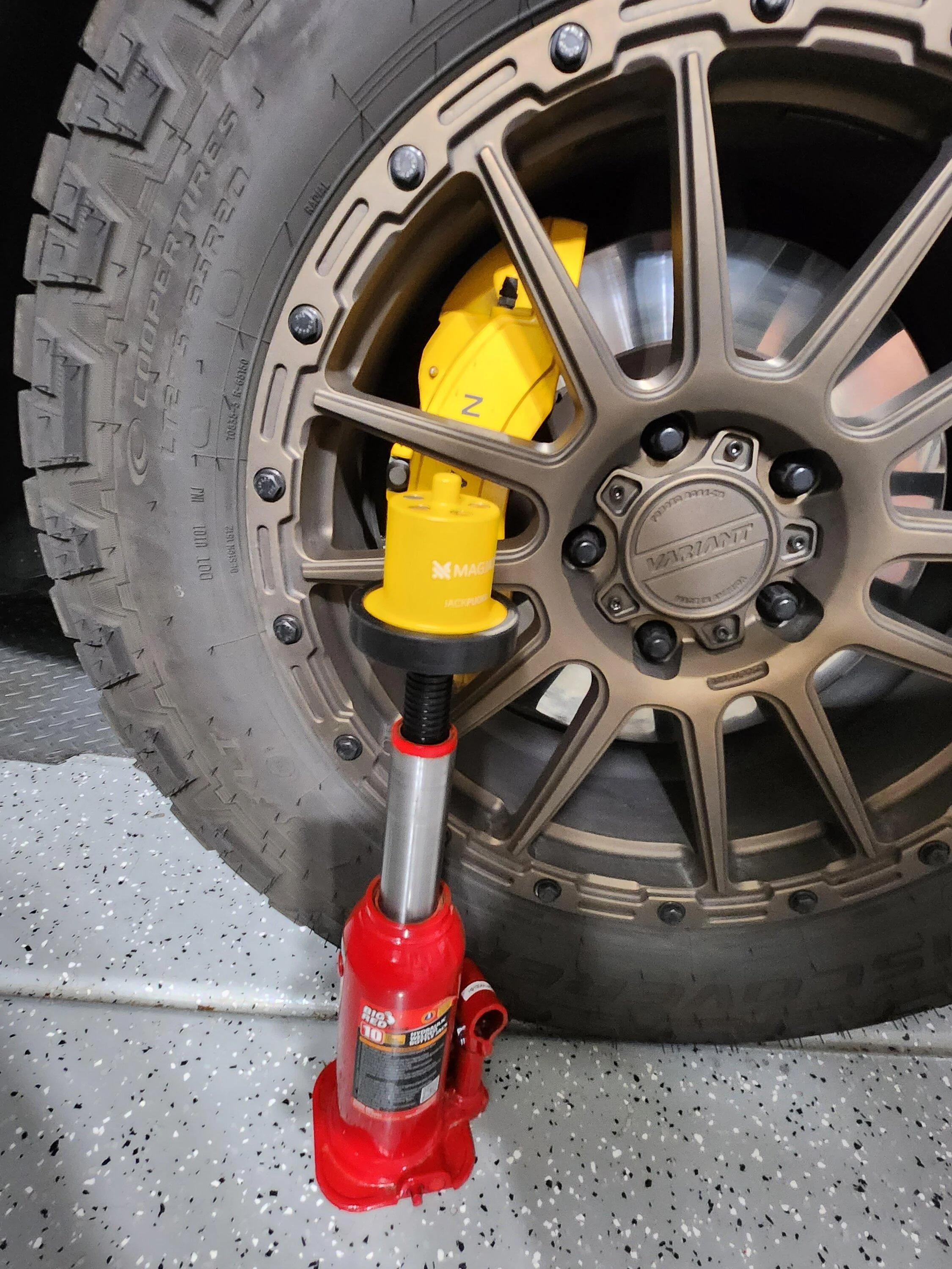

Like a few posters have said, a good plug kit and our Magnetic Jack Puck kit and a Torin Big Red 10T (as another poster said), will save people from a lot of headaches. Most nails, screws can be repaired with the wheel staying on the vehicle.
1. Put vehicle in Tire Change Mode
2. Use the 10T Big Red hydraulic bottle jack with one of our jack pucks and lift the wheel just enough off the ground to plug the tire.
3. Air with the onboard compressor
4. On your way.
If the flat is in the rear position, keep an RV jack plate or a piece of wood in your vehicle for a few extra inches of lift. I've done this once and my customers have done it a dozen times.

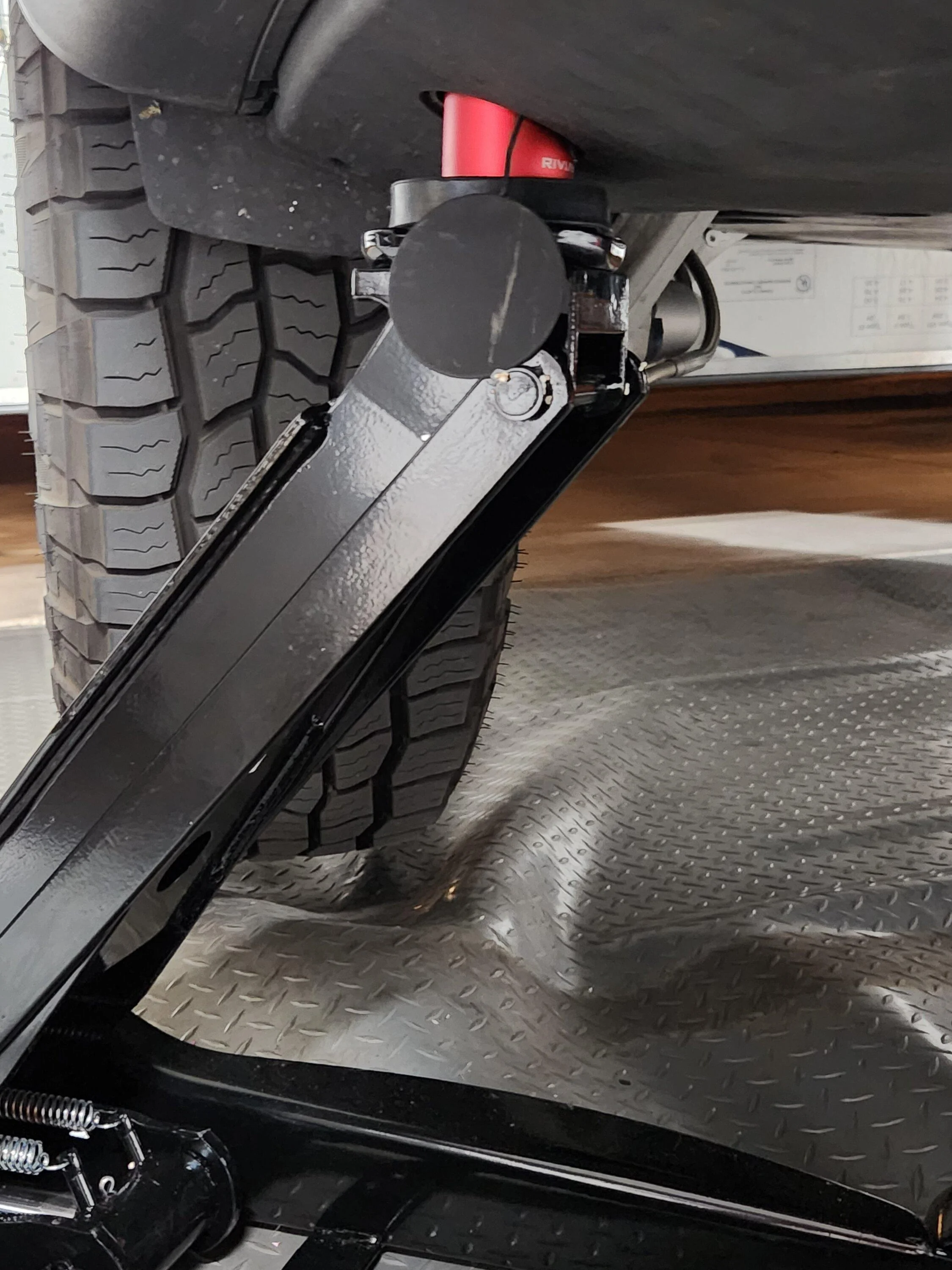

The best floor jack (HF 3T Daytona with 24 1/2" lift)!! Incredible.

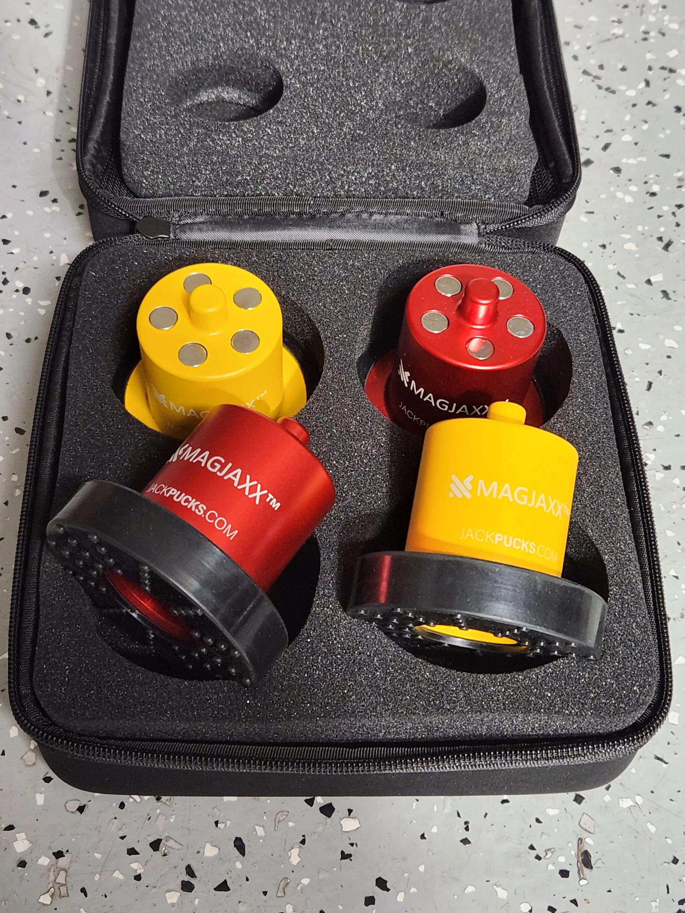

Best jack stand for our R1 vehicles is below. 4T rating, flat on top for our MagJaxx Magnetic Jack Pucks. I'm down to my last couple of kits, but hundreds more will start shipping mid next week including Rivian Yellow :).
