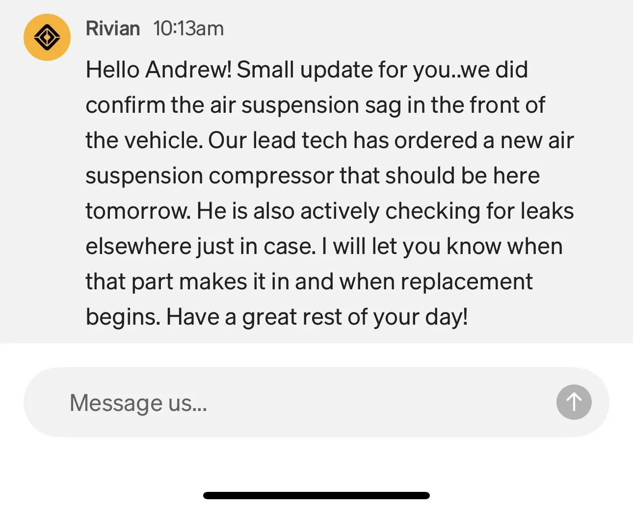

I am glad I found this thread. I am having the front compressor replaced because the truck was on the tires on the left side and almost on it on the right after sitting for two days. I am 7k close to being out of warranty tool
Rivian R1T R1S Front suspension drops overnight IMG_1208
