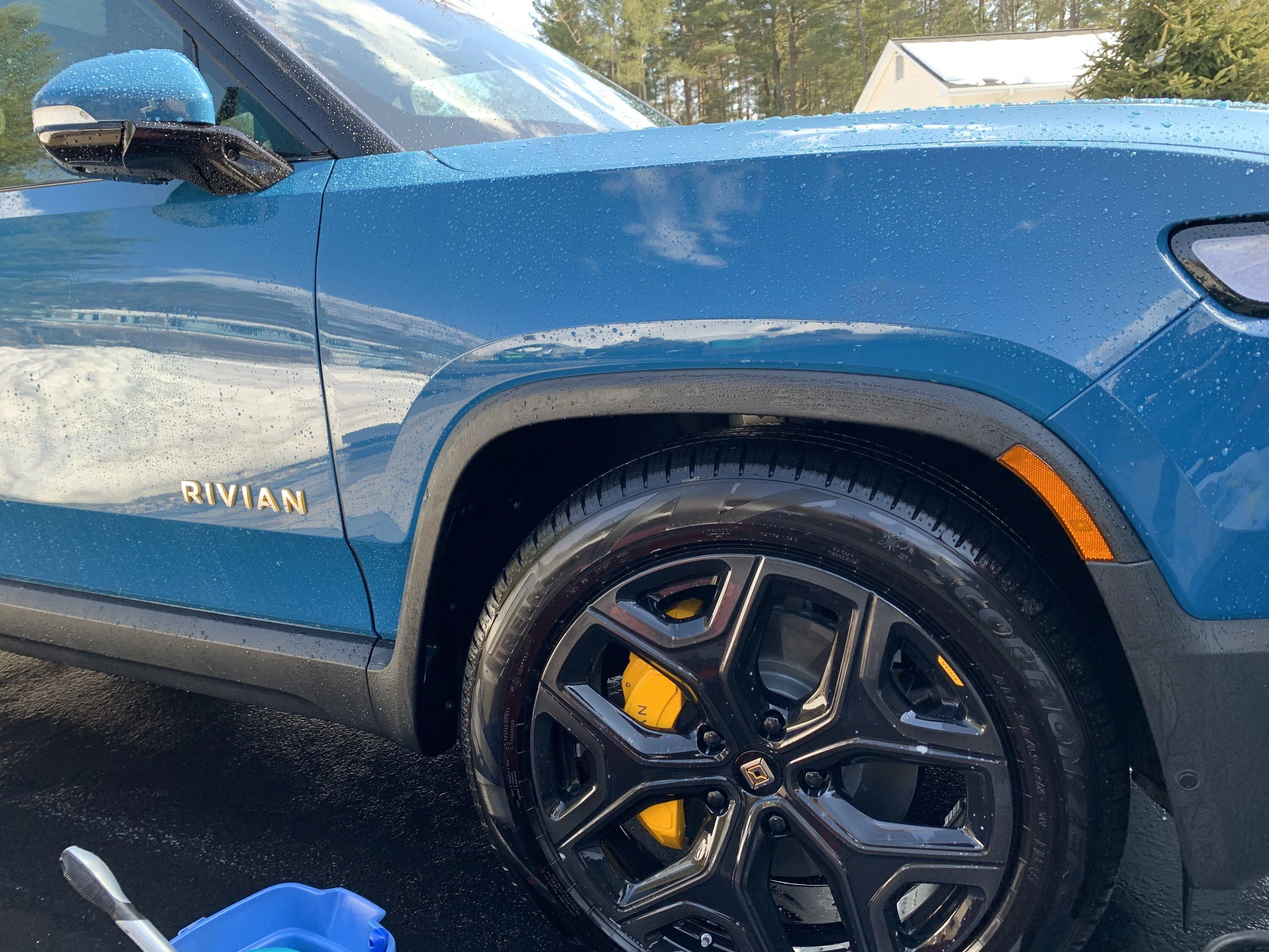

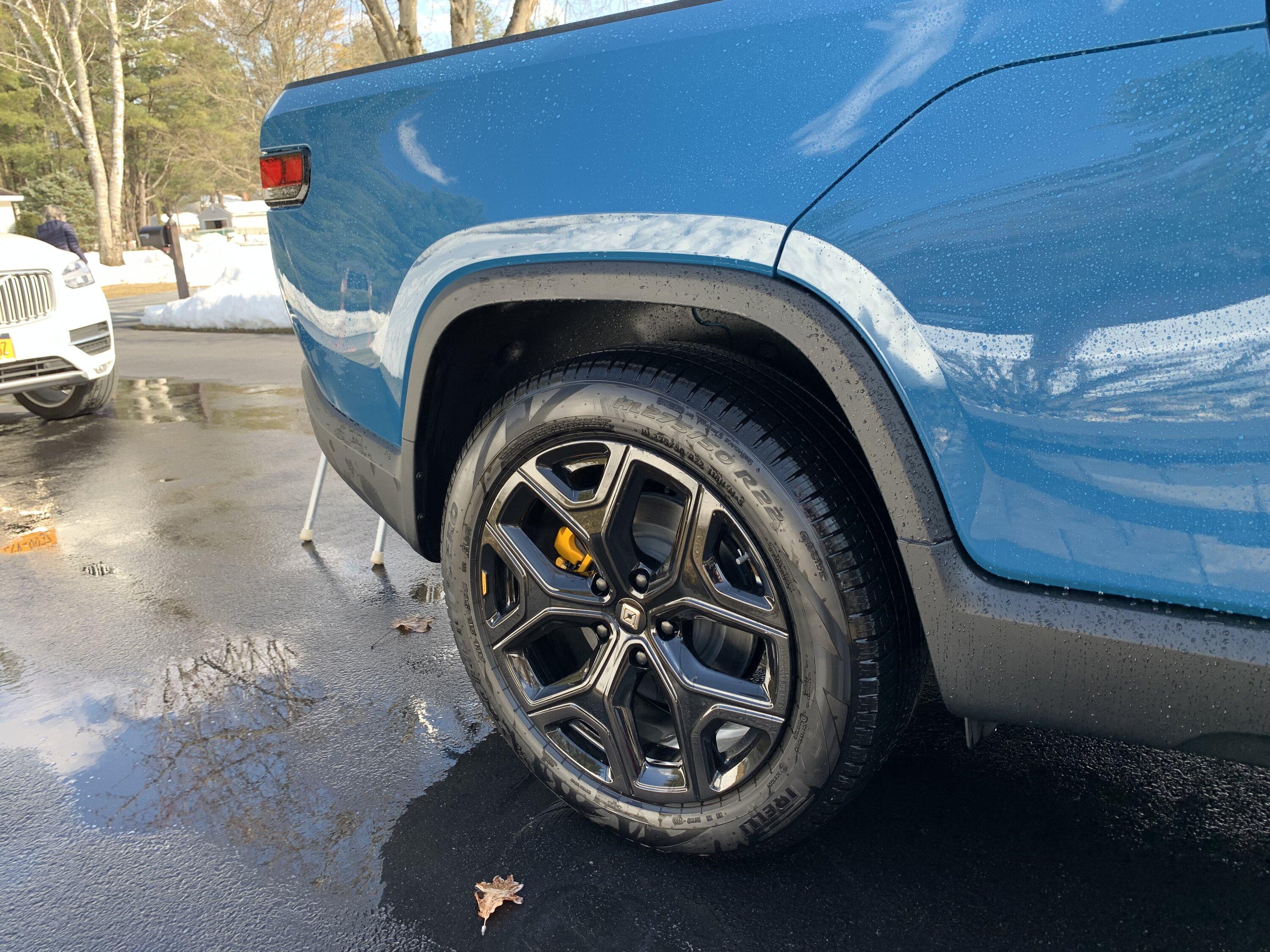

This is what the suspension height looked like when I got back home.

^^^ Looks like the front passenger side dropped?
Scoop
Gary
Apr 18, 2021
New York
Range Rover Sport, Volvo XC90
Yes. This has been going on since last Aug. Compressor runs a lot. They looked at it in Boston and told me “ everything is fine “??? I think the compressor is under sized for a 7000 lb truck.

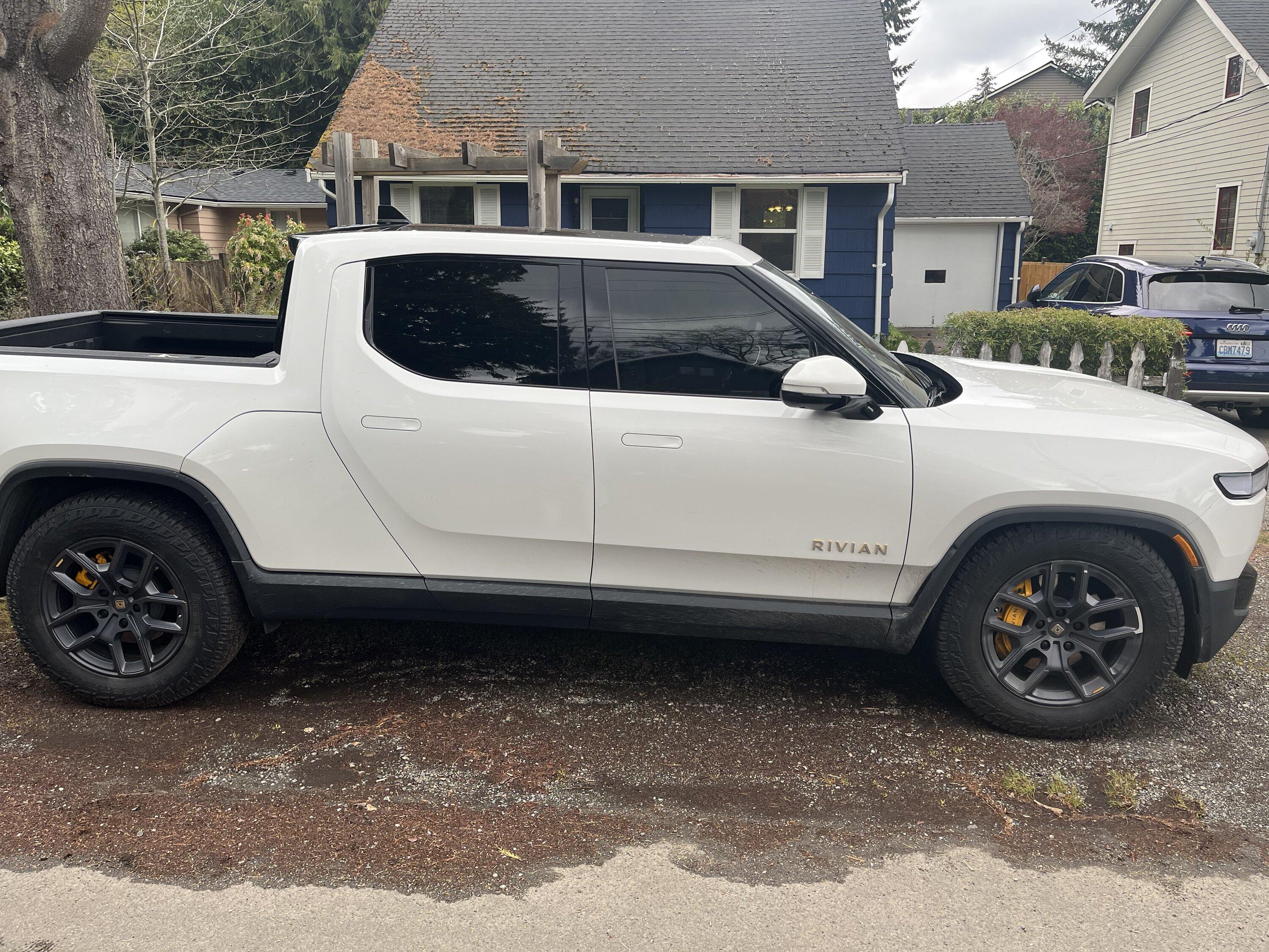

PNWRIV
Ryan
Jun 29, 2022
Rivian R1T R1S Front suspension drops overnight IMG_0850
this was after not driving my truck for two days. Have a service appointment in Mid-June. Hopefully they don’t try to tell me that this is the normal rake of a truck again. ?? I’ve been waiting on this service appt for two months to fix all the crap they didn’t fix from the last time. Extremely frustrating.
