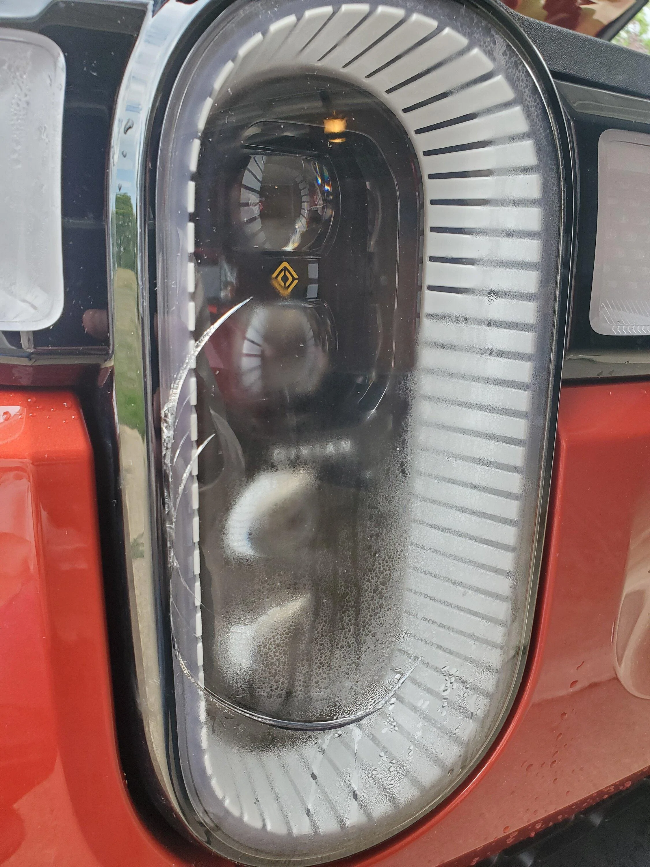

Next week he Minneapolis SC is taking a look at my passenger side headlamp which I believe suffered a spontaneous full thickness fracture with no impact of rocks or birds. I was just driving in the right lane at 65 mph and heard it pop.
I'm an optometrist an have some idea of stress fractures of plastic structures compressed unevenly from the edges.
The material of the headlamp and roof "glass" is most likely polycarbonate (Lexan?) such as is used in opthalmic lenses.
I have seen lenses molded by melting plastic pellets and injecting the liquid into precision molds.
My lens has no scratches or marks of any impact. The fractures are circular also.
I am going to suggest that Rivian received defecively molded parts from their supplier and ask them to move the blame up the supply chain to their vendor.
