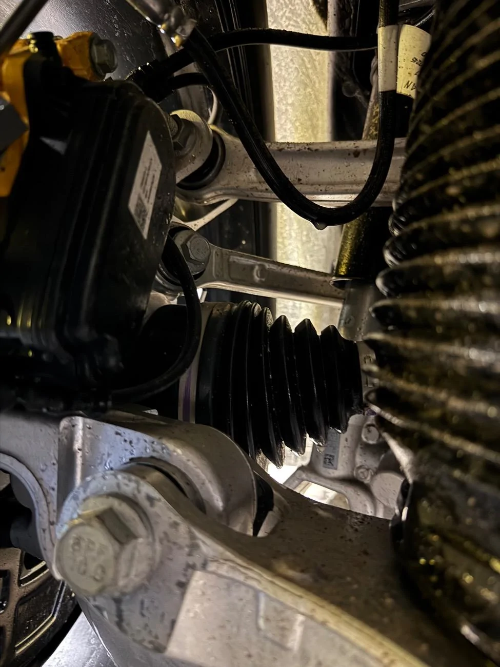

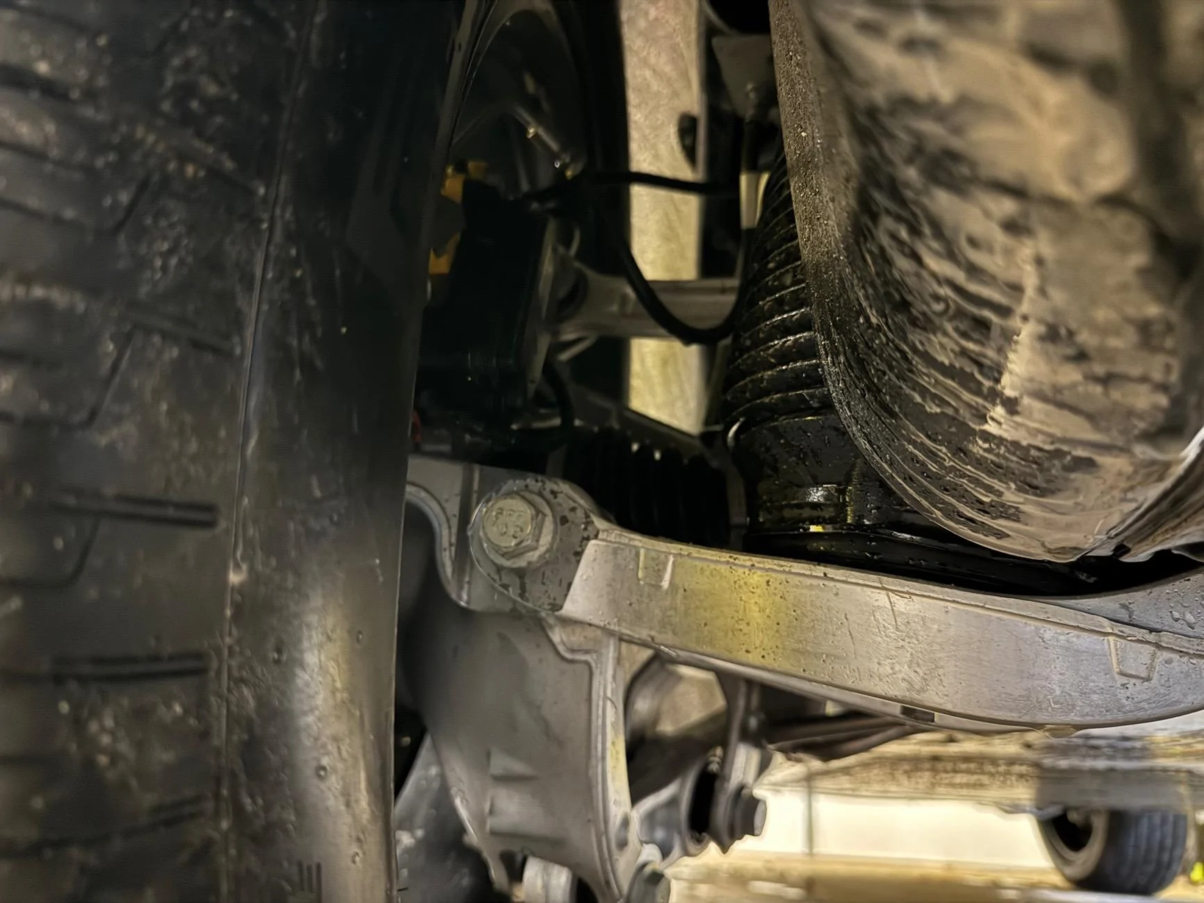

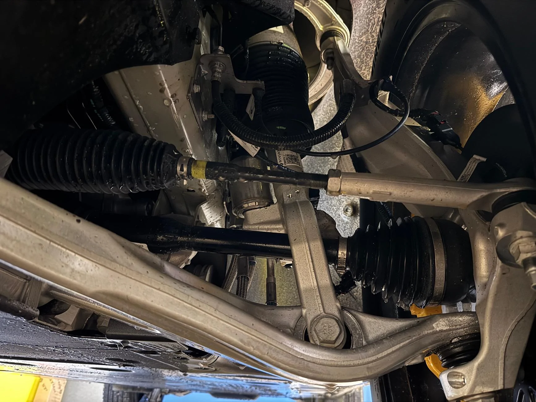

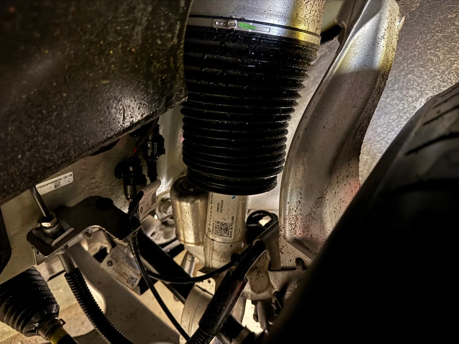

The gen 2 suspension is much better with the noises. I didn't realize how Loud my gen 1 was until I got my tri.
any chance you could snap a few shots of the suspension on your Gen 2 Tri, front and back wheels? That may elucidate some of the differences.
60
8,397
16,873
2026 Ram RHO, 2024 i4 M50
I don't know much about suspensions, so if you want a different angle or something, I can do my best to accommodate.
thanks….i’ll spend a little time analyzing those shots. I may be able to determine if there are some Gen 2 suspension mods already in late Gen 1s.

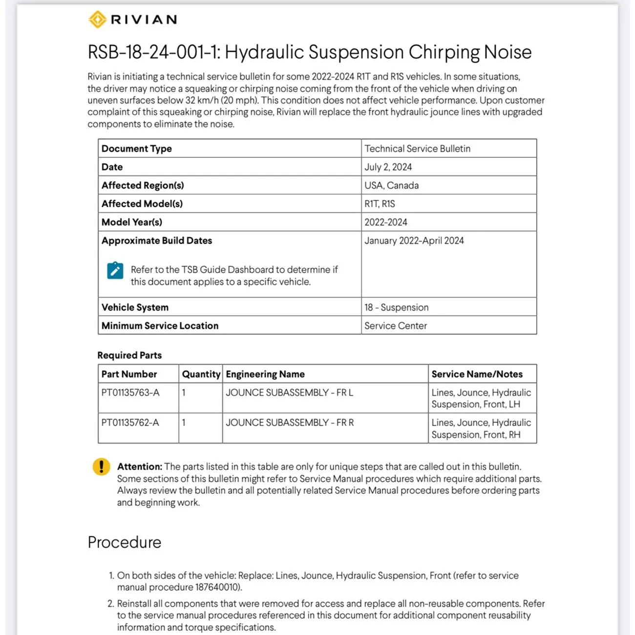

ok, I found Rivian’s official bulletin for the chirping suspension issue
Rivian R1T R1S Gen 1 Rolling Suspension changes IMG_3360
anyone who requests this fix should get their front air springs updated by Rivian under warranty. However, they say nothing about the rear air springs but it sounds like you got those replaced as well. Since Rivian’s primary suspension upgrade on Gen 2 is a redesign of the rear air springs, those are what I’d like to have retrofitted (assuming they’re actually using the new Gen 2 part on Gen 1s.)
@jpmc86 if possible, could you take a look at the Gen 2 suspension photos that Donald just posted and see if your replacement air springs match?
I just put in a service request for this suspension update. I guess I’ll find out if there’s any improvement in March when they do the work.
