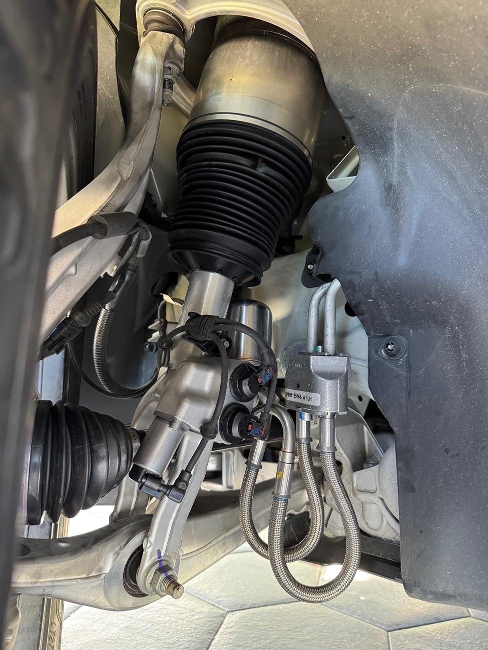

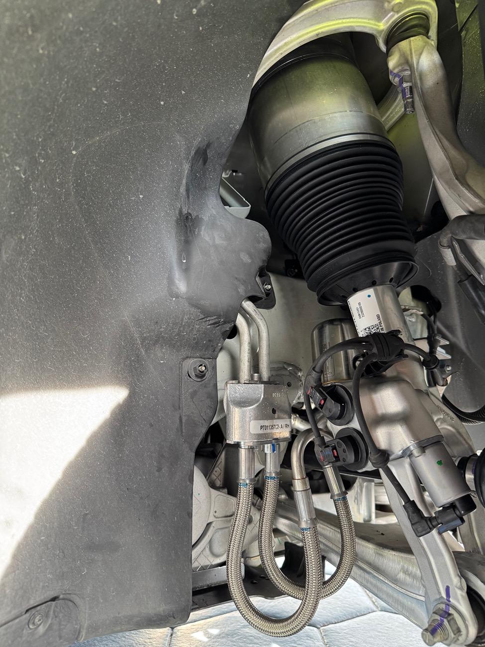

On mine, when they replaced the front ones for new ones (they were noisy and used the gen2 revised PN’s) I said I would not want two different style struts between front and back so I spoke to a manager to match the front with new rear ones so that the car was uniform. He agreed.
Pic of the new ones, you’ll see how the boot tapers down (gen1’s don’t have a taper).
Rivian R1T R1S Gen 1 Rolling Suspension changes IMG_2919
Rivian R1T R1S Gen 1 Rolling Suspension changes IMG_2920

thanks for that! The taper and lack of white plastic is also what I noticed on the newer dampers. They’re just replacing the dampers (the top part with the rubber boot,) and not the air spring which is below, correct? If so, do you know what the part number is for the just the damper?
