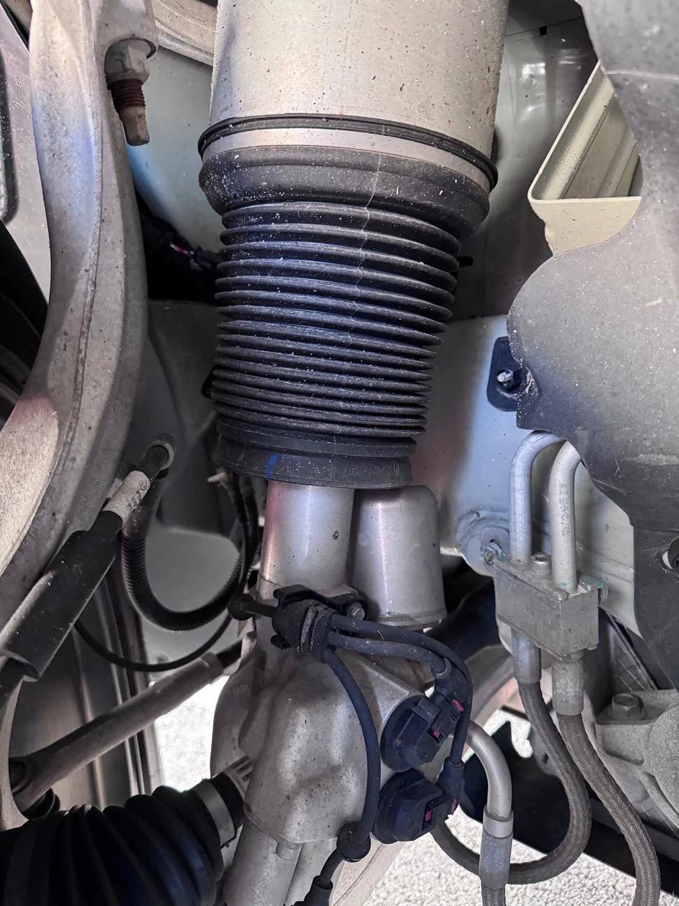

Don’t have the new Jounce line either.
Rivian R1T R1S Gen 1 Rolling Suspension changes IMG_4265
