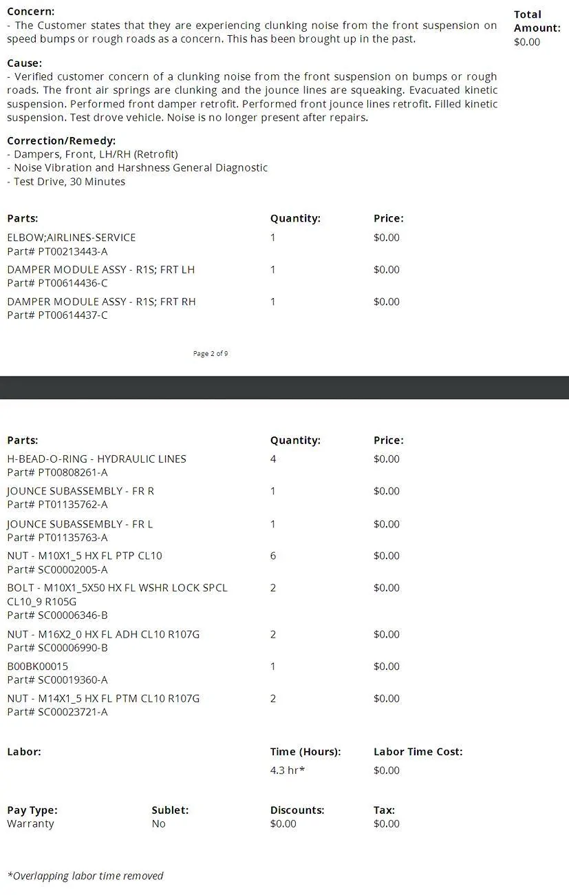

I just had my R1S serviced for the first time. I mentioned to the tech that my front right tire had little clearance when parked. Lo and behold, the tech determined there was a leak in my air spring so they replaced my entire front suspension (dampers, air springs, and jounce lines.)
My 2023 R1S originally had what seems to be the oldest version of the front dampers:
Right: C100055320-A
Left: C100055318-A
The replacments they installed are the ones that were used on the 2024 R1S:
Right: PT00055320-C
Left: PT00055318-C
The air springs my car came with were:
Right: C100055319-B
Left: C100055317-B
They replaced them with the 2024 version:
Right: PT00055319-D
Left: PT00055317-D
Since the dampers and air springs are fitted together into one piece, Rivian has one part # for the entire assembly:
Right: PT00614436-C
Left: PT00614437-C
While I think the rear dampers likely make the biggest difference in ride quality, the next generation front dampers/air springs do subtlety improve some ride characteristics like vibrations, bounciness, etc. Nice to have them, especially for free! (Would be around $6K to have this done out of pocket.)

I just got new dampener for both sides / retrofit and new jounce lines / retrofit.
It does sounds better along with new halfshafts and hubs.
I am currently at ~ 28,000 miles on my Quad Motor June 2023 build R1S.
I appreciate Rivian and my local service center taking care of this concern.

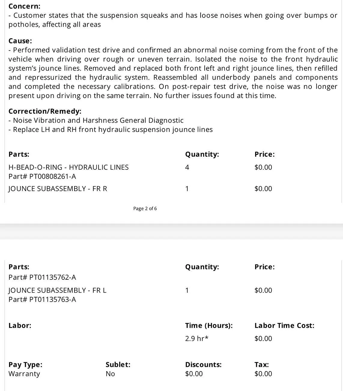

Thank you to everyone here for all of the information.
I had my truck since July 2022 and many countless attempts of getting them to help resolve ... with many responses of it's normal, can't hear it etc. and finally today it's replaced/resolved.
They didn't replace the shaft or the dampers but at least happy that there's acknowledgment I'm not crazy and hearing noises.
They didn't replace the shaft or the dampers but at least happy that there's acknowledgment I'm not crazy and hearing noises especially just about before my warranty expires (am at 34k now and July is about couple months away).
So the suspension noise you were trying to get resolved this whole time was the jounce squeaking?
This has been a known Gen1 issue for a long time and they have a new subassembly that improves it about 90%. That baffles me it took so long to implement a known fix for you.
r1tshivermetimbers
Richard
Jul 8, 2022
103
2022 R1T LE .. Vin#65xx
Yeah I'm baffled too. And yes the jounce really made a difference. I don't have the clunking noise, maybe some but not noticeable unless I'm looking for it. I tried to get them to update the shaft and dampers but they ignored it since the technician didn't hear any clunking noise.
