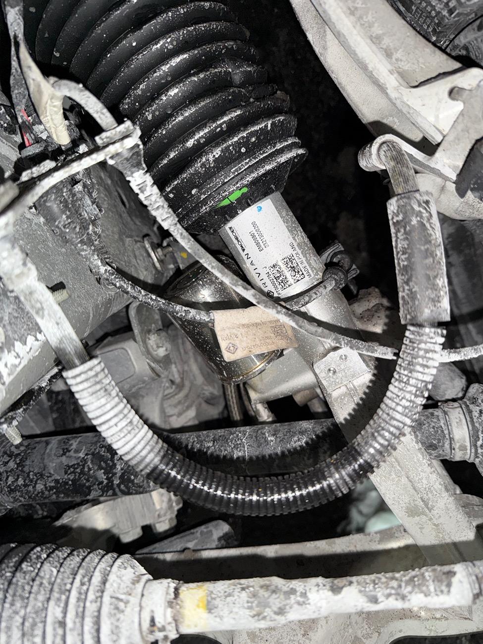

can you take a photo of the part # on the front damper? Curious which one they installed.

It is in my post - the part numbers are part of the service record.
it shows the part # for the entire assembly which includes a number of individual parts including the dampers. What I’d like to know is the actually part # on the damper itself.
Ahh! Sure here you go.
Rivian R1T R1S Gen 1 Rolling Suspension changes IMG_2802

Thanks, you have the 2754-J dampers. I originally though the 2754s were early Launch Edition dampers but it's clear now that the R1Ts have a different part # for the front dampers.
There are some salvaged 2754-G on sale on ebay:
https://www.cafr.ebay.ca/itm/167132521218?_trkparms=amclksrc=ITM&aid=1110006&algo=HOMESPLICE.SIM&ao=1&asc=20231207125618&meid=41d97f5c5a5d430dac22c9c9051b06b1&pid=101875&rk=3&rkt=3&sd=166837368333&itm=167132521218&pmt=1&noa=0&pg=2332490&algv=SimplAMLv11WebTrimmedV3MskuWithLambda85KnnRecallV1V2V4ItemNrtInQueryAndCassiniVisualRankerAndBertRecallWithVMEV3CPCAutoWithCassiniEmbRecall&_trksid=p2332490.c101875.m1851&itmprp=cksum:16713252121841d97f5c5a5d430dac22c9c9051b06b1|enc:AQAJAAABcEnLatTXWXNAKPRnYtxVTXN2rJD11TMrqd%2Bc4NcqE%2BNGk6ejyqiKoKTZm%2BWiG7rLUKnmQT96yLmgza78VpCainYj%2Fcd7BbF%2F3JO7HSXt2n3iFYDbns8rSMT0idXbcmlMHWKniLK2o5tYYPmM8KWpVo95tWt2nTiQXMqmKRIMl5gAplMB1Ggx6kVqfXRetLAgGF2XX7tTPRiZ3ZP0u9n1wajOb5jWBqD1HYRmI52mUDIYWo3WBJMPLaSHeWs4sLj51ZTA3WsAm5FSbZL%2B99Rm53P7vJDidUOlUmXDstp3lLX6J4pOJRmcHvQpvGX4IIH9rbrVX4LTxhi9us550hMSjs9iBtqR0mgEprG%2BCvCgORpVzQUZrmPSTCn9kNWq0Mcqg5jNVTMJbkraDg4Y21wkj3PzE9yRTniVNICKnzVtVH8jOjOQ%2BdmwtqvtM%2FyYdHxqs3uFgXqkoXbMHqNkkVcebPFCL%2BXFRaFeNlqRJtM1QcMn|ampid:pL_CLK|clp:2332490&itmmeta=01JJ39M6Z4KAKJSPCXQAFEEZWM
They advertise them for both R1S and R1T, but it seems like the R1S front dampers are always 5318/5320 and the front R1T are 2752/2754.
I'd be curios to see a photo of an original from damper from a 2022 Launch Edition R1S. Can anyone provide that?
