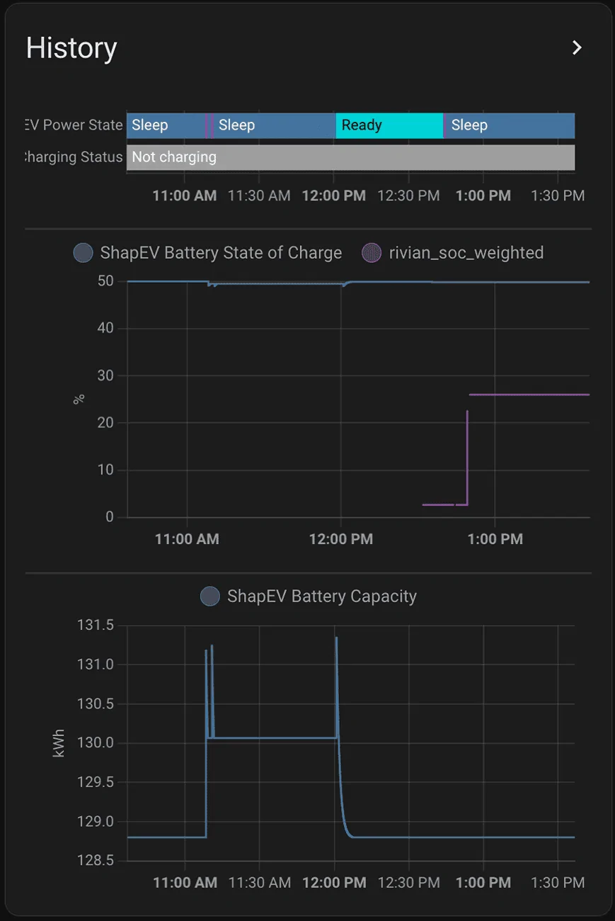

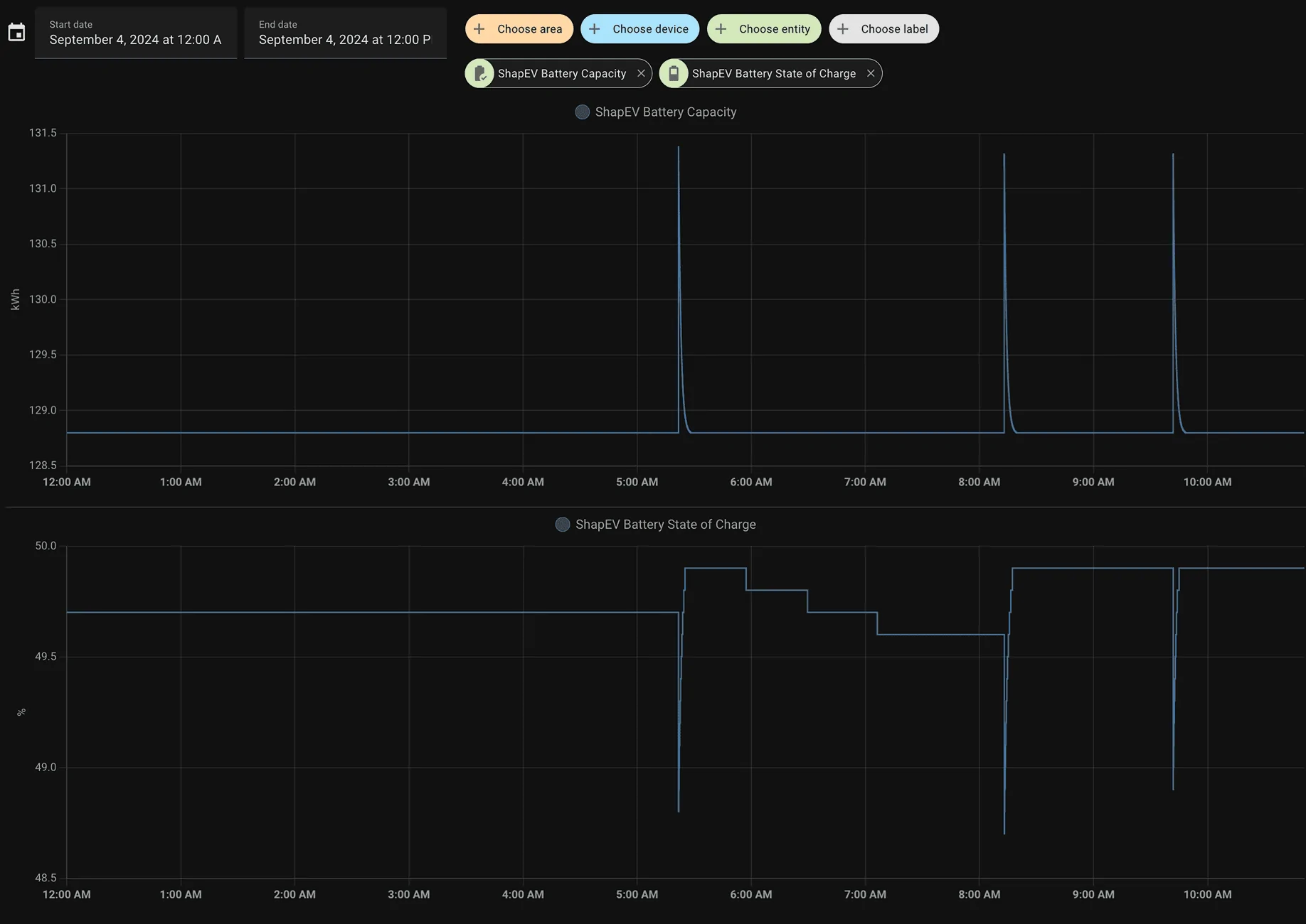

BTW, what I see is something else that started to happen with the update (not the very last one that I still waiting for) :
While SoC is going down sharply, Capacity is going up sharply. They changed something in how BMS is managing the battery and we see all these anomalies.
I added a new sensor to Home Assistant - Capacity / SoC - to see if this proportion changes as well. I think it is a better indicator of phantom drain for now.
