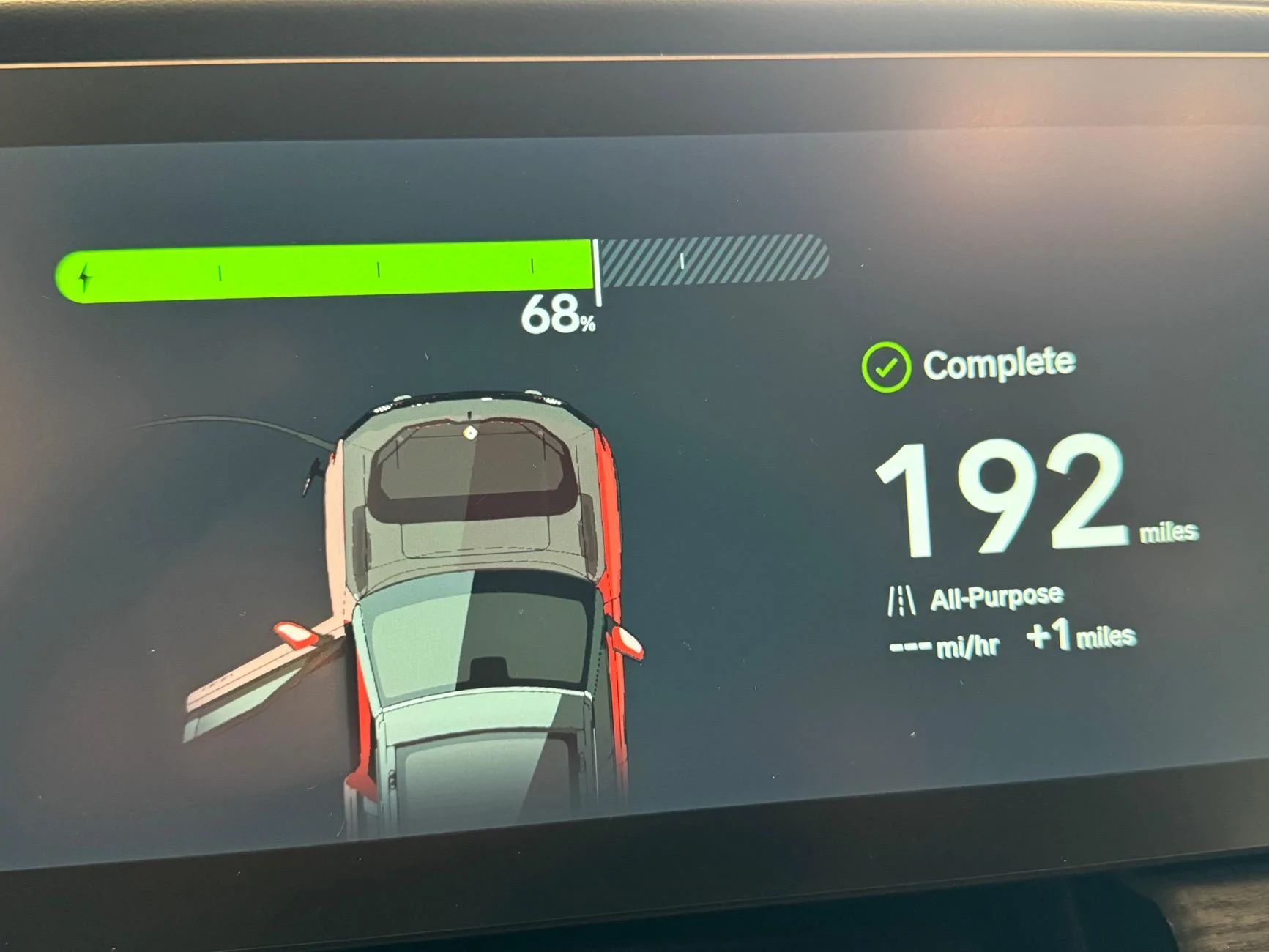

Not back with my car yet (I’m in HNL for a layover), but check the car status and woke it up since it’s been 21 days/3 weeks. :
8/9/2024 to 8/30/2024:
SOC 69% to 68%
0% loss over 2 weeks
1% loss over 3 weeks
*I did accidentally charge the car a few days ago for 3 minutes @ 240V and 40 amps. SOC stayed at 68% and car added 1 mile of range per the app.
Will provide additional photos and details after I get home.

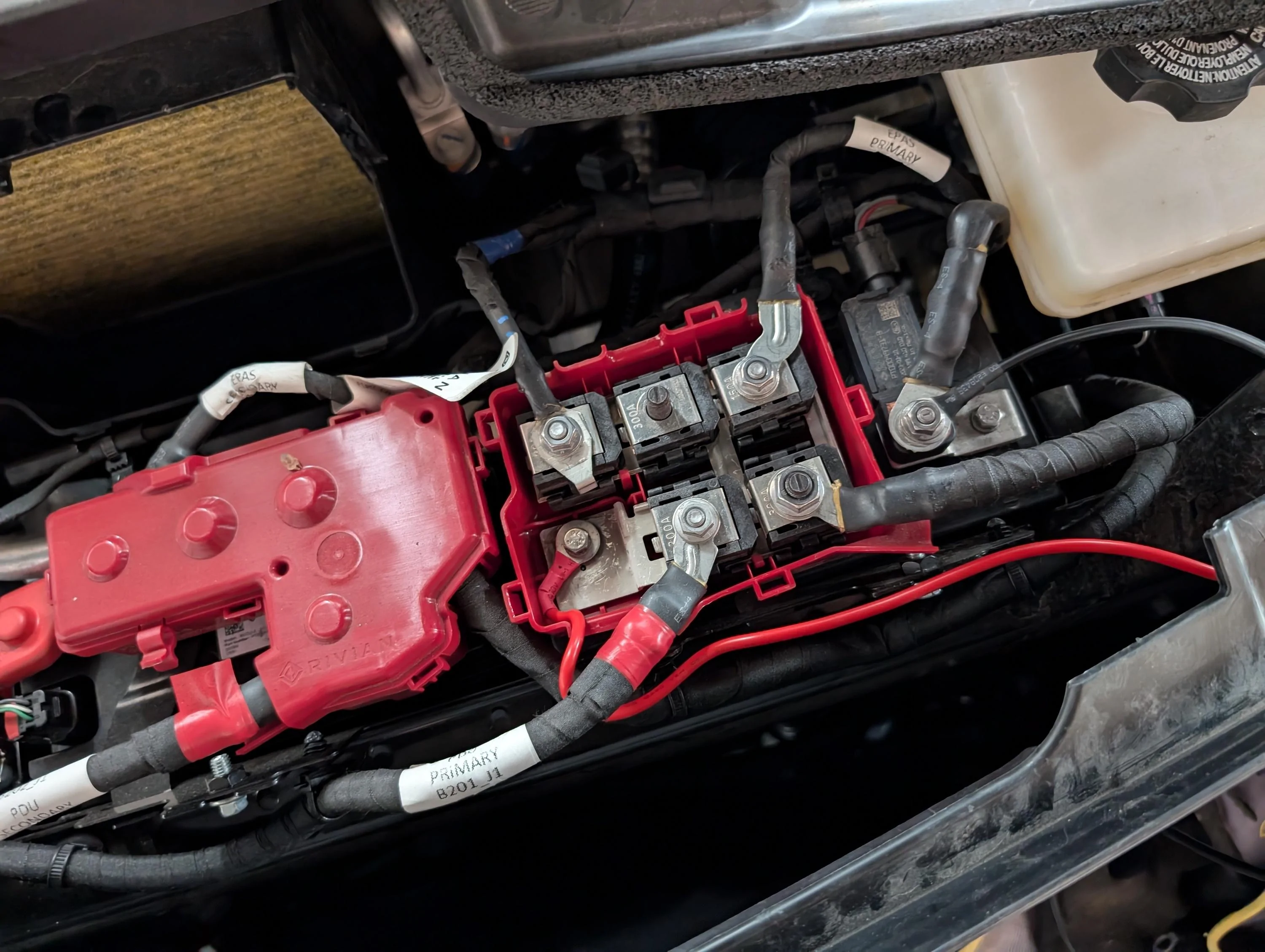

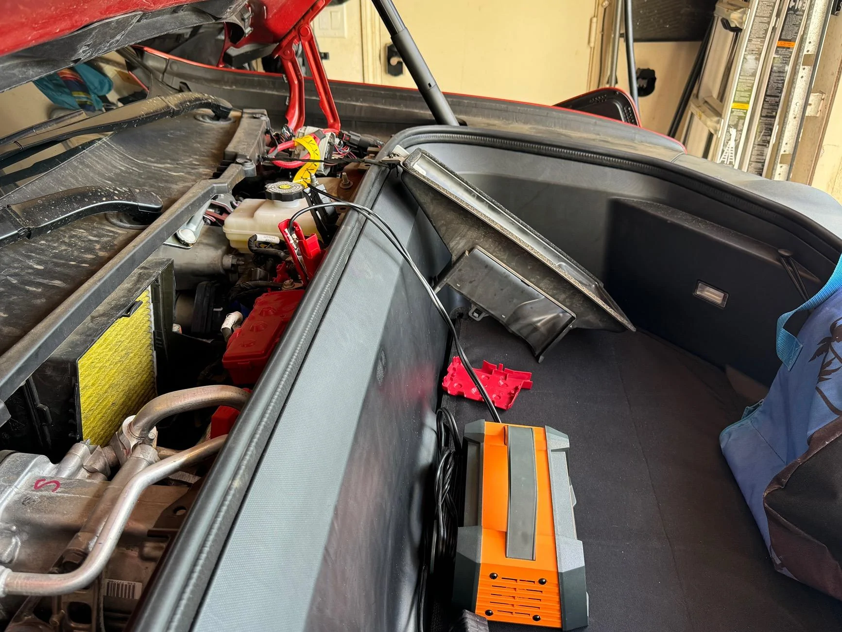

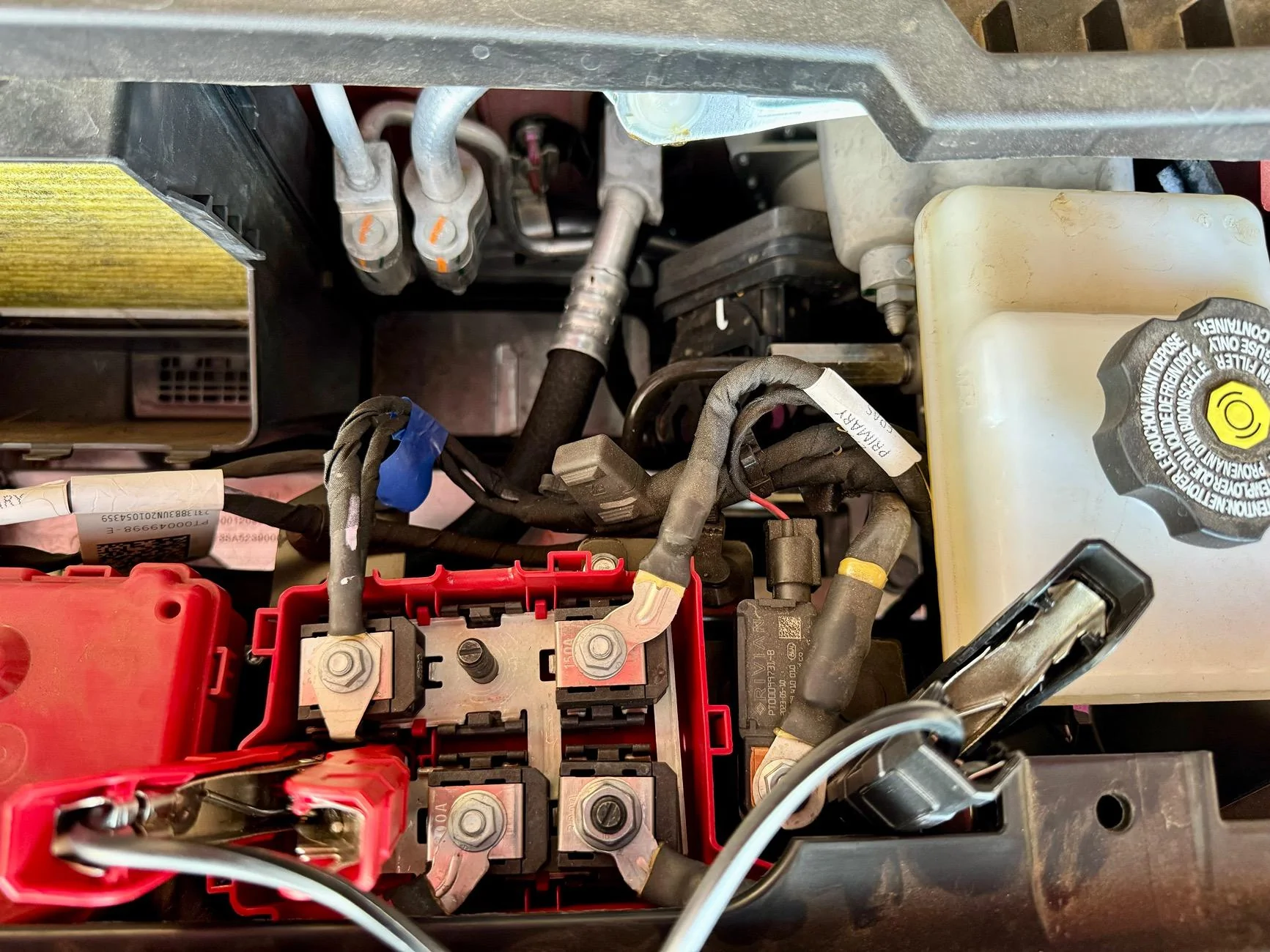

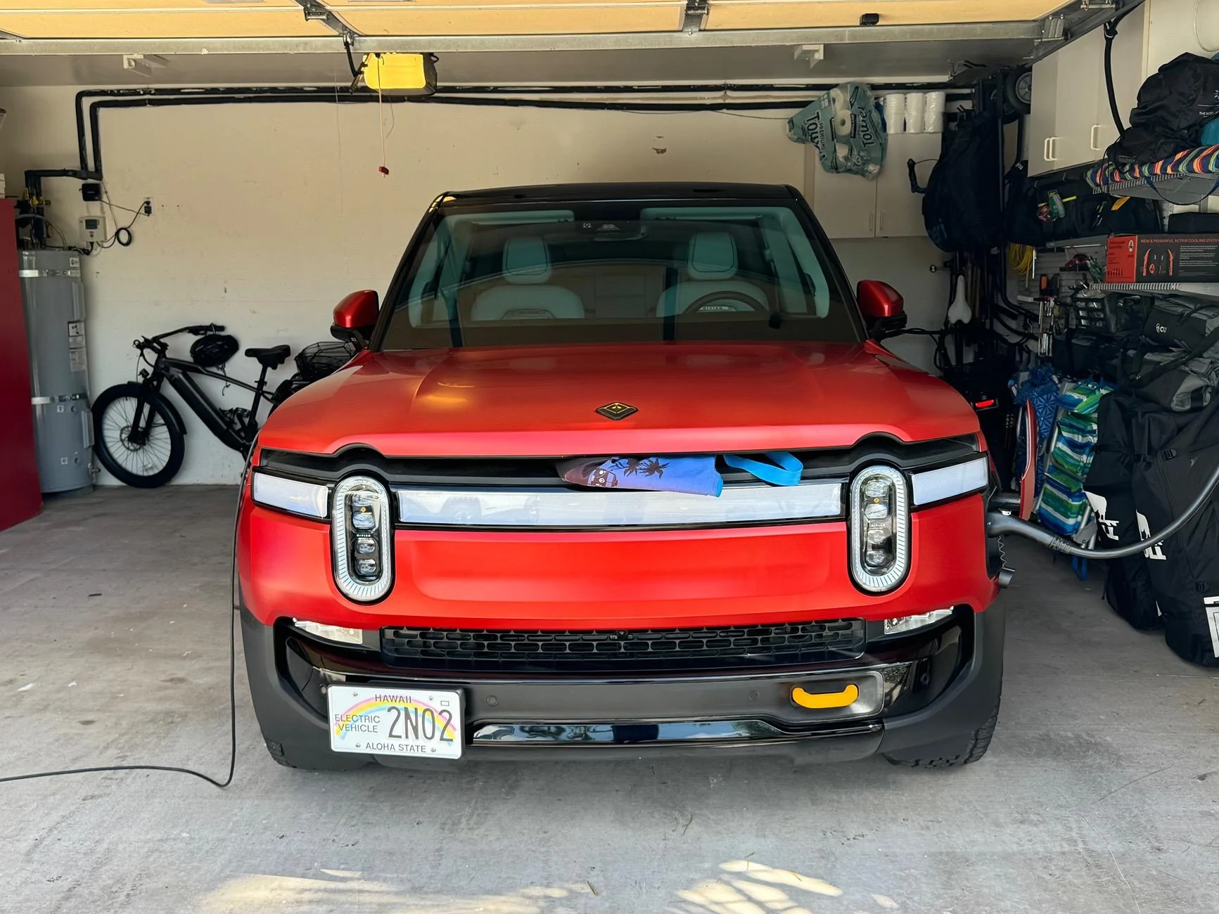

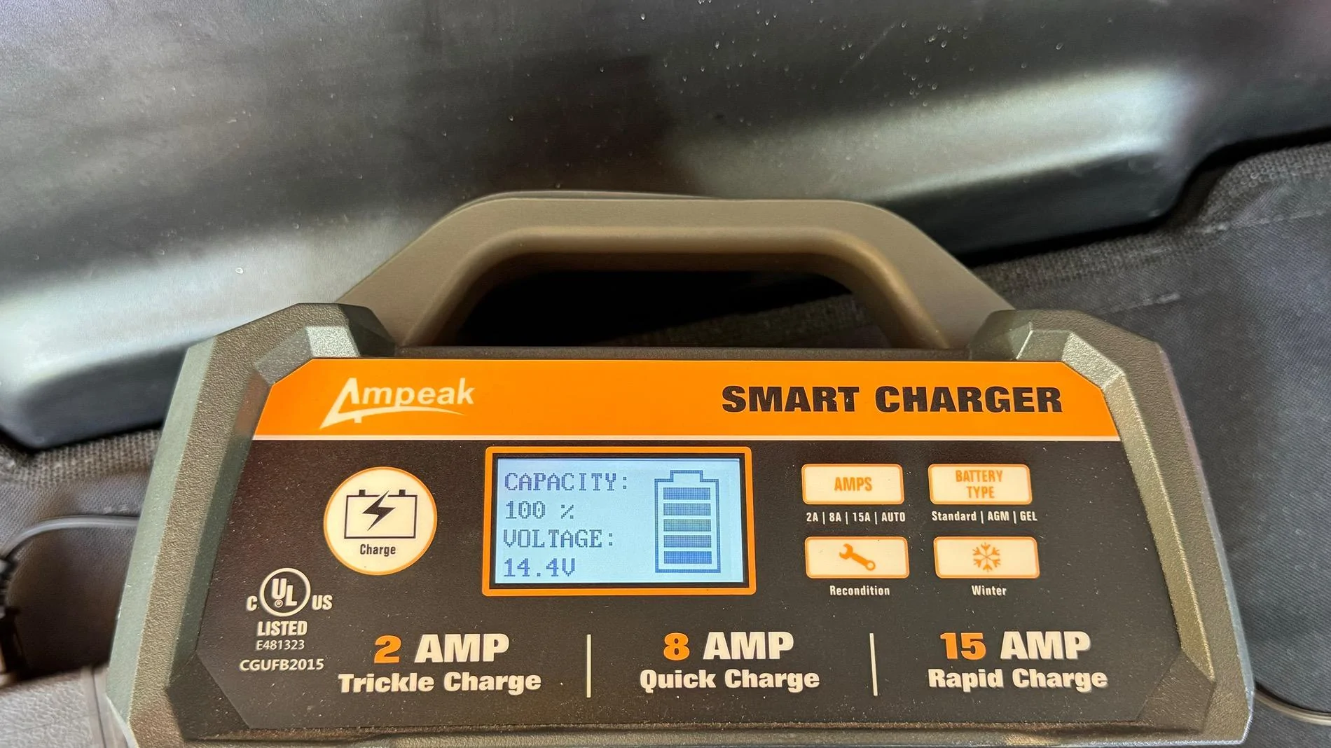

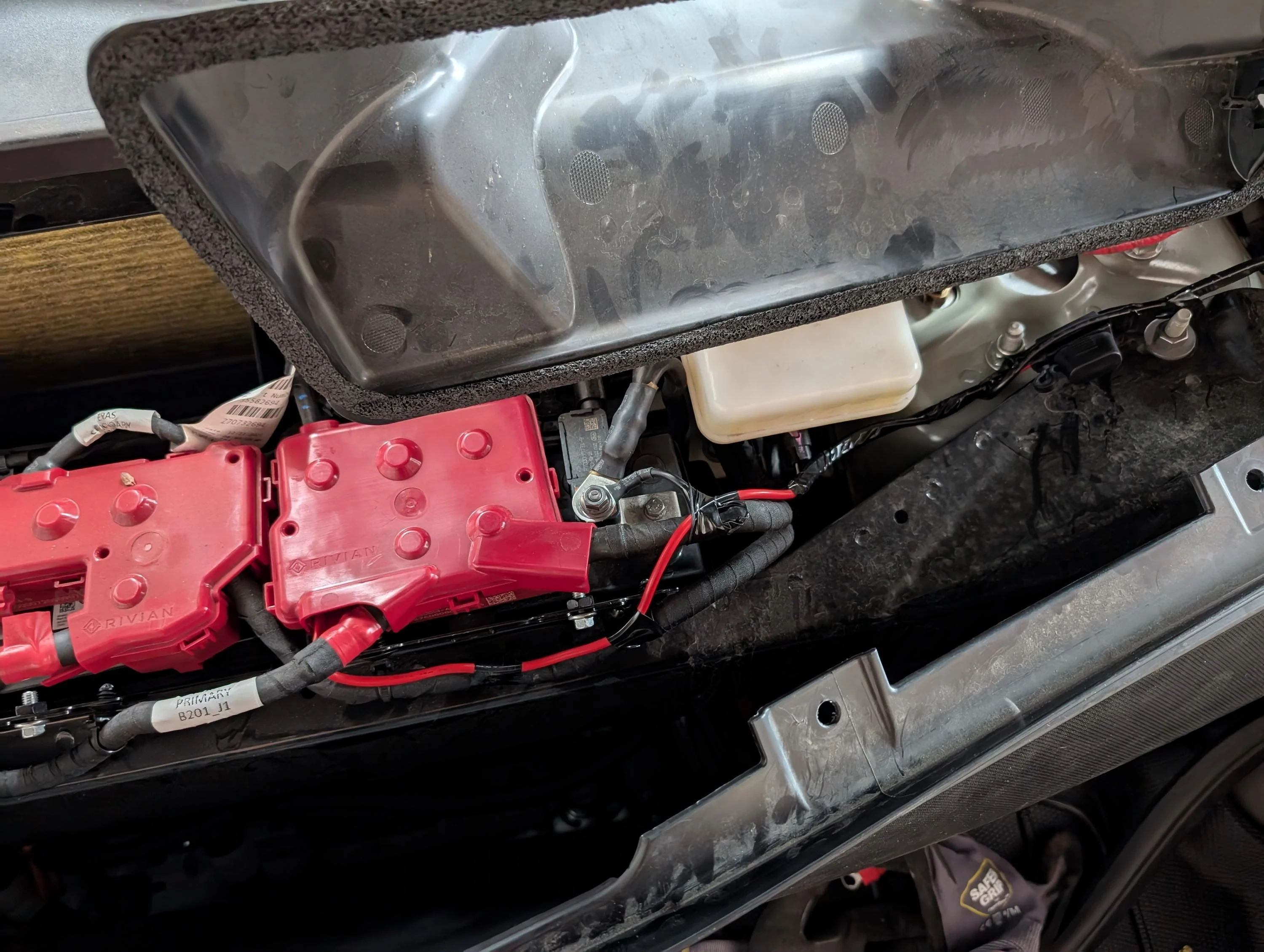

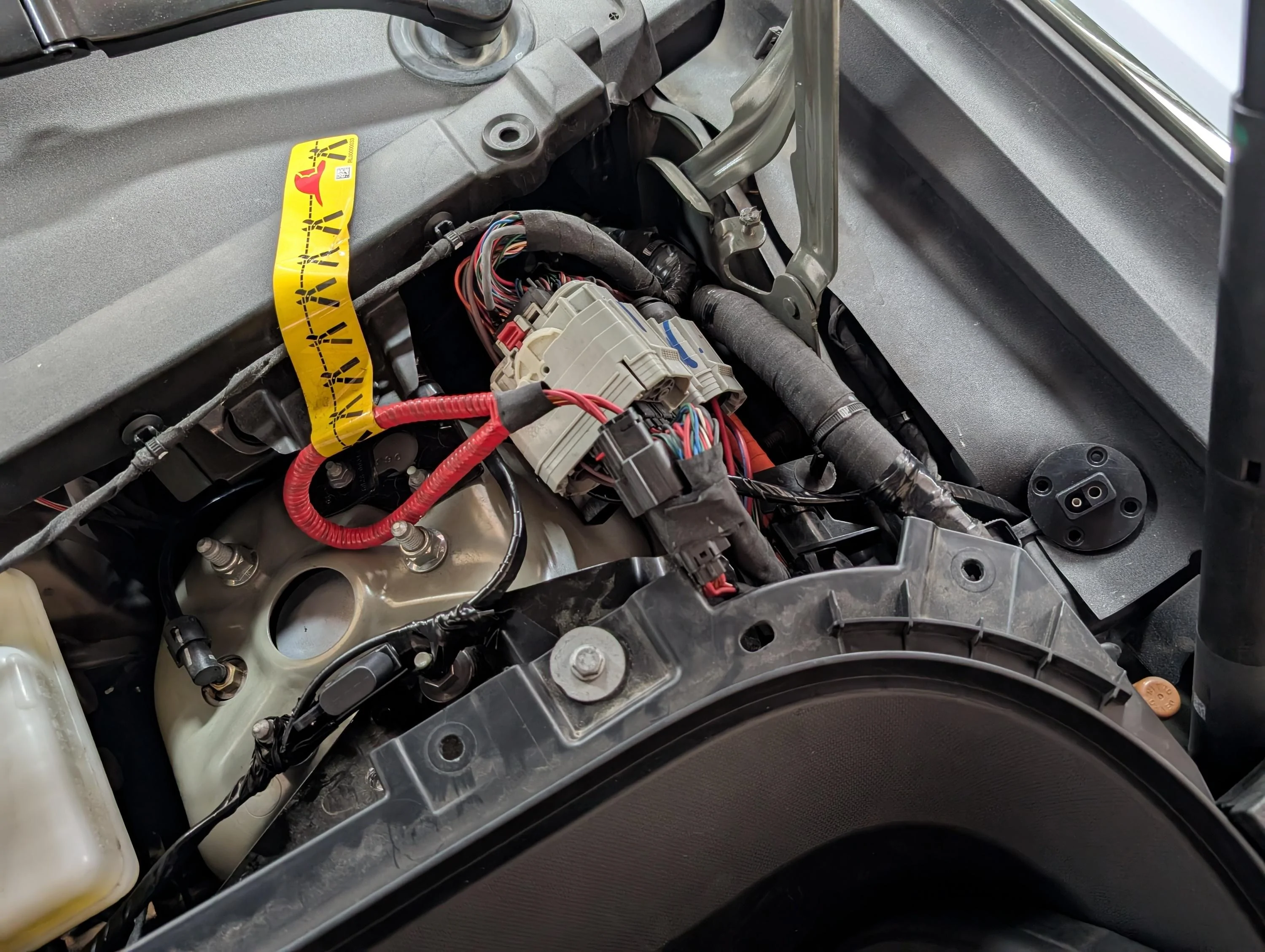

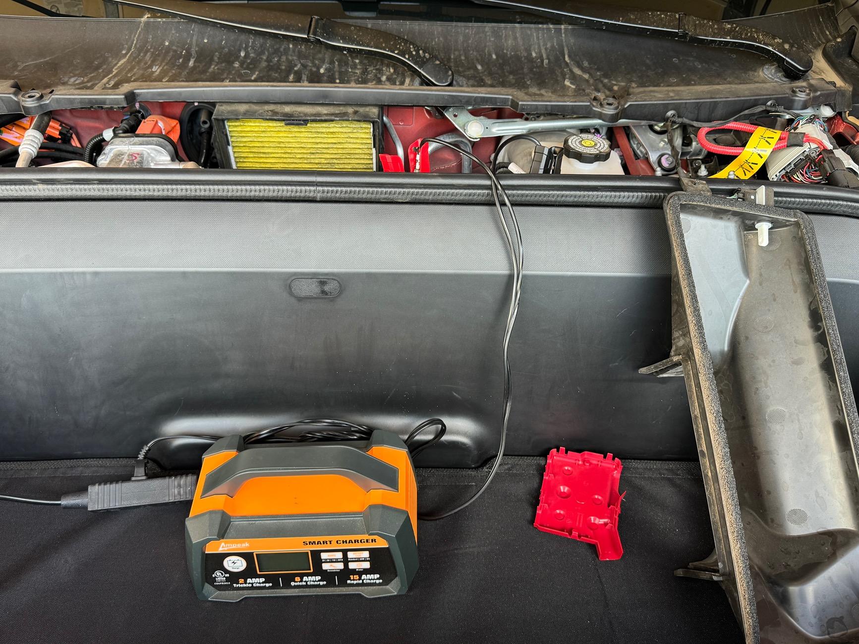

Experiment officially done. Battery charger disconnected and car is ready to be driven!
Final Results:
3 weeks/21 days (and 510 hours to be most precise):
1% loss total
0% loss in the past 2 weeks
*latest software update downloaded over LTE during this period. I think it caused the 1% loss
** I accidentally charged the car for 3 minutes a few days ago at 240 V and 40 amps. App said 1 mile of range was added but SOC stayed at 68%
Gen 1 2023 R1S, Large, Quad
Shipping Mode
Proximity Off
WiFi Off
Bluetooth Off
Gear Guard Off at Home
Data and Privacy - all off except for location
AC off
Software: 2024.19.04 (Not the latest with Connect+)
Photos below. I didn’t close the frunk all the way because I wasn’t sure it would close with the battery leads attached. I made sure it would not latch by putting a grocery bag over the latch in case something went wrong and I needed to access things.
I’ll check the usage of the battery charger when I head back to the mainland.
This was wildly successful for me. Hope others can benefit. I’m most curious about how much electricity the battery charger is using and if the latest software update will make any difference.

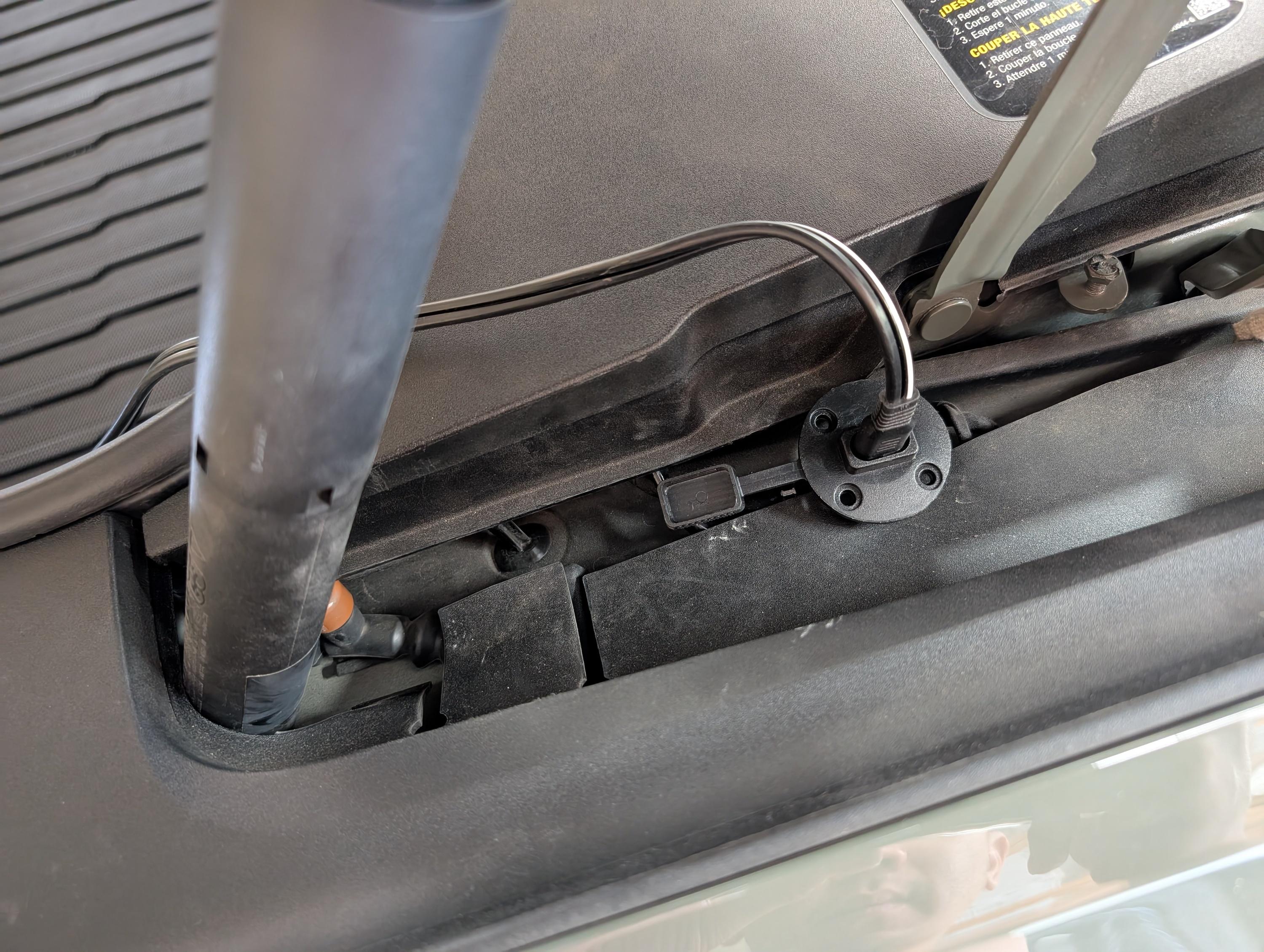

For the single battery R1s I am going to do a test with feeding the charge into the 7 Pin Trailer plug. https://www.amazon.com/gp/product/B0CMDJRBDB/
I’m waiting for the results. As I understand it, one could connect a charger to the pigtails by the trailer hitch to maintain the single battery on my ‘23 R1T. Using a 7 pin adaptor to the trailer plug would be even cleaner.

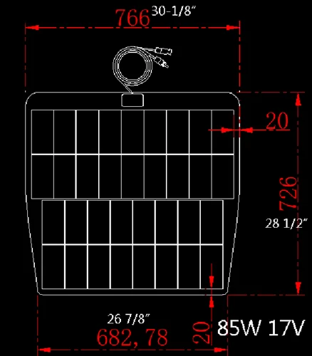

I got the actual dimensions of the Lensun solar panel for the Rivian hood. We could definitely fit something larger, but I’m not sure anyone makes anything of proportions that would look better. Strongly considering buying one to test out.
