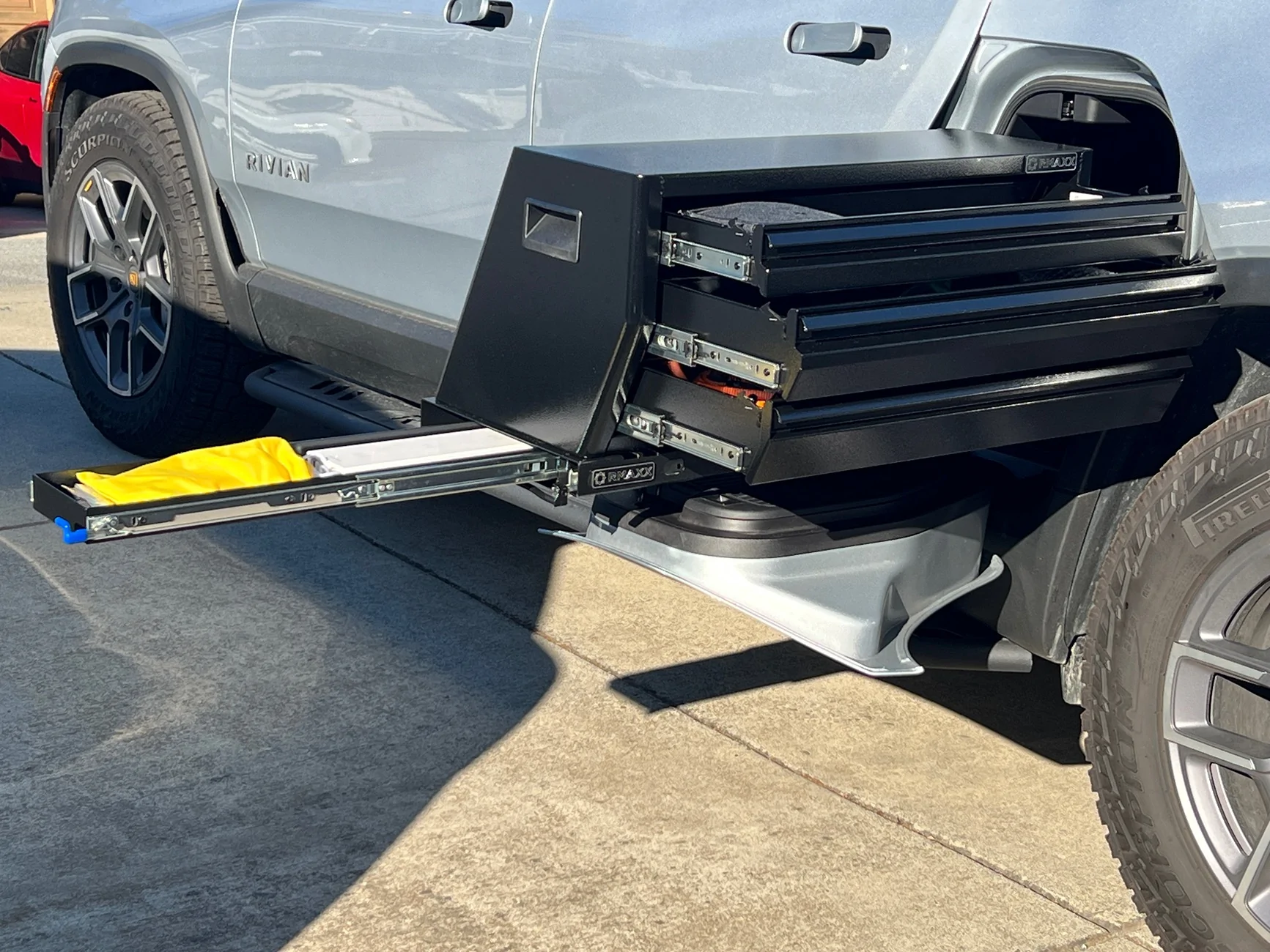

Anyone know what, if any, the differences are in Gear Tunnel opening sizes in Gen 1 vs Gen 2.
Looks like volume is slightly different with Gen 2 being a little smaller. Anyone know why?
I ordered a Boxgods gear tunnel slide that is finally approaching delivery but I ordered when I had a Gen 1. I now have a Gen 2 and don’t know if it’ll fit.

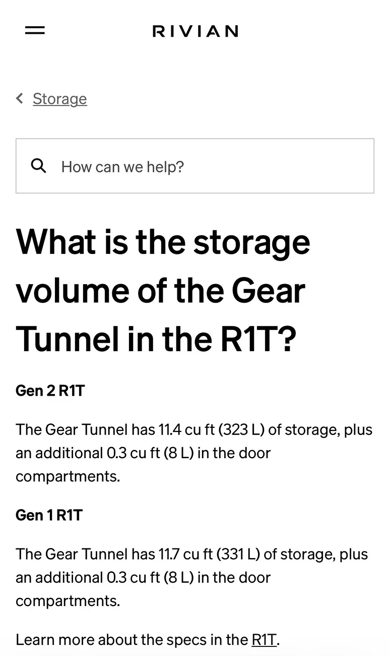

Ah, that makes sense. I wish Rivian would publish the Gen 2 opening size like this
Rivian R1T R1S Gen 1 vs Gen 2 R1T Gear Tunnel Differences IMG_0484

The new tonneau cover doesn’t impact the gear tunnel…I just had a power tonneau installed. For reference, I also have the RMAXX gear tunnel dual slides installed in my 2025 and they were in place when my PTC was installed
Rivian R1T R1S Gen 1 vs Gen 2 R1T Gear Tunnel Differences IMG_2281

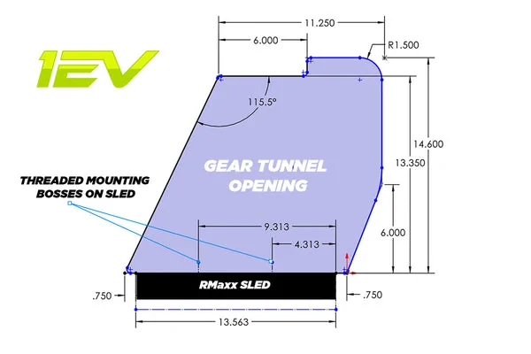

Here's a drawing that was posted some time ago:
Rivian R1T R1S Gen 1 vs Gen 2 R1T Gear Tunnel Differences gear-tunnel-dimensions

Also, based on the specs in the OP's screenshot I wouldn't expect it to be very noticeable. 11.7 vs 11.4 is a pretty negligible difference. It would only be apparent if you had something that was a perfect fit in one and then just barely didn't fit into the other.
