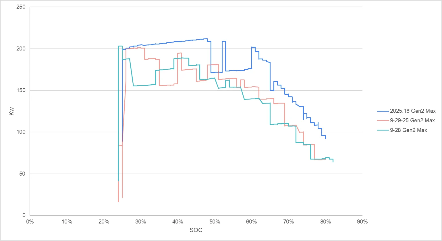

More context on the reddit post I suggested searching for, but here is the curve from that post.
Ignore the two dips the charging station was split down to 175kw twice briefly.
Wow! That is a lot better than before. After seeing this graph, I wonder why people think the improvement isn't significant.
140kW at 70% and 100kW at 80%? That's awesome, actually. And look how long it keeps the charging speed above 200kW.
This is a really, really good charging curve now. I see why Kyle is so happy about it.
The charging curve doesn't tell the charging story completely. It's the time to add X amount of energy that is important. A change to the charging curve that looks "big" doesn't necessarily translate into a big reducing in charging time. I'm only seeing a minute or two of improvement over a 20 to 30 minute charging session. And that is during sessions that have charging curves that hold power over 200 kw for a long time like this one of mine.

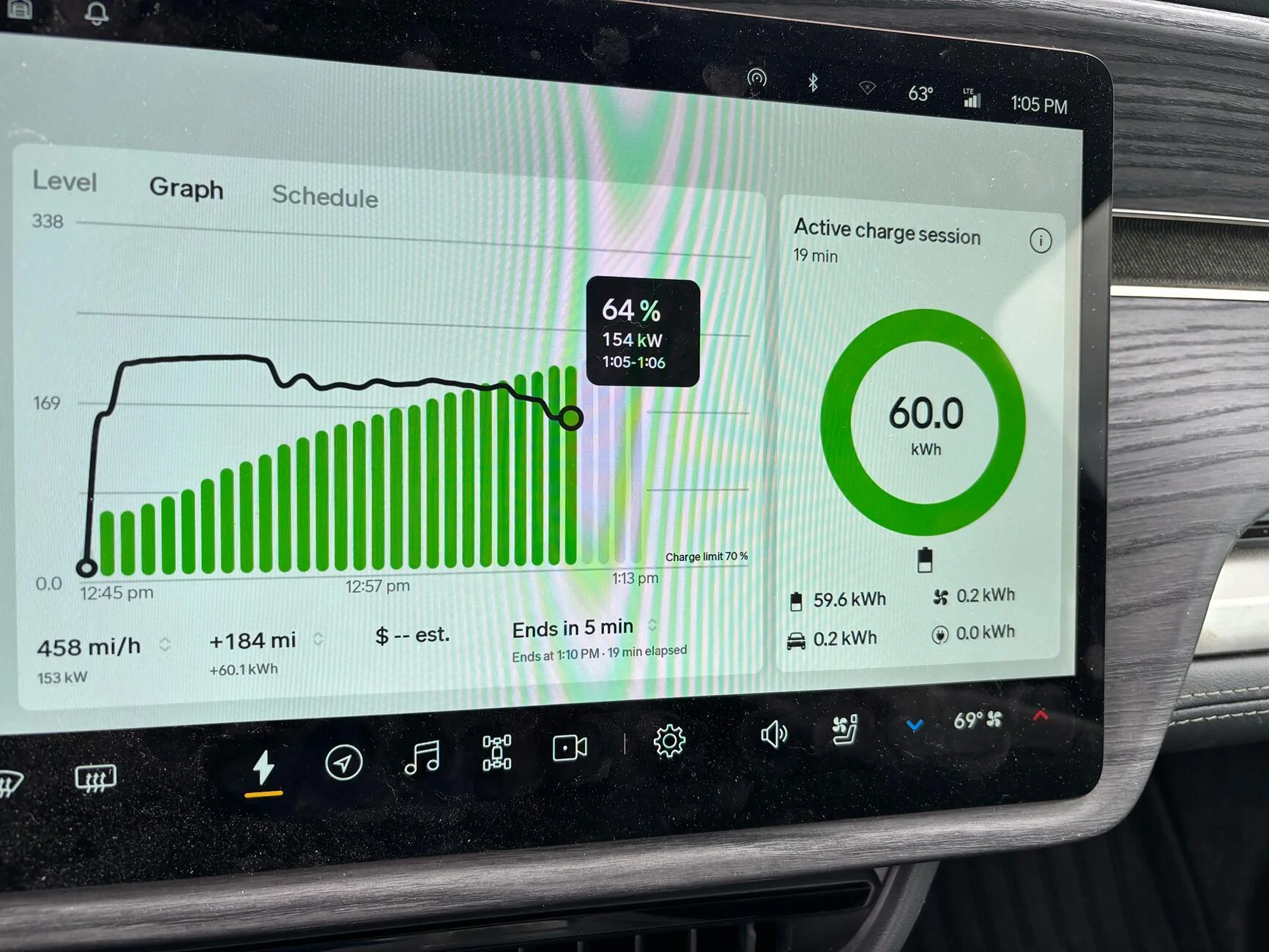

Rivian R1T R1S Gen 2 Max Pack Fast Charging Speed with 2025.18.01 Update tempImageJLQZfN

Anecdotally, My Gen 1 Large charge appears to mirror the Gen 2 Large increase. Starts at 215kW until mid 40’s and the slowly ramps down (as cooling fans kick on) and will hold at least 140-150 through 70%. That was on a Tesla SC this morning and is seat-of-the pants quicker than pre 18.01.

As reported in an earlier post, my Gen 1 Large charge profile is very close to this graph even though the documentation refers to Gen 2 only.
It really depends on how deep you are charging. A typical charge session like you have above? A minute or two.
If you need to charge to 80% or above, the time saved can be significant. At some portions of the curve the power is a good 50% higher.
Can you grab the data next time? When I checked my Gen1 large pack, I saw no difference above 50%>
