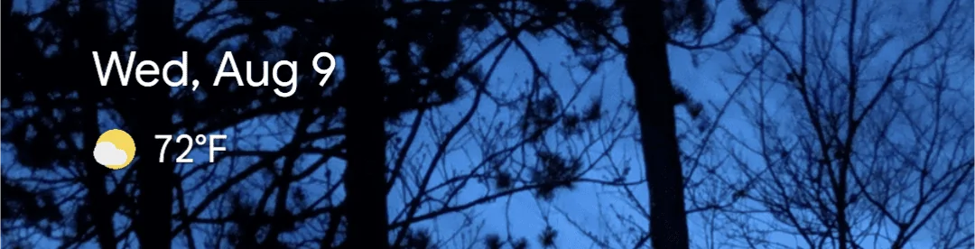

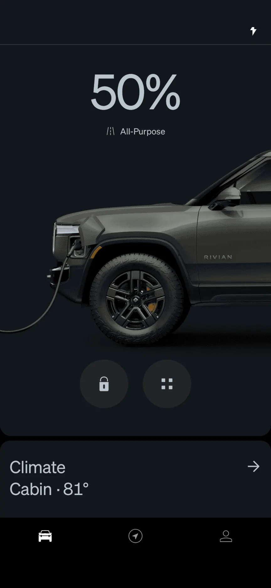

I've been charging for about 14 hours now, using the 120v adapter.
Rivian R1T R1S Generating cabin heat while parked Screenshot_20230809-101237
Rivian R1T R1S Generating cabin heat while parked Screenshot_20230809-101224
Current temperature shown above. Overnight it was upper 60s.
Maybe it has to do with L1 vs L2 charging?
