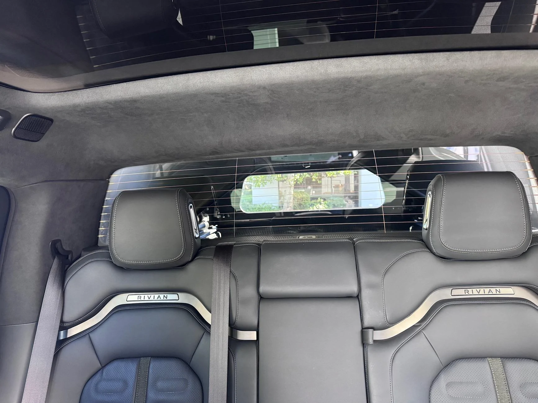

How's the visibility through the rearview mirror? (Bonus for photos)
Have you figured out how to close the tailgate from inside the camper yet? ?
Visibility is good. It's hard to take a picture of the mirror but you get the idea.

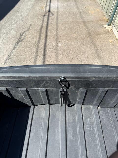

The tailgate is surprisingly light. What's annoying is the length. I'm able to close it just fine sitting inside. I did practice this before install lol.
