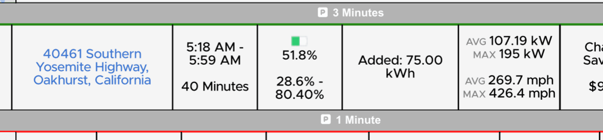

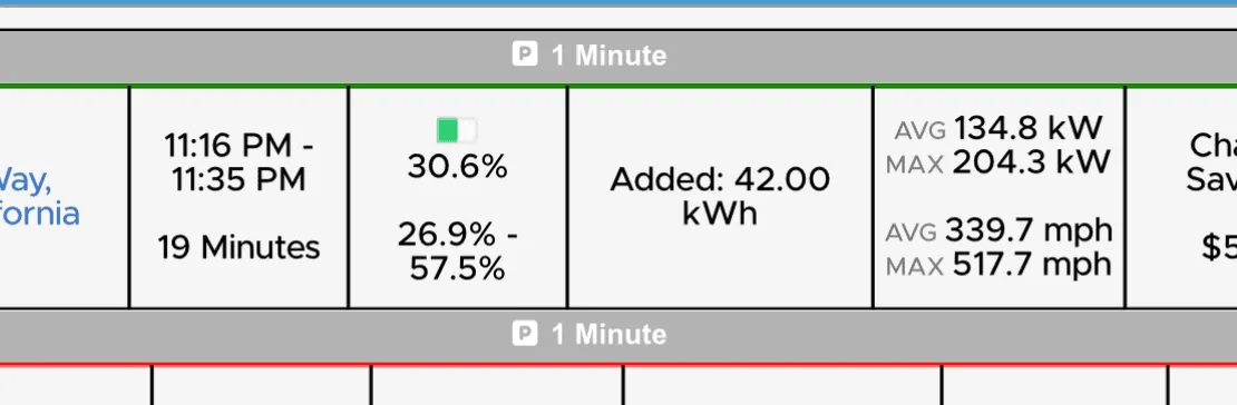

I with third party adapters I’ve never been able to get more than 85 kW to my Rivian from Tesla superchargers (this happened to me today, in fact). Has anyone done better with the real deal adapter? It would be a shame if that’s as fast as one could get.
Yup. I've gotten full speeds with my A2Z adaptor.

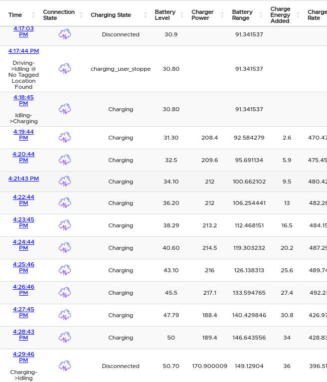

Here is the data from my most recent charge using an A2Z adapter at a Tesla Supercharger. I peaked at 217 kW

I have the Lectron, and it has issues(hard to get back off Tesla cable is the major one) but I’ve had it charge near the maximum
of 215. What state of charge are you at when you have tried? Around 60% the speed starts its decrease in speed and around 70% it’s always been under 100.
