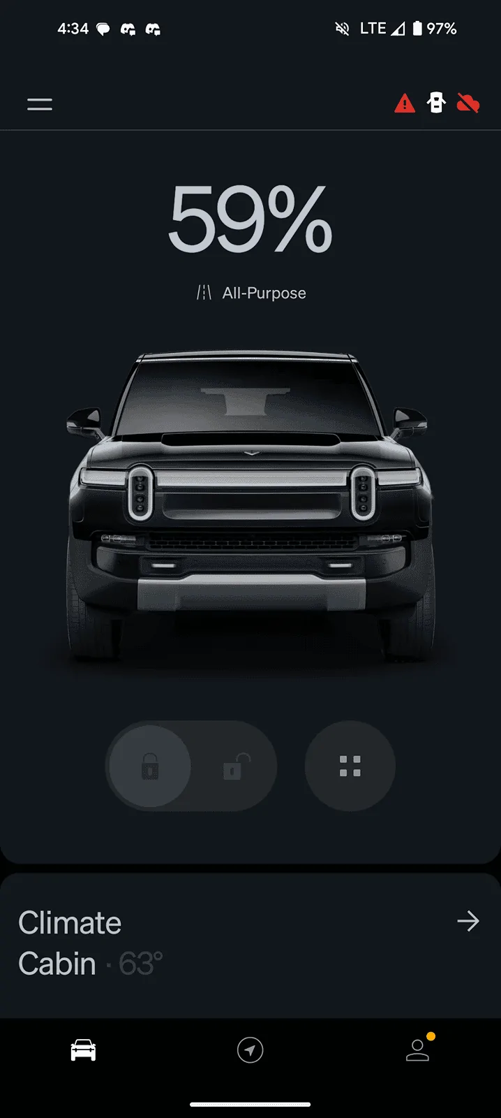

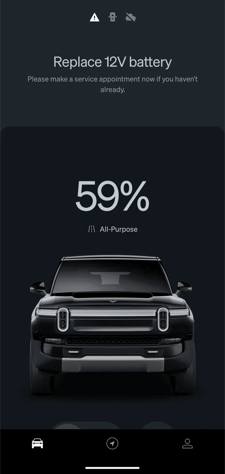

i bet the car works fine. Same thing happened to my wifes R1s last week. Got the warning, she drove it just fine. Service said measured voltage was fine, just set off the replacement warning. I pulled up the RIDE menu and it was 13.4 volts. They just replaced the battery this past monday.

This doesn't always mean it can't be driven. As long as the battery doesn't have an internal short, it should be fine.
I would agree, just the fact it is still communicating with the app indicates it is not dead.

I would be shocked if it doesn't drive, unless it sits for another week unattended. Typically, it's a warning prior to complete failure of the batter(ies)
That was not the case for my dead 12V. It was essentially bricked even though trying to jump it at least opened the driver's side door handles but otherwise it was a brick. Couldn't even open the frunk nor tailgate. Since I ALWAYS drive it in lowest sport mode/lowest drive height, the tow truck operator couldn't get under it to release the rear brakes w/ the electronic tool, so he had to hammer some hard-plastic skates under the rear tires to get it on the flatbed.
