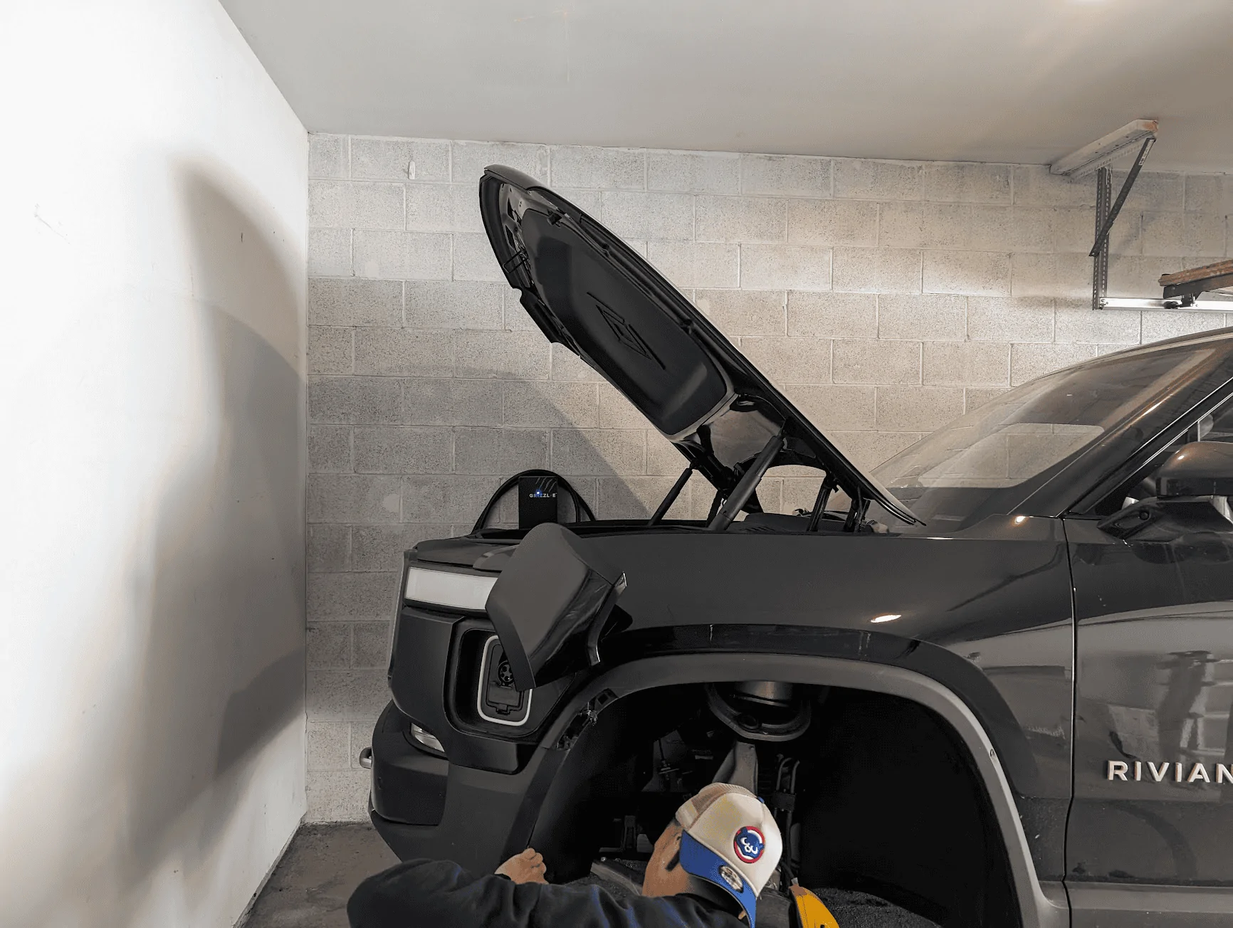

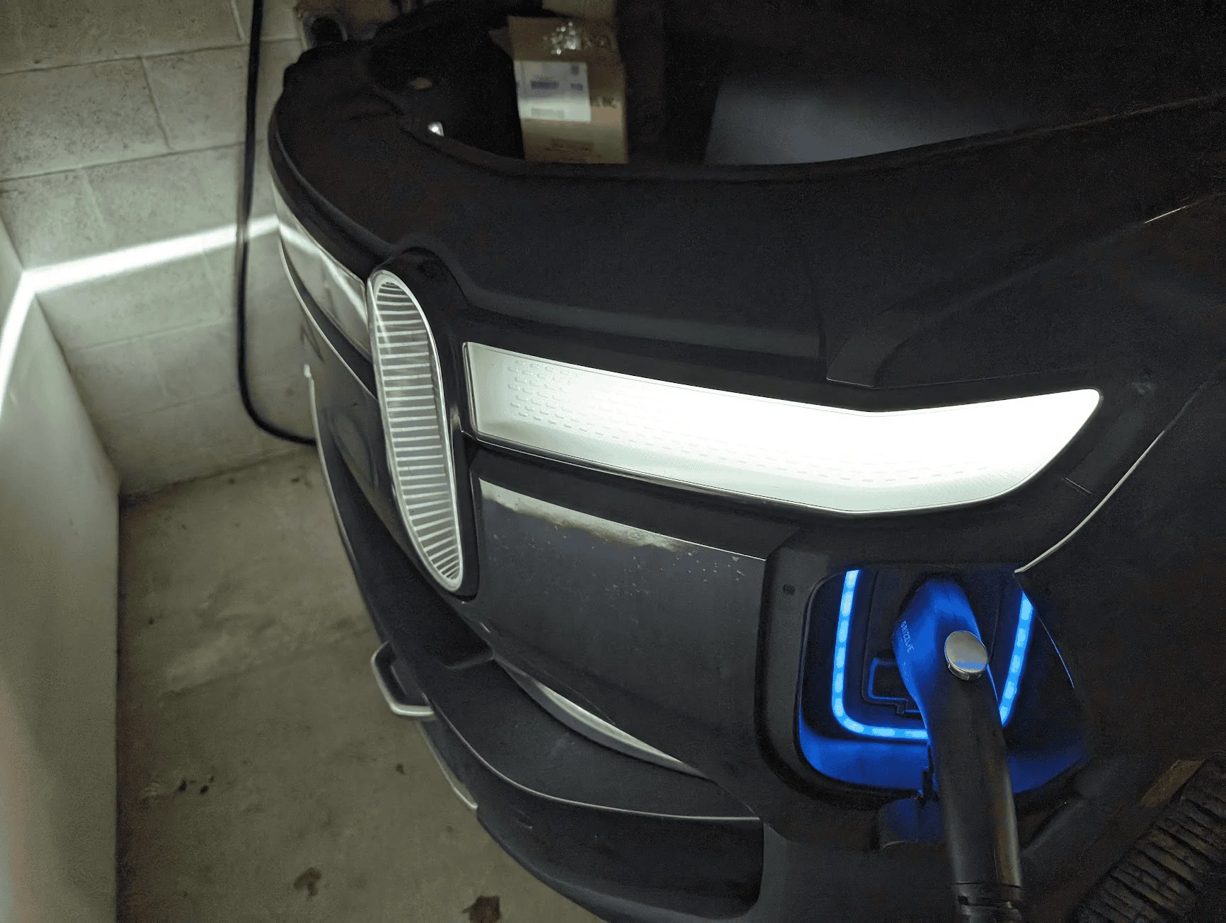

Remote service came out today at ~2pm. We tried jumping from the rear to get the frunk open - nothing. Clearly the battery is very, very, dead.

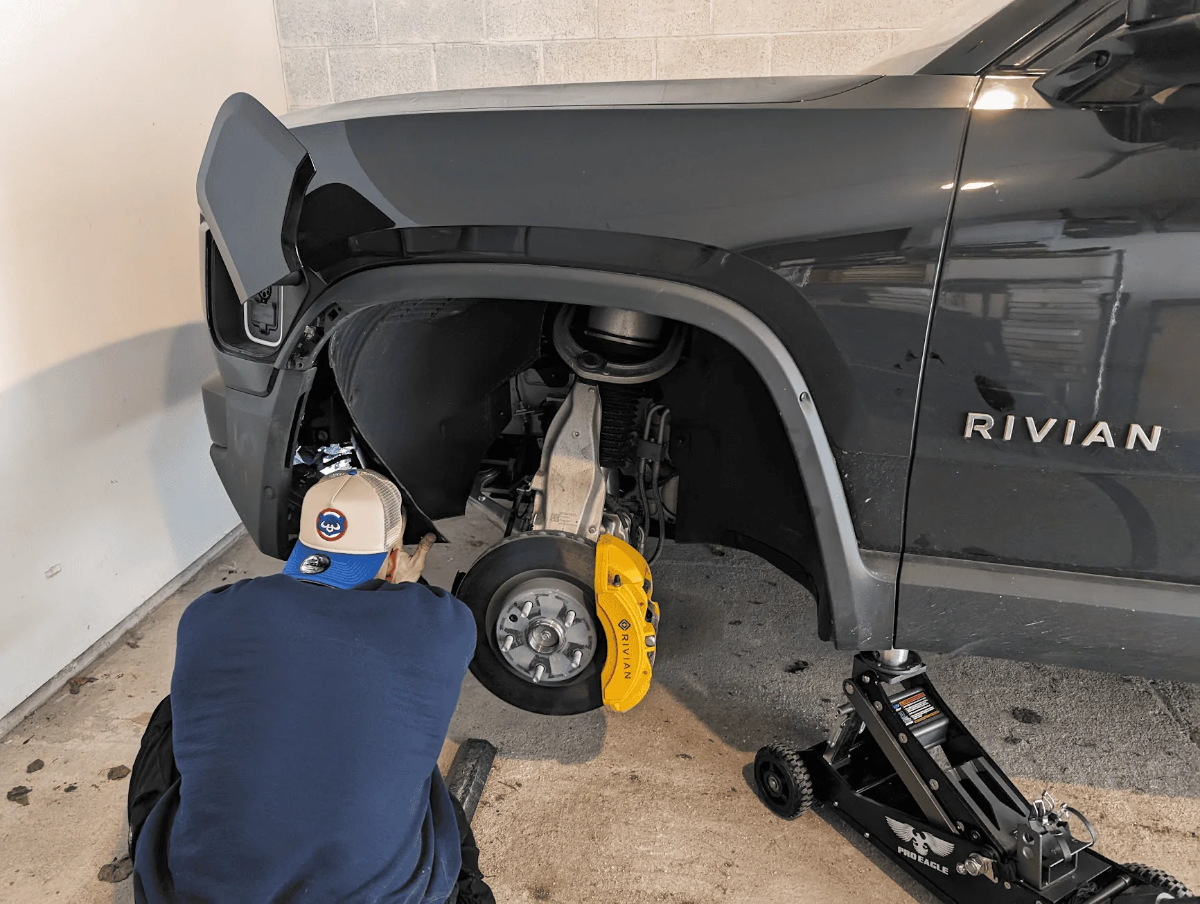

Try to get access to the emergency frunk release, but because of low ride height and wheels being pretty much straight it was pretty much impossible to reach release cable.
Jack it up and take the wheel off. Success, frunk is now open.

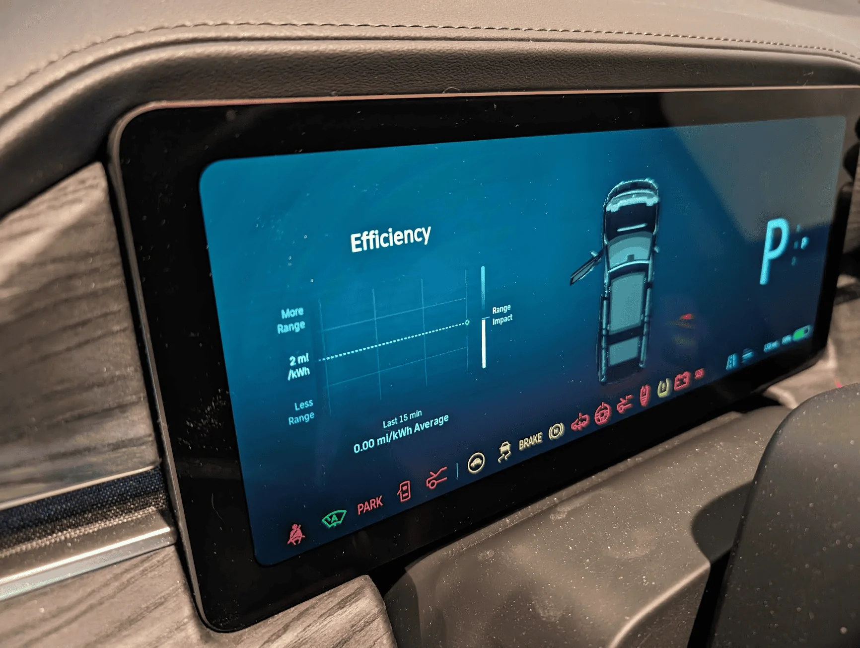

New 12v battery is rapidly dying - 11.6V
CTRL+ALT+DELETE the R1S... watch windows loading screen...
Seems better, but once entering RIDE and plugging in laptop - it's still bonked. Vehicle is just "off" - not responding as expected, pressing brake pedal and trying to shift into gear says "please press the brake pedal" - and so on.
New 12v battery is rapidly dying - 11.2V
Connect wall outlet battery charger I have to 12v battery - it can't charge it fast enough. Nothing happens.
Connect Rivian service jumper kit battery to 12v battery - it doesn't help.
New 12v battery is rapidly dying - 10.9V
Try a few other things...
New 12v battery is rapidly dying - 9.8V

Wanted to get a pic of literally EVERY warning possible being active :D

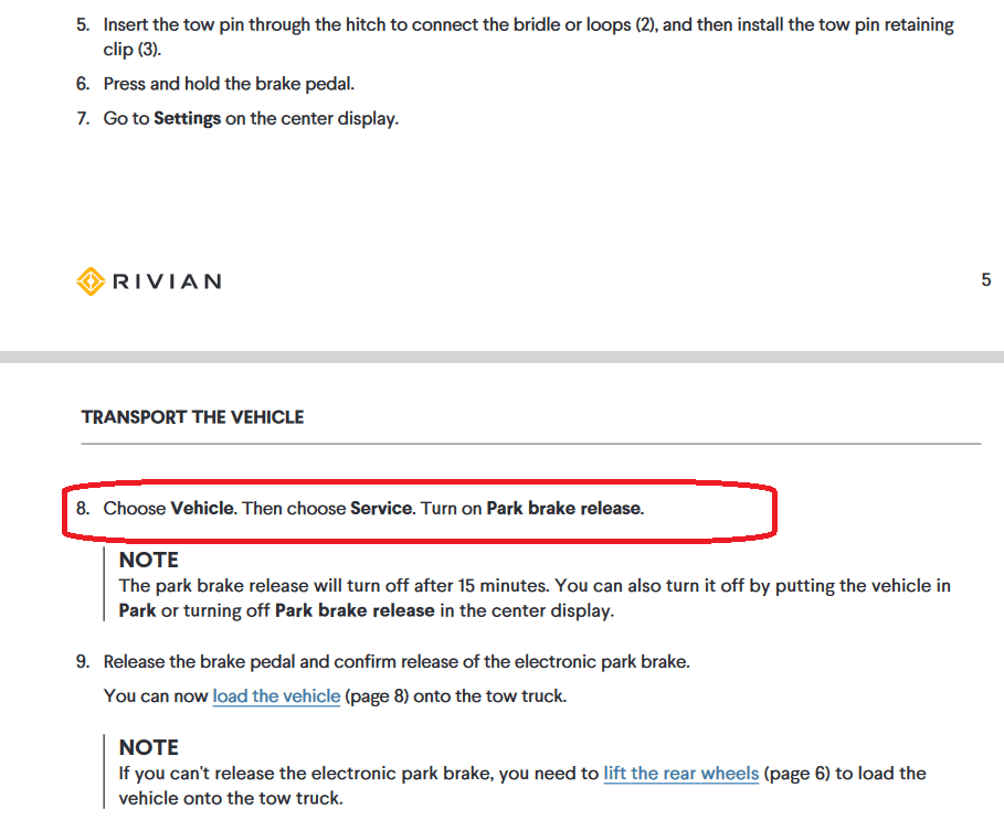

UPDATE 2:
..One thing I asked - isn't there SOME way to manually release the parking pawl? Like, you know... for an emergency? Then we could possibly just roll it back a bit and chock the wheels? Service person seemed to think, no. And no way to "jump" it long enough to get it into Neutral or any other options. But I swear I saw something about releasing the pawl somewhere.
You might be recalling the procedure below.. but that can only be performed with the vehicle running.
The tech did mention releasing the parking brake today but we held off because the lead tech is supposed to head over. But yeah this might be what I was thinking of. Seems like a true manual override would still be quite handy.
