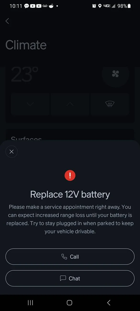

How's this for timing... Dropped my truck off yesterday for 36,000km service checkup (currently at 43k). Got this today.
Rivian R1T R1S Guess it was my time - 12v is dead Screenshot_20241114_101138_Rivian
Thankfully it's still there! So messaged them and they added it to the work order.
Dodged that bullet!
