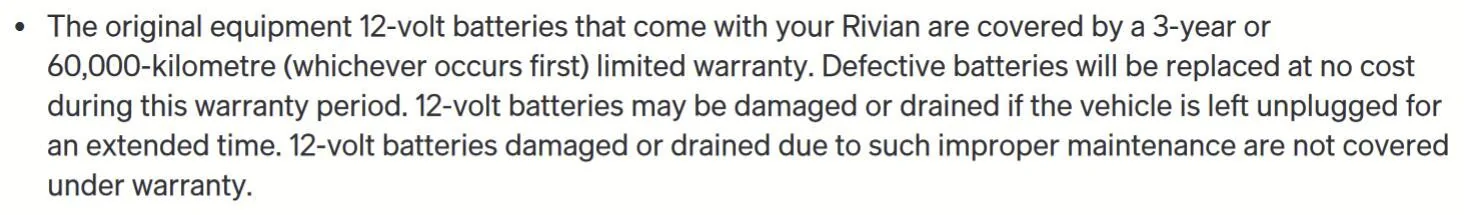

Let us know if they replaced it for free. The actual warranty should be up to 36K miles, hence my question.
I'm currently at 41,000 kms. warranty is good for 3 years or 60,000kms in Canada
crap! Kilometers! missed that detail :)
You guys get ~3000km of extra warranty compared to the USA 36.000 miles ;-)
