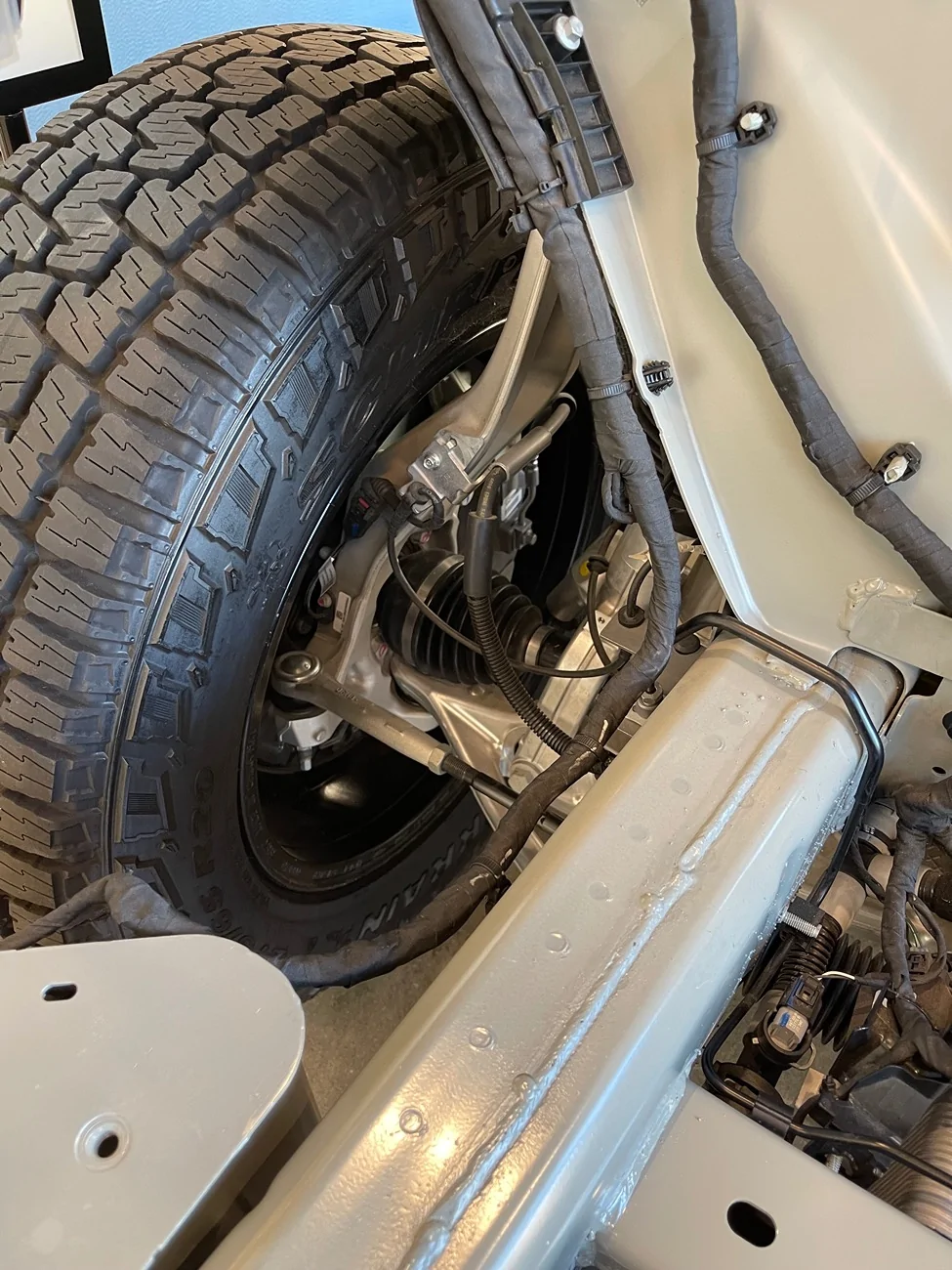

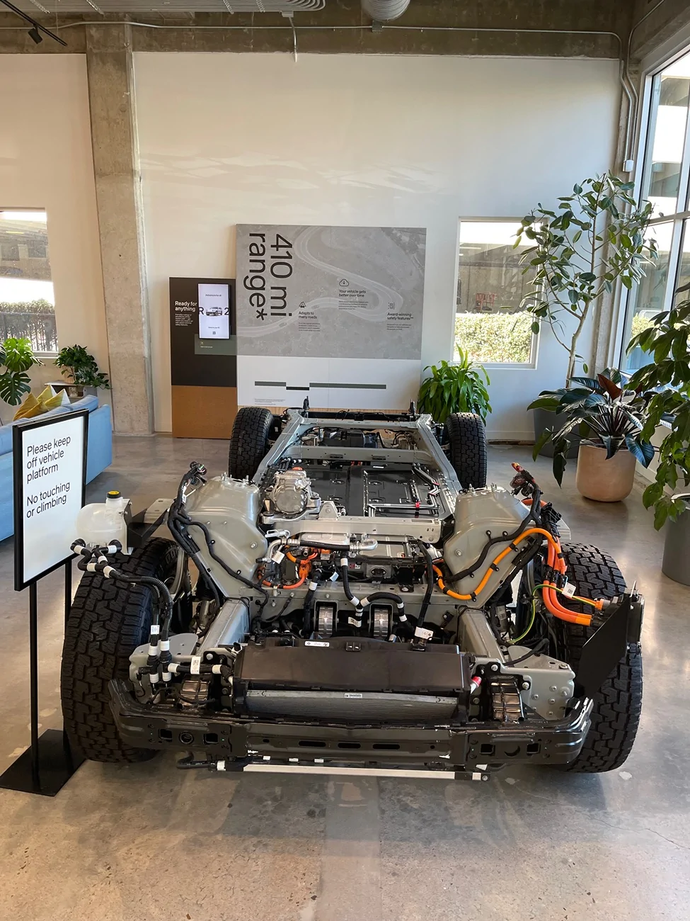

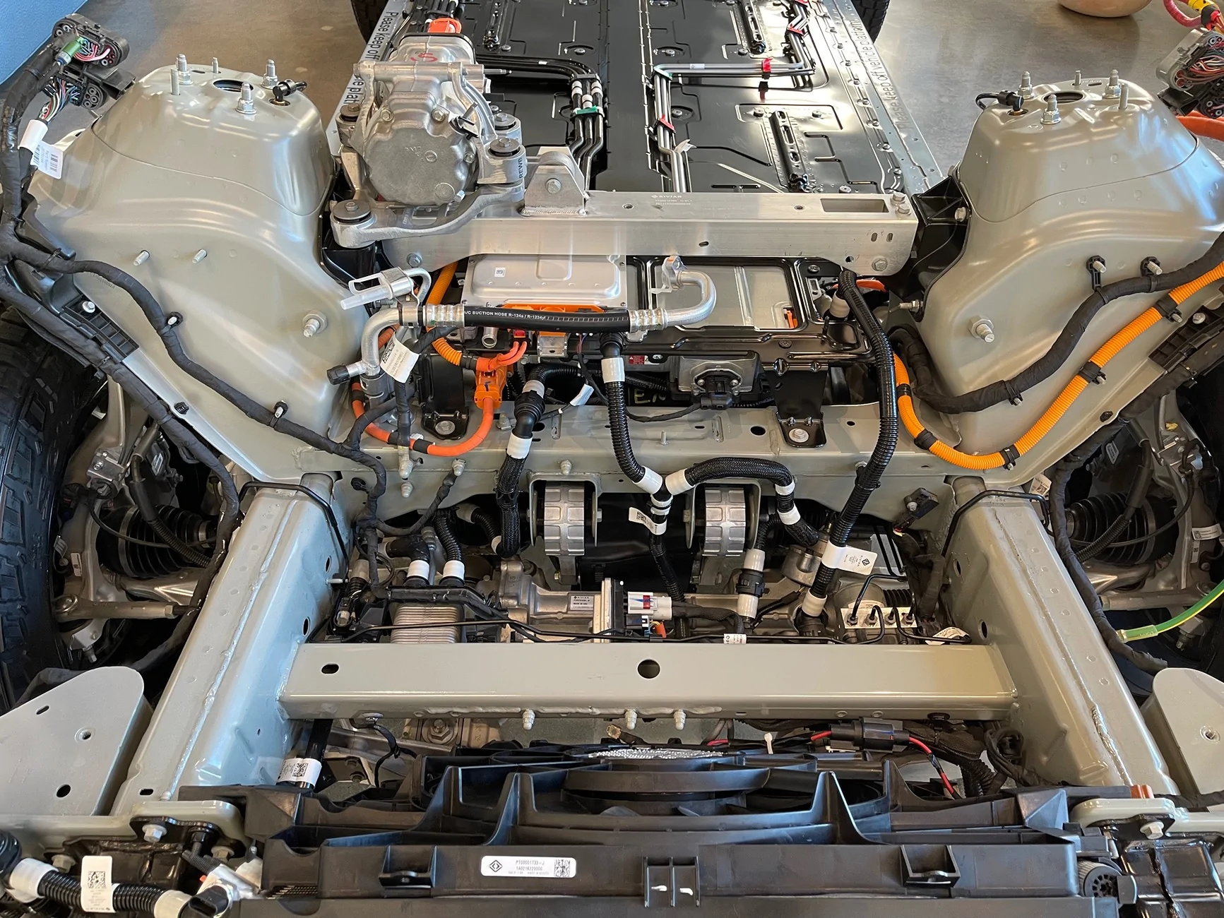

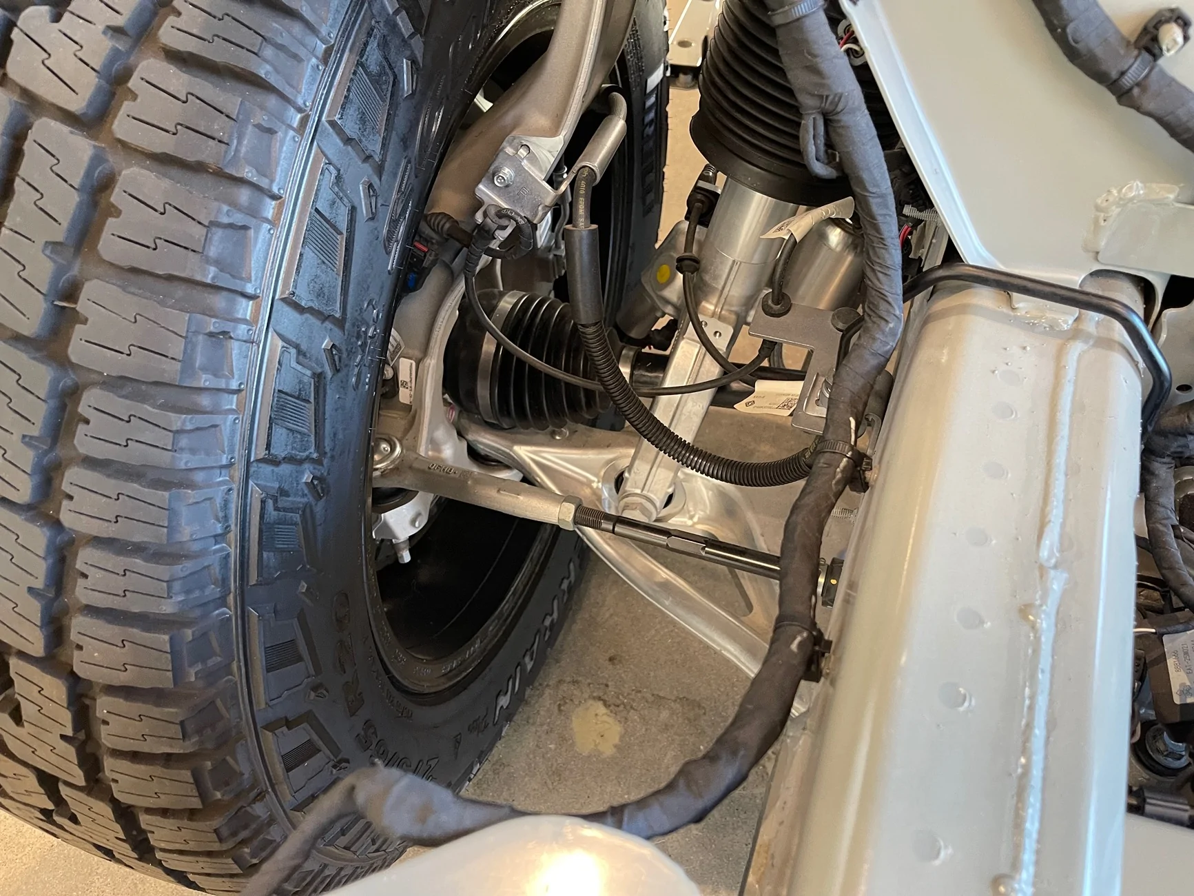

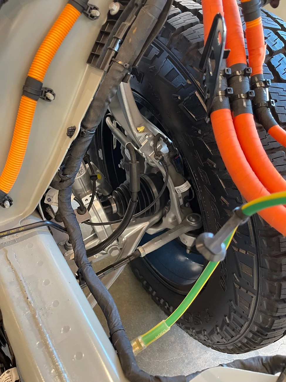

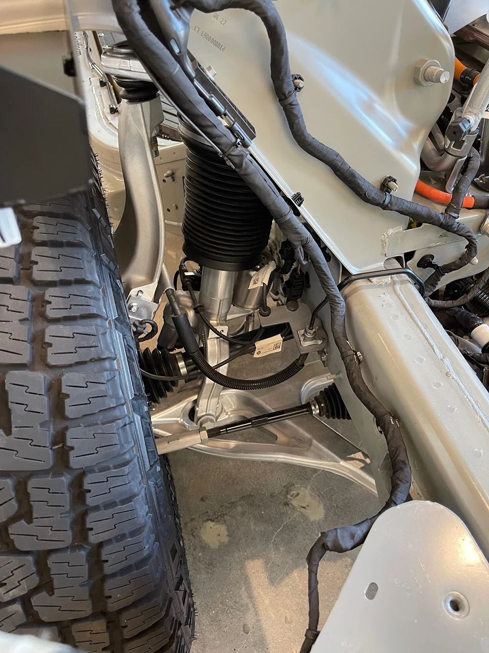

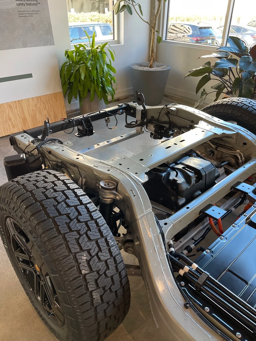

Here is some pictures of the powertrain.
Rivian R1T R1S Half-Shaft issue thread IMG_9615
Rivian R1T R1S Half-Shaft issue thread IMG_9614
Rivian R1T R1S Half-Shaft issue thread IMG_9616
Rivian R1T R1S Half-Shaft issue thread IMG_9613
Rivian R1T R1S Half-Shaft issue thread IMG_9612
Rivian R1T R1S Half-Shaft issue thread IMG_9611
Rivian R1T R1S Half-Shaft issue thread IMG_9609
