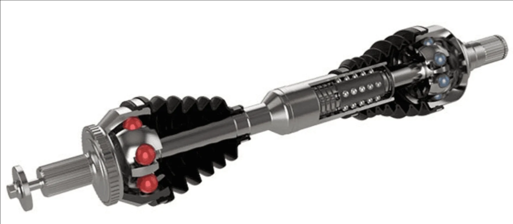

Has Toyota ever used half-shafts that have ball bearing splines that slide in a housing?

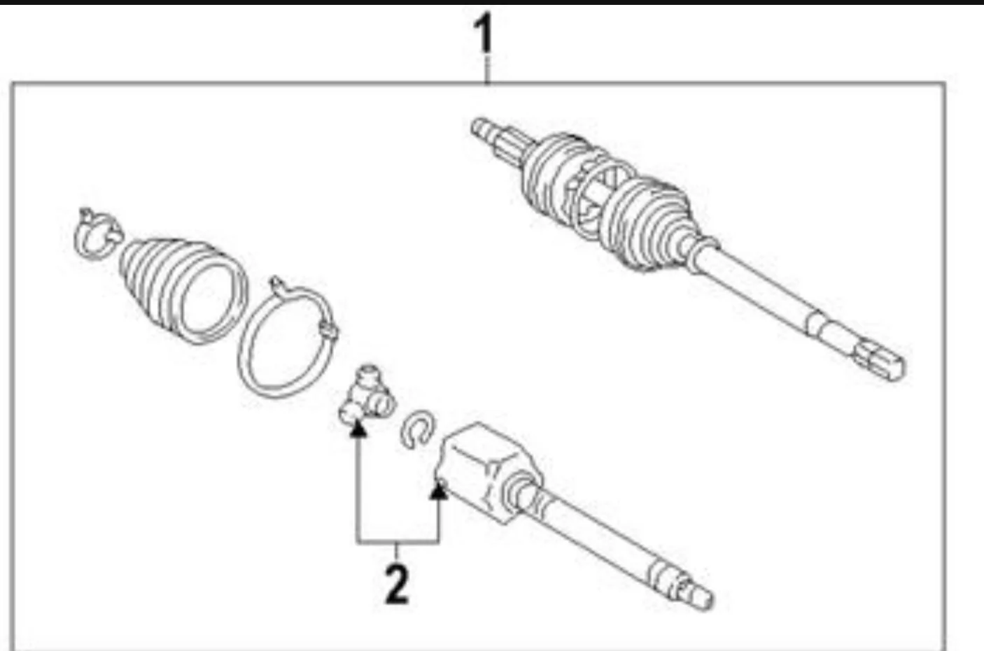

Toyota uses a tulip joint (2) on the inner That's what Toyota uses to manage the length.
Rivian R1T R1S Half-Shaft issue thread 1000038096
Rivian uses double CV and that interesting mess of ball bearings but the noise appears to be at the outer CV and spindle where the abs sensor is. Both appear to use a circlip to retain them in the differential.

Maybe the little balls are binding and hammering the spindle.
Does the Toyota half-shaft have multiple inches of extended articulation? The half-shaft on a vehicle with 7 inches of adjustable height needs a half-shaft that can have variable lengths on the fly.
Something will get figured out. I'm surprised another supplier hasn't come through yet. To my knowledge they have never changed part numbers on this.
I think the fix is a design with a grease fitting that allows for regular regreasing. I think the grease thins and the spline gets worn out.
