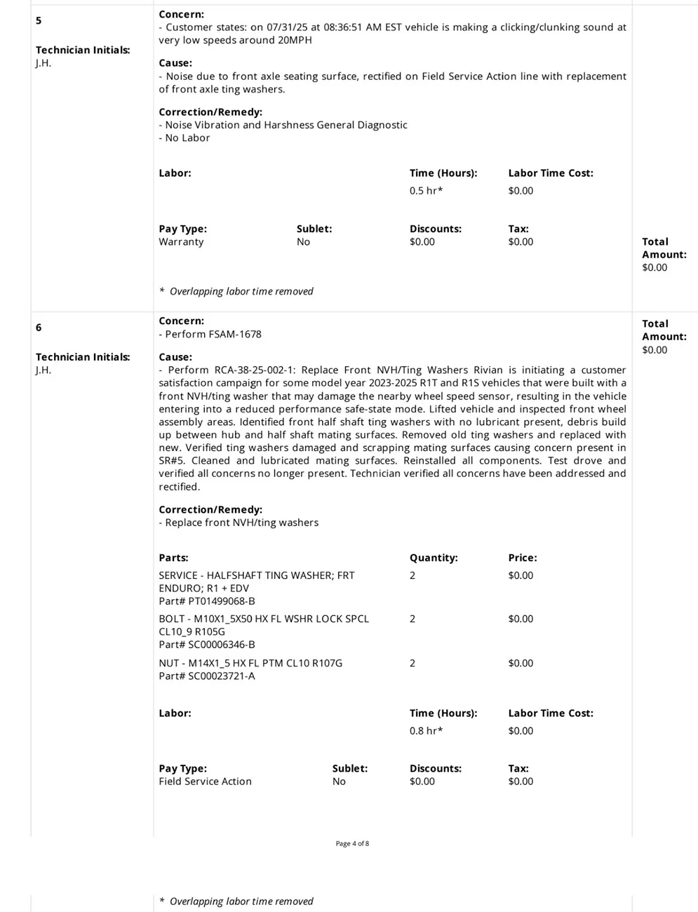

Just got mine back from the new Sterling, VA service center. I had my half shafts replaced a year ago. This time just ting washers per the current customer satisfaction campaign.
Rivian R1T R1S Half-Shaft issue thread 1000010075
