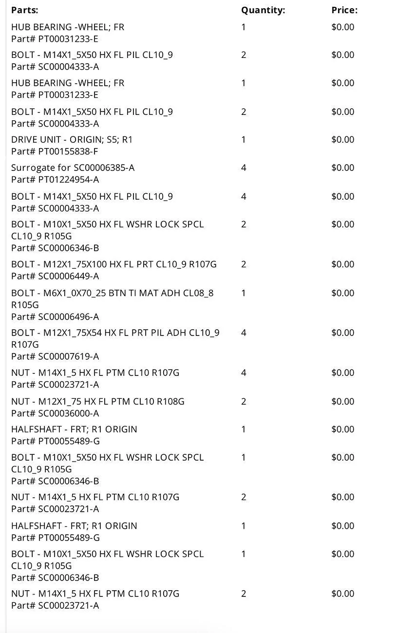

This is what they replaced on mine and fixed the problem (for now, 1 month running with it):
Rivian R1T R1S Half-Shaft issue thread 1744741913888-l

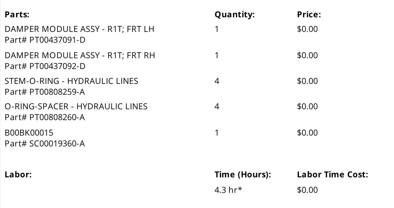

As a side note, Rivian really has a serious problem with half shafts and dampers. Both of these parts are constantly being replaced, and as dampers, the price is astronomical (5k for front).
Mine were just replaced with V2 of dampers, I hope they will not leak (I do not off-road and roads are perfect where I live):
Rivian R1T R1S Half-Shaft issue thread 1744742471211-11
