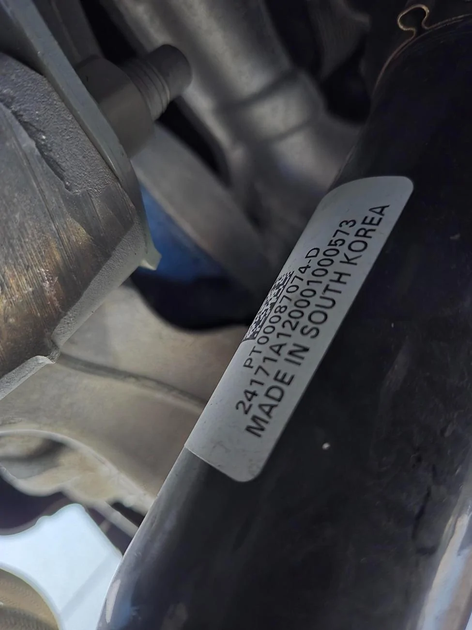

So PT00087074-D is not the current half shaft?
I'm seeing a different part number on recent service order sheets.
PT00055489-G is the new part #?
Does the R1T and R1S have different part #s?
Quad versus dual?
Quad versus dual?
It makes sense that they have different part numbers based on if you have 2 drive units or 1 in the front. Just a guess.

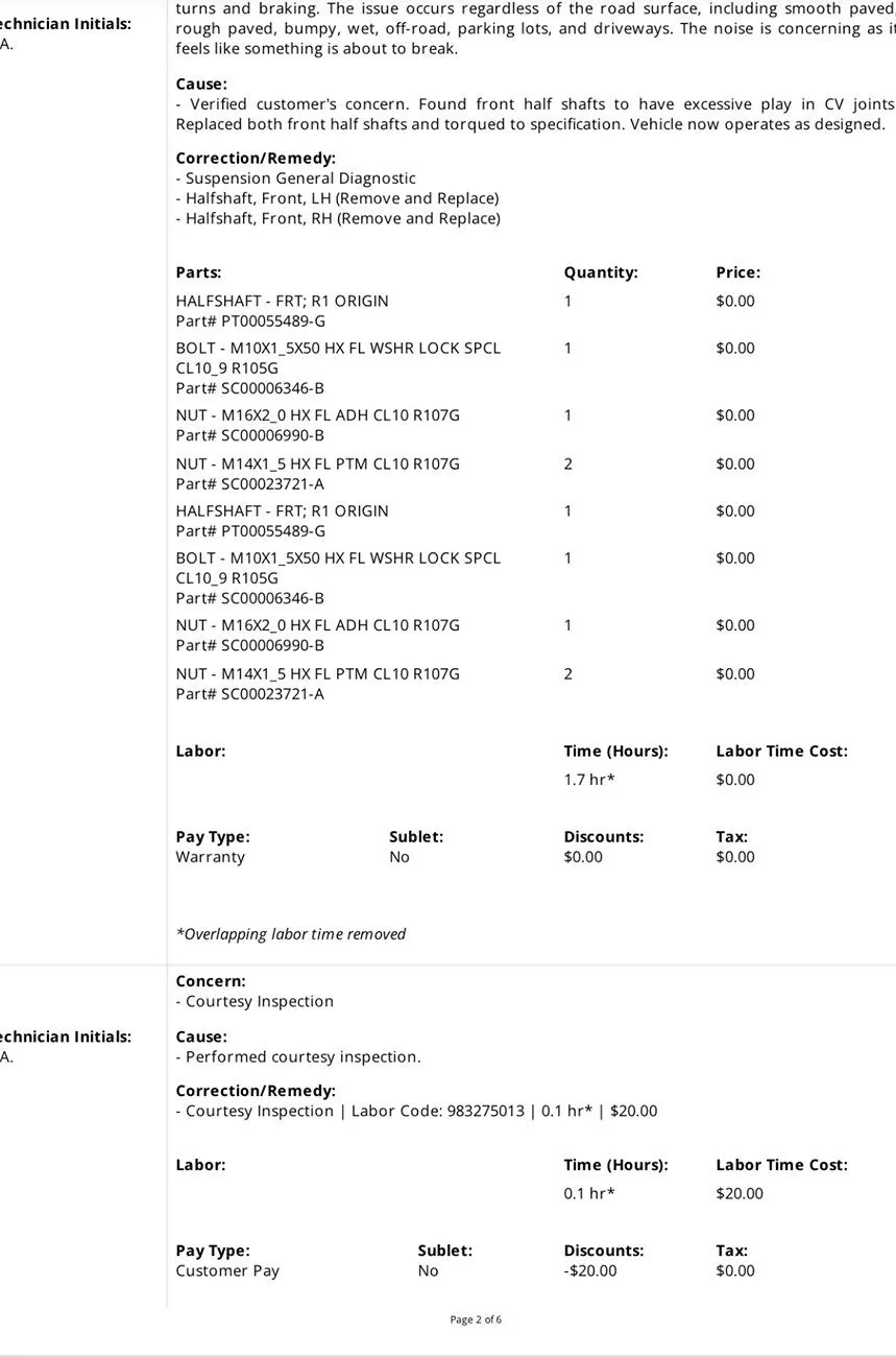

I should have just asked others who have a dual motor R1T. What half-shafts PT# have they seen on recent work orders.
shap
Nov 18, 2021
870
765
Austin,TX
BMW 45e, R1T
Quad versus dual?
Mine was just replaced (R1T Qm 23):
HALFSHAFT - FRT; R1 ORIGIN
Part# PT00055489-G

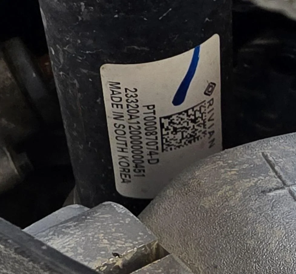

This is my front right halfshaft on my 2025 R1T TriMax.
Does this mean there might be an updated part!?!?!!

This is my service invoice with half shaft part # ending in G
Rivian R1T R1S Half-Shaft issue thread IMG_1283
