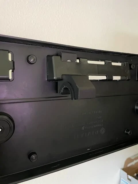

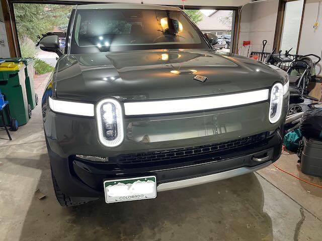

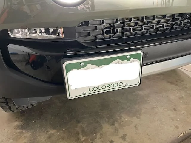

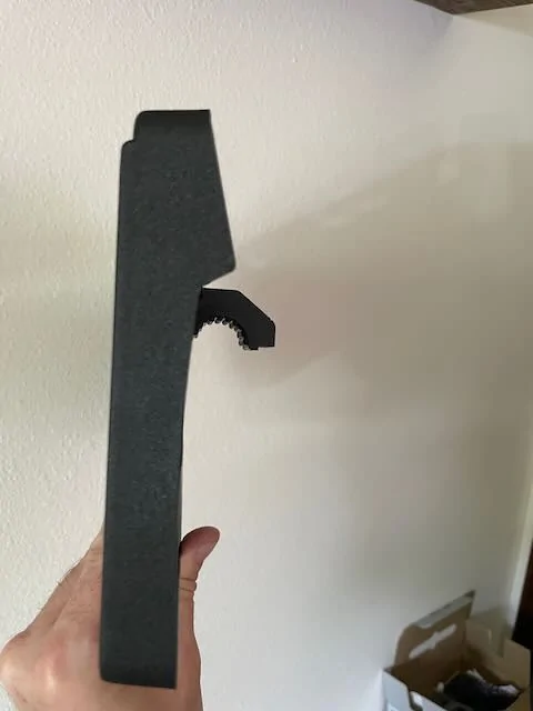

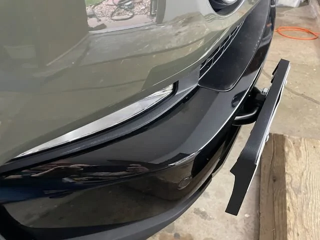

@godfodder0901 taking inspiration from you I'm using those same mounts, but along with the Rivian provided mounting plate. Turn it up side down and it slots right onto the mount. Works really well. I put a bolt through to be extra secure, but you could use it as a clip-on without.
That looks great! Is that little bracket 3D printed?
nope, it’s one of the brackets that @godfodder0901 originally found on Amazon:Motorcycle Mounting Bracket 2Pcs 0.75" 1" 1.25" Horizontal Bull Bar Mounting Bracket Driving Fog Lights Work Auxiliary Lights Universal Clamp Bracket Fit for Car Motorcycle Crash Bar Guard https://a.co/d/0KmJZMB
Have you noticed any sensor interference?

I have just over 5K miles and haven't noticed any issues so far.

Can confirm here too - zero interference :)
