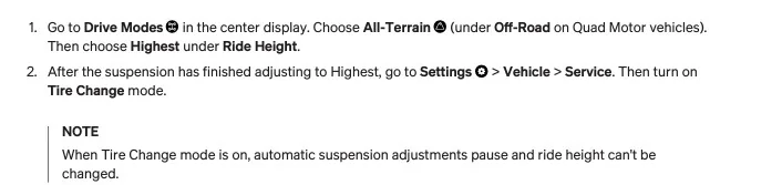

Something is amiss here. Let's see if we can figure out why.

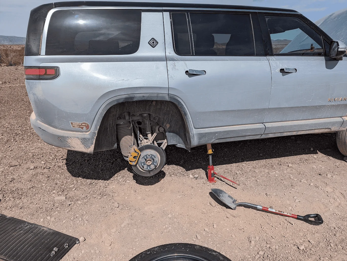

We can lift the front tires almost 2" off the ground
Yes please. Car in tire change mode and highest.

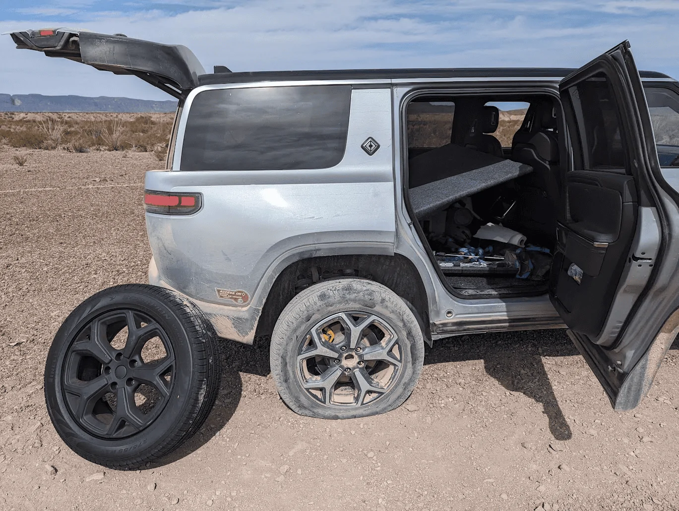

I think that my problem is that when I test drive it in the drive way, the tire is full, and the car is higher than with a flat. With a flat, the car drops about 5" of tire wall (on 21").
Basically, in your case, you can lift 2" above ground, but if you have to start with the jack point 5" lower due to flat, and lift the same amount, you are still 3" short of air and to put a new wheel, no?

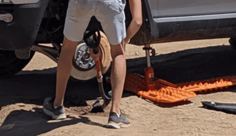

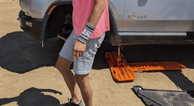

I install the jack all the way compressed, screw extender at minimum, with the long puck on top. I had a traction board to increase the base, too. I don't have better pictures of the exact setup, but it basically barely fit in. Then I lift the whole thing to the max, but it's now 5" less than it was in the driveway, starting with a pumped wheel. It's enough to get the flat wheel off.
But we dug to get the spare in.

Both examples are really helpful and makes sense. You might have tried this, but here is what we do. 1. Do what you did, and jack it up as far as it will go. 2. Release jack hydraulic pressure. Vehicle will retain much of the previous jacked height. 3. Compress bottle jack manually. This will allow you to extend the screw extension on the bottle jack quite a bit. 4. Lift again and you should be good to go. If not. 5. Repeat steps 2-4 raising height of screw extender each time.
The problem is because the vehicle is so low initially, you can't use the screw extender on the Big Red, which doesn't allow enough lift height to get a fully inflated spare on the R1. Doing above will resolve it. And thanks for being a customer!!!

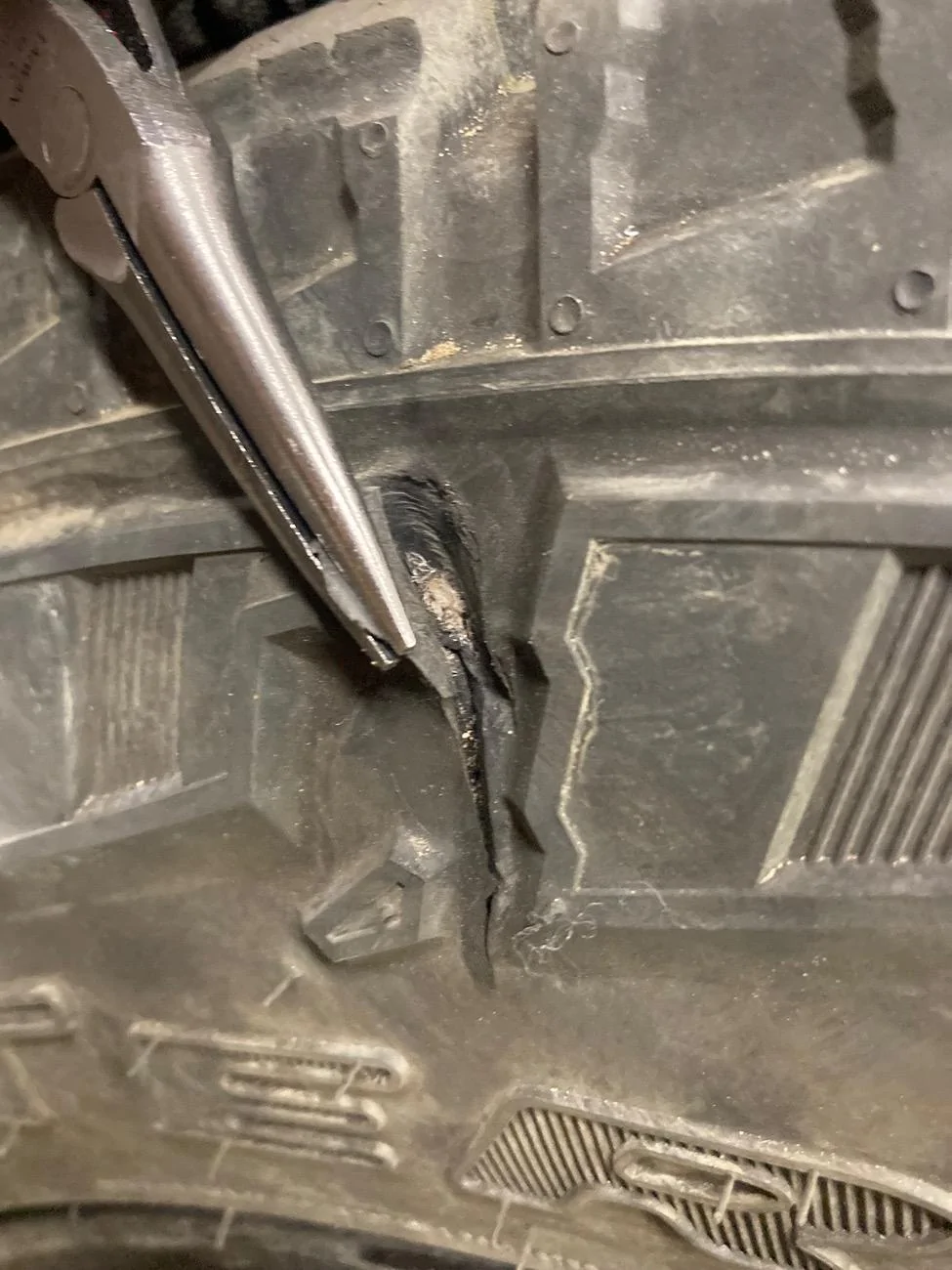

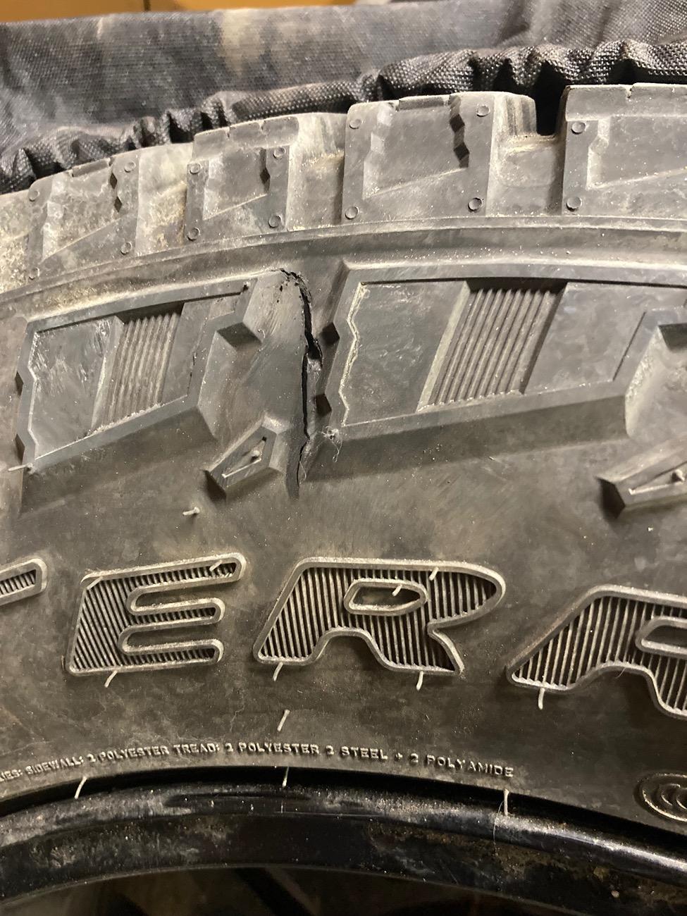

Funny @perrochon and @Mark_AZR1T, this is exactly what I just experienced this weekend, although instead of the extender puck I was jacking directly on my rock sliders against the frame rail.
Running the stock 20" ATs, slashed the sidewall out on a trail. I went into Highest -- probably should have done "Firm" suspension but I didn't think of it -- and by the time I was ready, the tire was completely flat.
Like Mark_AZR1T said, I jacked up, then came back down but the suspension remained a bit higher. I screwed out the bottle jack a bit more and was able to get probably at least another 2 inches of lift that way. (This wasn't actually intentional but then I realized and took advantage of it.)
Then, just like perrochon, after taking the flat off I ended up digging a couple inches of dirt out in order to get the full-size spare on. I was thinking of letting all the air out of the good tire if needed but this was enough.
It would be nice to have a bottle jack with a couple inches more travel, or else jack on the control arm if anyone considers that (I know Rivian doesn't want us to).

Rivian has (recently) changed the ride height suggestion from High to Standard, prior to initiating Tire Change Mode.
I am seeing that Rivian suggests Standard mode before removing the spare tire and kit, but then it says to put it in Off-Road / Highest before you turn on Tire Change Mode.
Yes, that is correct.

Question - Do you think an LT tire would have been slashed too or just the not so great stock 20s?
